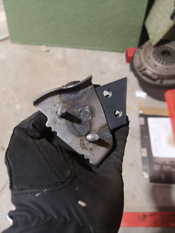

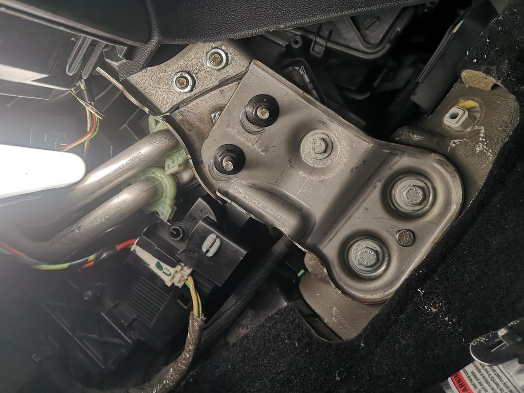

But I'm a lazy guy and I did not bother to remove the center console. I cut the the dash bracket the same way with an pneumatic grinder. Be sure to cover up everything close by - a lot of sparks! Drained the coolant and took the heater core out, easy! But I did not like the way the bracket was fixed afterwards in the video. I welded a 4mm bar to the cut piece and drilled 9mm holes for 2x M8 bolts and one extra hole to the car side bracket.
I even contemplated cutting the heater plastic enclosure from the passenger side but I was not sure it would pull through.

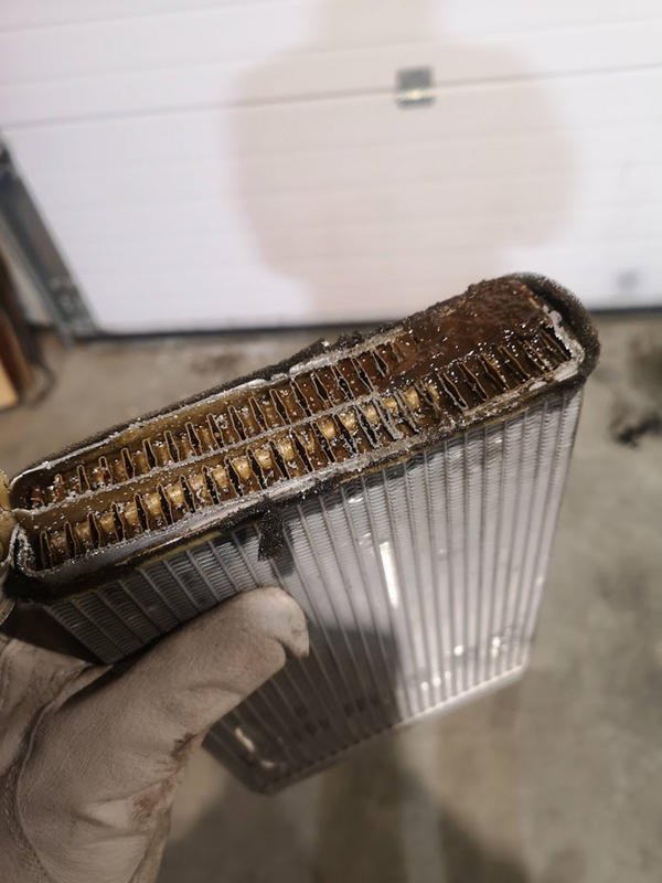

I've now got 63*C coming from the vents and only a 5*C drop across the heater core input and output on full blast. The old heater was clogged really bad. I could hear coolant sloshing around in there but not much came out. I cut one of the heater sides off. I could see some kind of brown gooey residue in the bottom part and scale "rocks" blocking the channels. That's what you get from a half a million kilometer car with no good service history. Could be some kind of a "leak block" or somebody has used tap water in the cooling system.
The new Mahle heater core was only 55€ - happy days!
