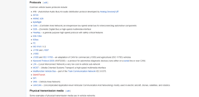

According to Wikipedia's "simple" explanation, several BUS (connecting systems) networks can be present in vehicles.
Yours will have a CAN and a LIN network plus the "simple" wiring harness/fuse boxes which is another "simple" connecting network separate from but working in tandem with the CAN and the LIN.
All three are separate but linked and are all contained together in what you see as a "wiring loom and boxes". Confused? Join the club. That is why you can power up individual components like pumps, relays or lights with power leads but not get the entire system to work. When you are testing you are often working in one network (say wiring harness) but not in the others. Once you understand the need to treat and test the "networks" separately, and in stages, along with the components they serve then you are on your way to being able to repair them.
