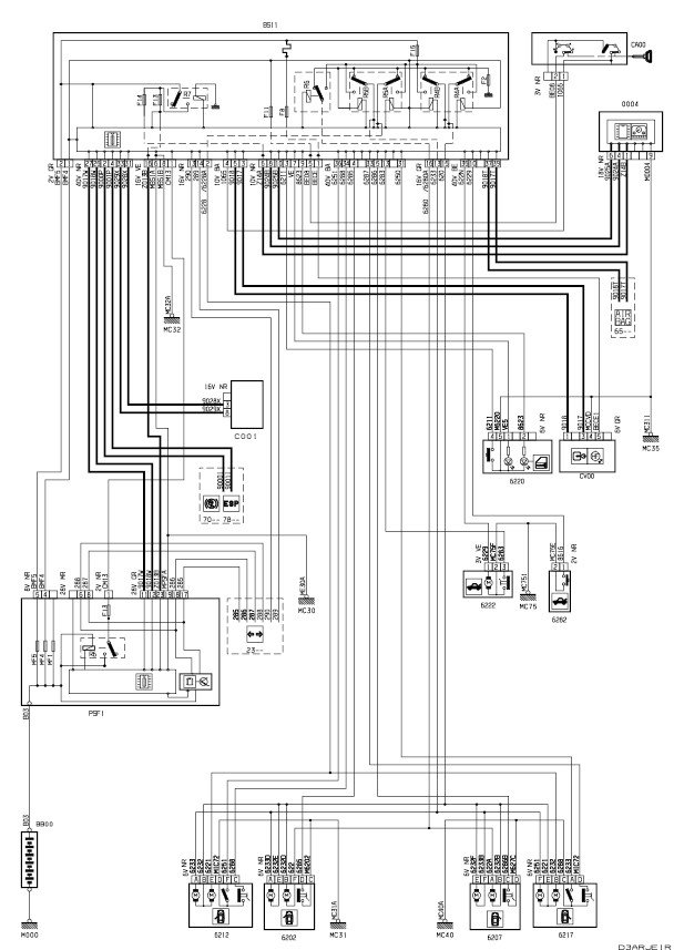

Central locking diagram as requested.

Looking at the circuit diagram from wheeler for the central locking, I'm reading it as follows;ozvtr wrote: 04 Dec 2021, 04:45 If you ask Wheeler very nicely he might be able to provide a diagram for the door locks. We might be able to nut out out how to get the door unlocked now that you have access to the BSI connectors. Disregard what I said before about the connectors for the door locks (previous post) the pin numbers were for the MK1. It's possible the pin outs were changed for the MK2.
* For the passenger/left front door locks, there are 2 servos for the locking (I assume one servo locks and the other unlocks the door)
* The one servo uses Grey connector pins 13 and 15. The second servo uses pins 15 and 16.
* To power Servo 1 without using the BSI, I can run 12v through pin 13 on the grey connector whilst running pin 15 on the grey connector to earth.
* If Servo 1 doesn't open the lock, I can try Servo 2 by running 12v to pin 16 and earthing pin 15.
Does that look correct or am I likely to fry something

Re: Citroen C2 - dead electrics - No power to locks, interior light, ignition - everything dead
One of the motors is the deadlocking motors. The other just changes the polarity to regular lock & unlock. Im typing on a phone just now so no chance of looking at pin numbers etc just now.
Is this for a C2? It appears to have 4 doors? The rear doors on a C3 can be locked independently to the front 2 (not sure that's relevant...but).
I would assume then that the front 2 doors have the same wiring as the C2? Or do you have a C2 diagram?
That one isn't for a C2, so maybe Wheeler got the wrong one - it can happen with multiple requests.
This is the correct one for 'Napping's' C2:
The 2 diagrams are the same in respect to the front doors and their respective pins, but it's good to have the C2 specific diagram - Thanks
One question I have... Where the locking relays on the BSI go to fuse F2 in the engine bay, does F2 connect to earth?
My mistake, I selected a C3 by mistake. They are both almost identical electrically anyway.
BSI, glove box. Yes looks like it. Remember, the relay set up is to reverse the polarity of the solenoids. However F15 is also protecting that circuit. Not sure what that's about. However I bet F2 has a lower value than F15. F15 might be connected to other circuits but F2 is only protecting the door lock circuit.napping wrote: 05 Dec 2021, 22:27 One question I have... Where the locking relays on the BSI go to fuse F2 in the engine bay, does F2 connect to earth?![]()
Looks like R6 runs the deadlock solenoids. R4A and R5B form a polarizing matrix for the door lock solenoids.
You only need to worry about pins 13 and 15. However I cant tell you the polarity. But if one way doesn't work, try the other.
