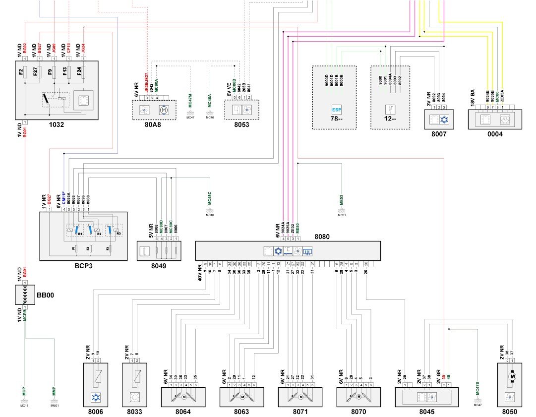

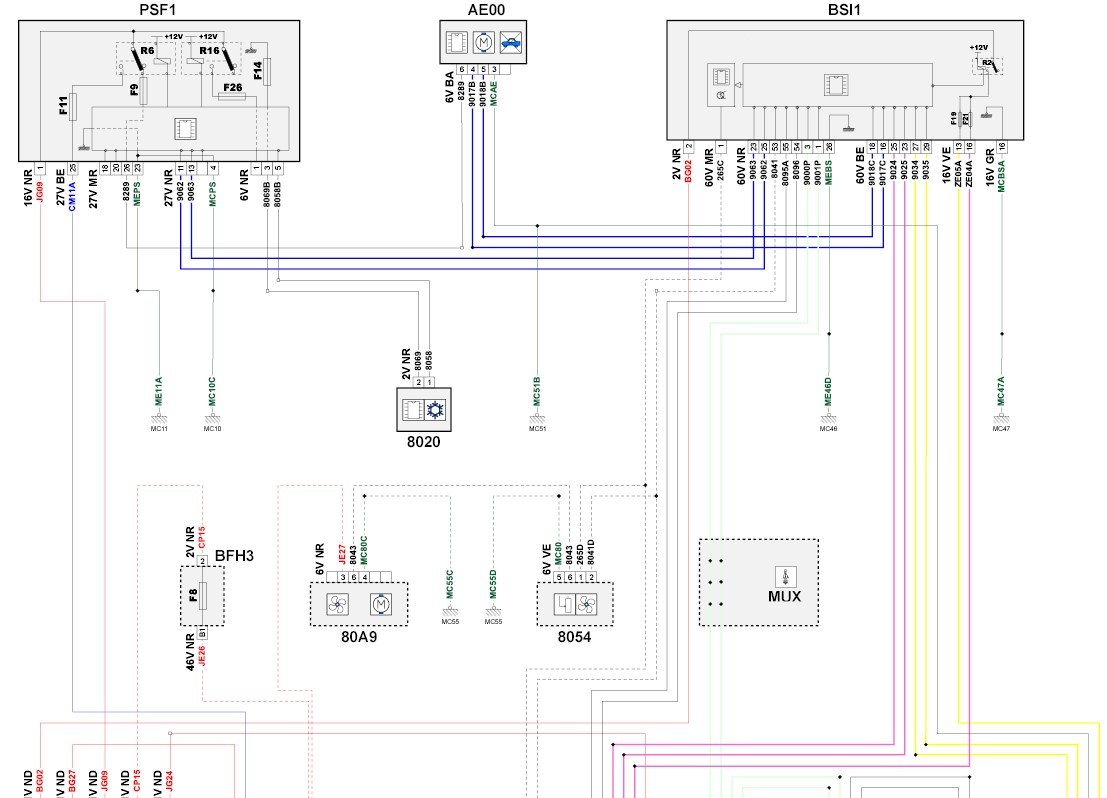

This should hopefully be the diagram for your car. I have had to do it in 2 halves as the scaling is to small to read as one.

Thanks for your reply. This looks like the Circuit Diagram for my car, but I can't read it even if I print it out magnified because the quality is so low. Are you able to send me a better copy?

Ok, this is the correct one for your vehicle based on your VIN. It is slightly different to the previous one but will scale at any size so you should be able to view it at any size without issue.
This one takes into account the electronic architecture installed, the correct A/C system and other options.

Thanks you very much for this, it prints out nice and clear.
Hopefully now I will be able to trace the fault.
