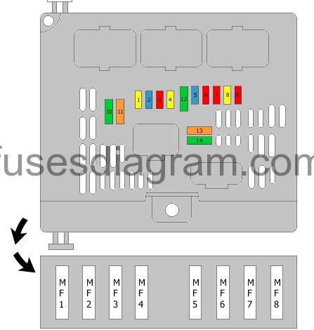

I can't find the fuse! The engine compartment board has this layout:
But the table below that diagram doesn't list a headlamp fuse, or one for any of the other fuse panels. I've looked on several websites.
Which connector supplied the headlamp?
Is there a headlamp relay? If so how do I access it?

The website for the fuse diagram is https://fusesdiagram.com/citroen/fuse-b ... -2008.html
I've also dug out the manual, and it doesn't list headlamp fuses at all!

I pretty sure there is no fuse.

So you have the standard Halogen headlamps. There are no direct fuses for these, so I would still go back and remove / recheck the fitting of the bulb as they can be a nightmare and replace the bulb with another as you can't always tell a faulty one by looking at it.
