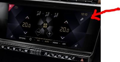

Retractable Clock:
Touchscreen Clock:
In either case you need to go into the SETTINGS of the Touchscreen to change the time. It's all on page 41 or thereabouts of the owner's manual.
Note that you can only adjust the date and time if the 'Synchronisation with the GPS' option is deactivated.
Touchscreen Clock:
