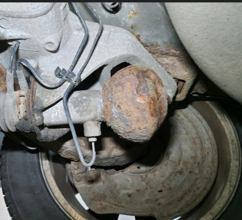

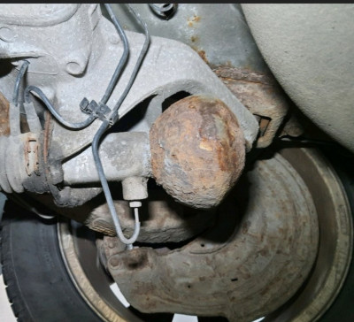

The belt never gor changed. Bloody caliper did though. Again. What is it with calipers continually sticking. Had loads on all my c5# including the usual corrosion issue. Garaged was good though. Lot of good advice. One of my spheres on the back looks corroded. They can't find the part. Are there spheres available still?
C'est pas possible!
x 6946
Re: timing belt 2006 136bhp C5 HDi
Spheres are available from Citroen and various suppliers - but the front struts on the C5 MK I & II are no longer available and with the rear struts, only the rear left ones available for non-hydractive 3 plus vehicles.

I assumed that I just need the sphere.
