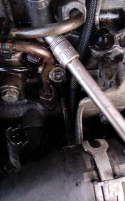

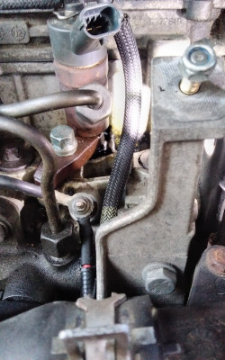

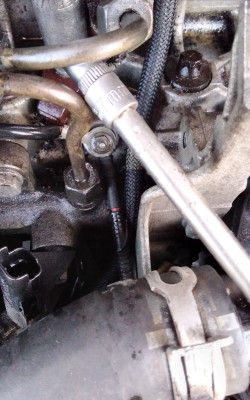

Huskyxantia
- Posts: 3897
- Joined: 30 Jul 2018, 22:11
- x 909
Re: Xsara Picasso Injector
Leak off test today all measurmemts the same 3 times tested.
Reseated 3 n 4 injector its made a difference but im not doing mega miles , new seal kit should be with me next week i hope.
Some pics below of the task.
