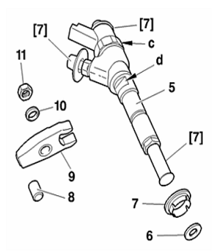

Marc, im going to do a leak off test soon i know the 2 ive got the chuff from may well could be clogged, do you have by any chance an exploded diagram of the injector numbered
0445110076 and if possible the tip end torque me thinks 30nms ? Cheers

That's more likely a manufacturer reference or an injector calibration code.
Torque setting for nut (11) is 3 dan.m
ESSENTIAL: Do not touch the nut at "c".
The nuts (11)
The cups (10)
The clamps (9)
The diesel injectors (5)
The sealing rings (7)
The seals (6)
The shims (8)
N.B.: If it is impossible to remove the diesel injectors, remove the fixing stud of the flange (9). Move the diesel injector by lifting it at "d" Using a flat spanner or pliers.
The nuts (11)
The cups (10)
The clamps (9)
The seals (6)
The shims (8)

Many thanks , this will give me good reference. Think i might take some pics when doing the mine and post on the forum a sort of how i did my injector remove clean amd reseal job

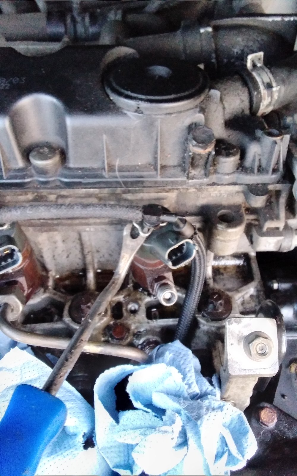

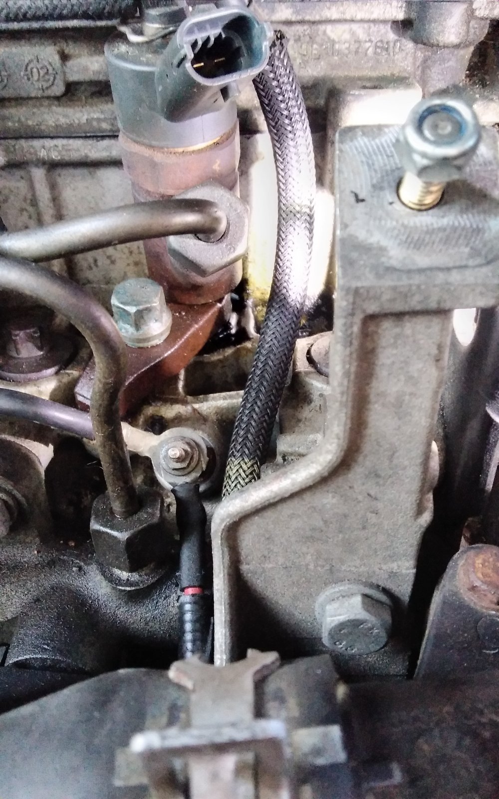

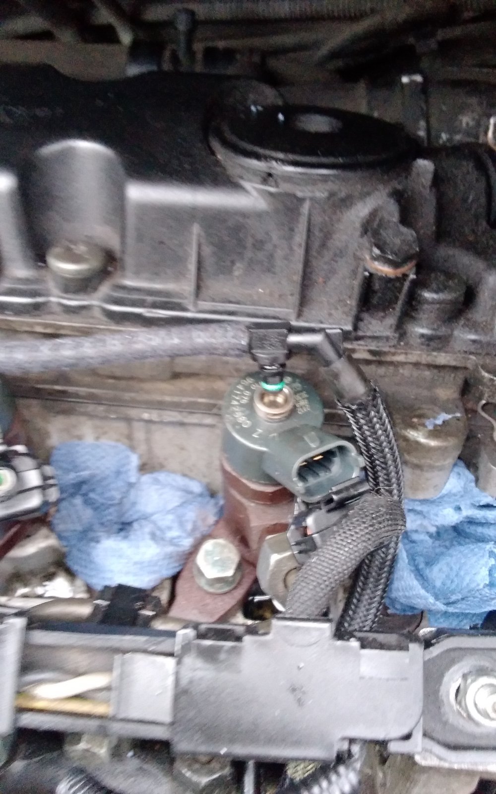

The star of my picassos black death.
So mpg dropping the smell imside the car then the chuff noise ... i will be documenting my task and first ever undertaking of taking out all my injectors reseating and all new seals myself , thanks to marc for his help with all the diagrams . Stay tuned
See the small patch below the injector ? See photo...

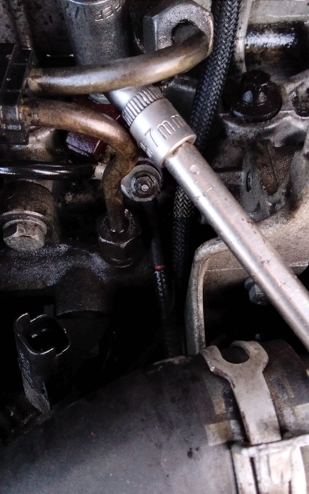

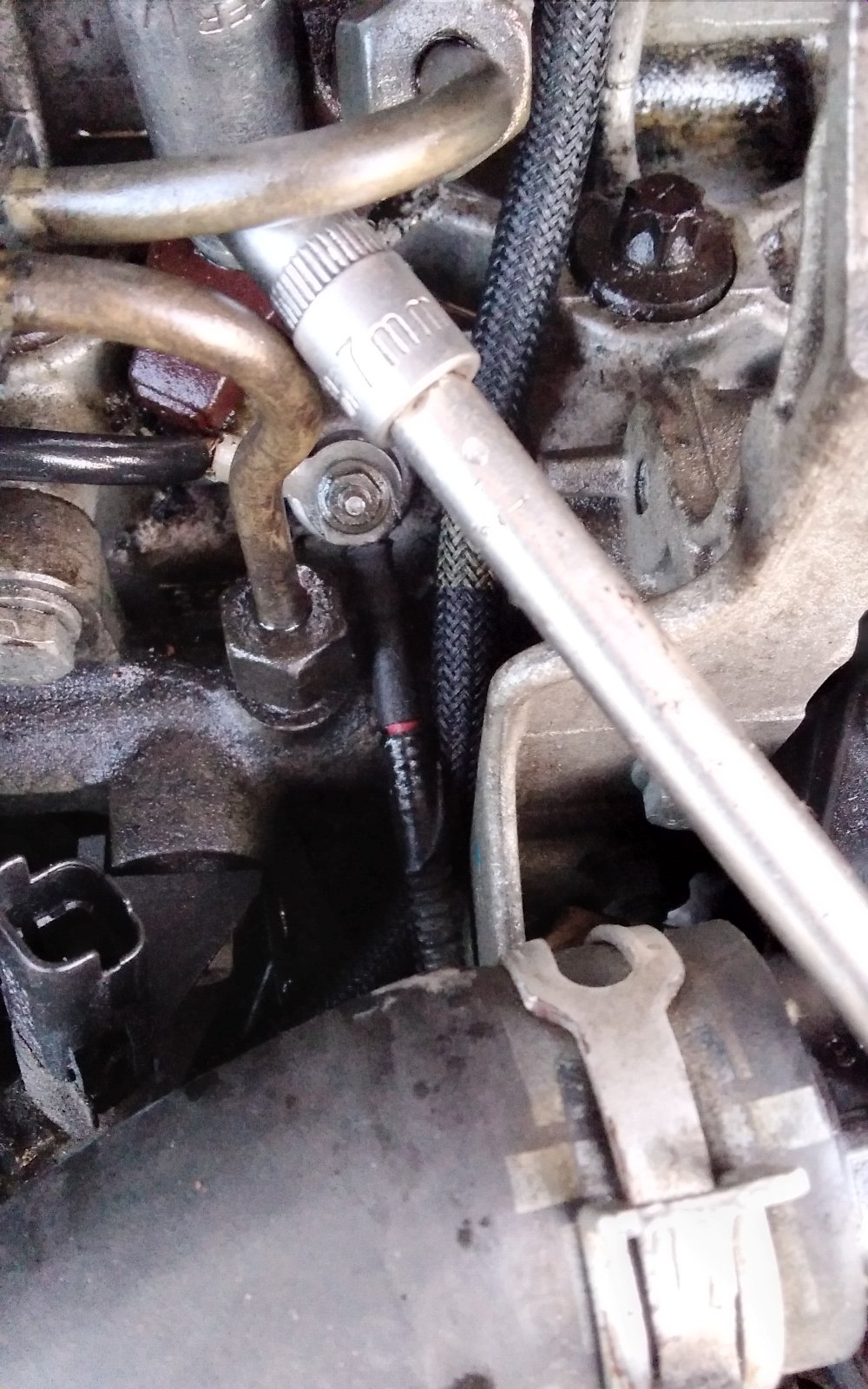

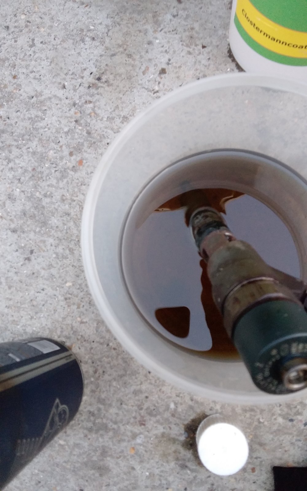

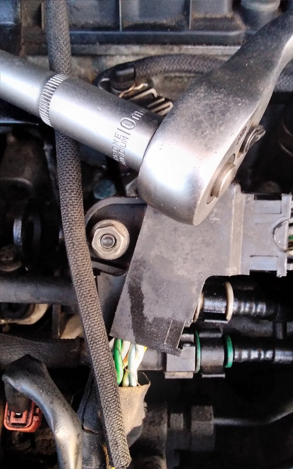

Leak off test today all measurmemts the same 3 times tested.
Reseated 3 n 4 injector its made a difference but im not doing mega miles , new seal kit should be with me next week i hope.
Some pics below of the task.
