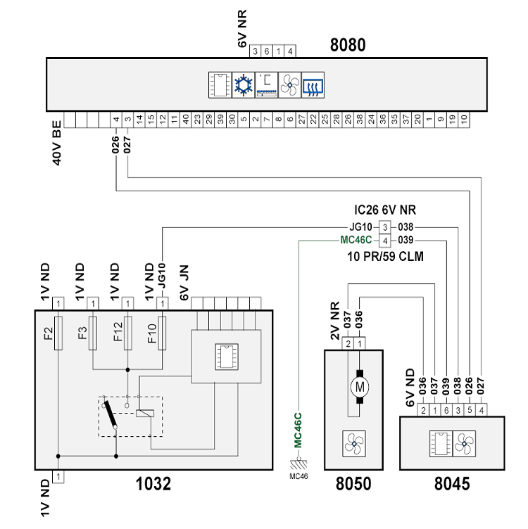

We have replaced the resistor it made no difference, there is power to the resistor.
The fan works with a direct feed battery connected to 36 and 37 on 8045.
The no 10 fuse is fine.
There is power constantly to 10 PR/59 from the pink and brown wires pictured when tested with a multimeter. With a direct feed to this the fan came on but at a lower speed to start which seemed to show the resistor was doing its job.
Any and all suggestions greatly welcomed!

GiveMeABreak wrote: 21 Oct 2019, 15:37 Unfortunately, a lot of the wire designations are not know - but on the diagram below:
8050 is the Blower Motor Module (where separate) and you can see that the earth MC46C connects via the interconnection harness to 039 at pin 4 which then goes to the blower module pin 6. So that is likely to be your earth - and the power looks to come from JG10 via fuse F10

If the resistor module follows the same basic design as the module on my Mk1 C5 the heavy wires handle the power (so a couple coming into the resistor module and a pair heading off to the blower motor), and the light wires are the data link to the ventilation control system.
- x 6950
Re: 2012 DS4 Blower not working
Right, first you need to be aware of an outstanding vehicle after-sales campaign. I can't advise you of what it involves, but it will be free of charge. So I would suggest you contact Citroen and give them the VIN / Reg and they can advise you of what the work involves.
Back to the issue at hand, first check Fuse F10 here in the Electrical Supplies Protection & Management Unit shown as '1032' on the picture. Fuse F10 controls the front A/C Blower. I would physically test it / replace it and not rely on a visual check as there can be hairline cracks.
This connection supplies the Blower Control Module which powers the actual Blower Motor, which would explain why it is working with a direct feed.
