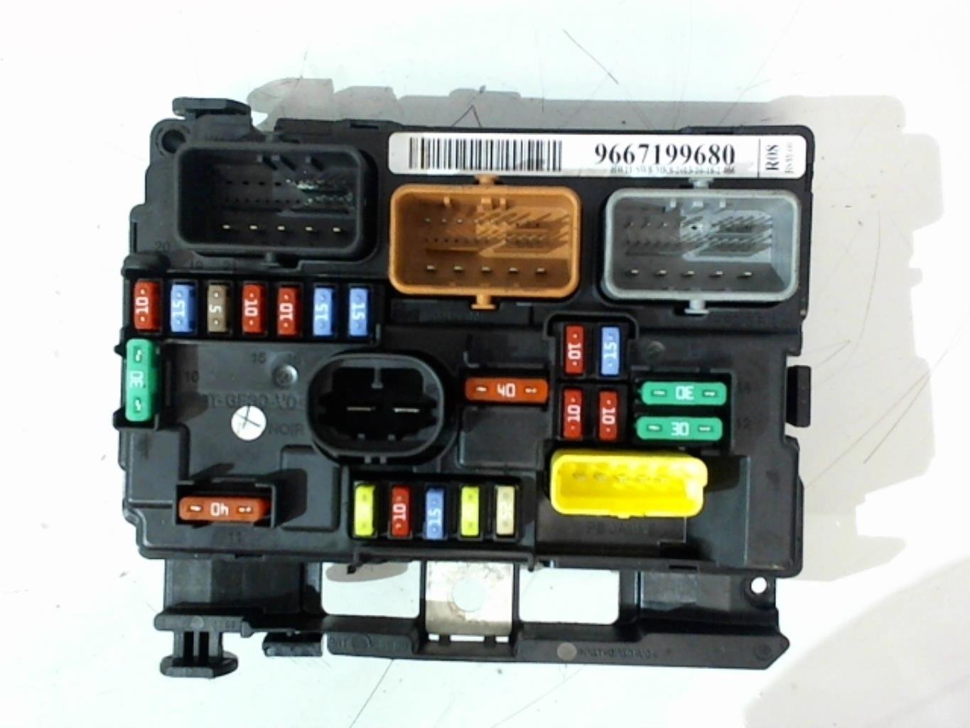

wheeler
Posts: 6885
Joined: 21 Sep 2002, 19:07
Location: United Kingdom
My Cars:
x 730
Re: Citroen C2 - dead electrics - No power to locks, interior light, ignition - everything dead
Post by wheeler »
Can you try disconnecting the plug on the yellow connector shown below (the plug iteslf will probably be grey).
Give Pin 2 a 12v feed & see if the starter operates. I think the pins are numbered right to left as you look at it but please check.
PLEASE ENSURE THE GEARBOX IS IN NEUTRAL BEFORE DOING THIS
napping
(Donor 2021)
Posts: 77
Joined: 07 Feb 2021, 13:39
Location: Hereford
My Cars: Current: Citroen C2, Volkswagen T3/T25 Reminisce about: 307sw, Citroen ZX Volcane
x 12
Post by napping »
wheeler wrote: 27 Nov 2021, 11:07 Give Pin 2 a 12v feed & see if the starter operates. I think the pins are numbered right to left as you look at it but please check.
Before I try this can I double-check that you're suggesting connecting 12v to the pin on the fuse box side OR is it the pin hole on the connector that gets the 12v?
wheeler
Posts: 6885
My Cars:
x 730
Post by wheeler »
Harness side
