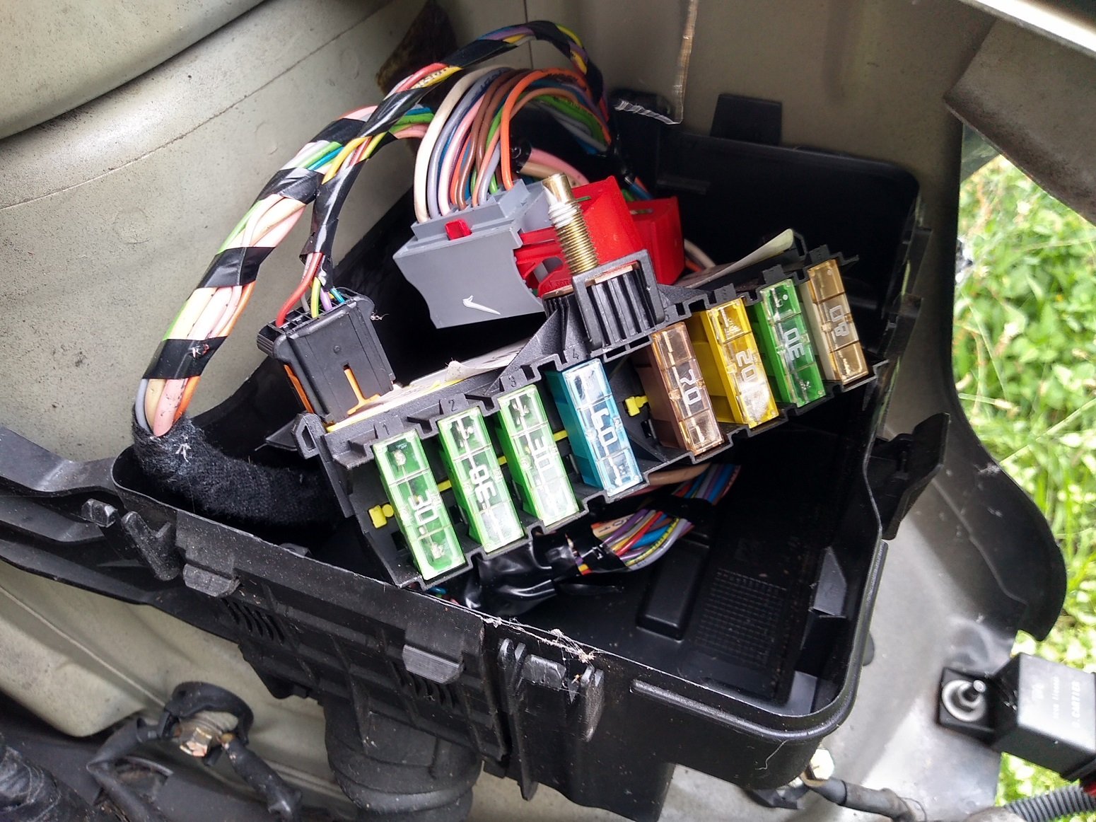

Arrggghhh! This thing is driving me mad!!! I am still not addressing all the symptoms! :hb:
If you have power at the BSM fuses then power is getting from the battery to the BSM. So the cable from the battery to the BSM is OK. Power for the above fuses will come from the ignition switch in the 'accessory' position. But the power for the ignition switch comes from a maxi fuse, as I mentioned above.
Do you get power to those fuses when the ignition is turned on? I bet you don't. Again, this will be the same power that runs the starter solenoid and that's not working.
The "starter" fuse is for the starter relay I mentioned before, not relevant to you. The air pump is for turbo charged engines (is yours a diesel? Not relevant in this case).
The maxi fuses also provide 2 sources of power to the BSI, which in turn feeds all the cabin devices.
There are a number of maxi fuses involved in the systems. A failure of just one will not cause all your symptoms but a failure of all of them will. But knowing what I know about the Maxi fuses and the power distribution system I cant think how this could happen.
I am thinking there is a problem with the maxi fuse distribution...I don't know what, but it's all that I've got...again.
I can only suggest removing the BSM and inspecting the maxi fuse panel.
...For the last time. :lol:
This is what the maxi fuse block looks like when you remove the BSM.

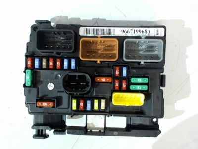

Can you try disconnecting the plug on the yellow connector shown below (the plug iteslf will probably be grey).
Give Pin 2 a 12v feed & see if the starter operates. I think the pins are numbered right to left as you look at it but please check.
PLEASE ENSURE THE GEARBOX IS IN NEUTRAL BEFORE DOING THIS

wheeler wrote: 27 Nov 2021, 11:07 Give Pin 2 a 12v feed & see if the starter operates. I think the pins are numbered right to left as you look at it but please check.
Before I try this can I double-check that you're suggesting connecting 12v to the pin on the fuse box side OR is it the pin hole on the connector that gets the 12v?
wheeler
Posts: 7928
Joined: 21 Sep 2002, 19:07
x 1053
Re: Citroen C2 - dead electrics - No power to locks, interior light, ignition - everything dead
Unread post by wheeler »
Harness side
napping

wheeler wrote: 27 Nov 2021, 18:52Harness side
ozvtr wrote: 27 Nov 2021, 06:47 I can only suggest removing the BSM and inspecting the maxi fuse panel.
Earlier I removed the BSM to inspect the maxi fuses and tested each fuse to see if any were blown - none were. So far I haven't pulled any of the maxi fuses out as they felt well seated and they didn't want to budge. Perhaps the next step is to test for an open circuit to the BSI - but without a wiring diagram for the Mk2 I fear prodding with a multimeter could do more harm than good!
I bought a Haynes manual specifically for a wiring diagram, but the manual only shows the Mk1 BSM/BSI - and despite trawling the net I have not managed to track one down yet. :o
