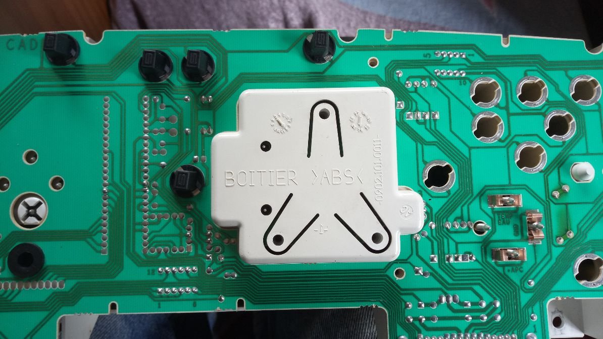

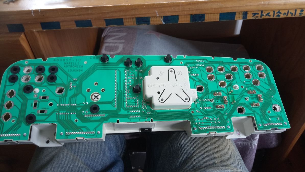

Hi, I got the dash PCB without, fortunately without removing the steering wheel, as it showed no signs of wanting to be removed. Only problem is the pcb is different to the one in the link and I'm trying to determine which are the soldered joints associated with the speedo. Attached photos of the pcb. Thanks.

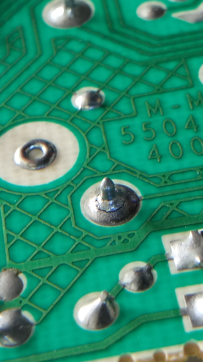

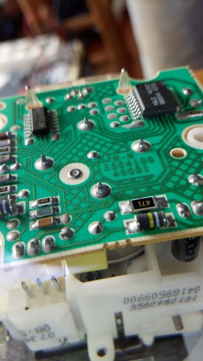

I took the front perspex cover of the dash display and took out the speedo. Sure enough on the pcb there are the soldered pins in question, and one with the crack which I hope is responsible for the problem. Resoldered all four and will reassemble everything.
