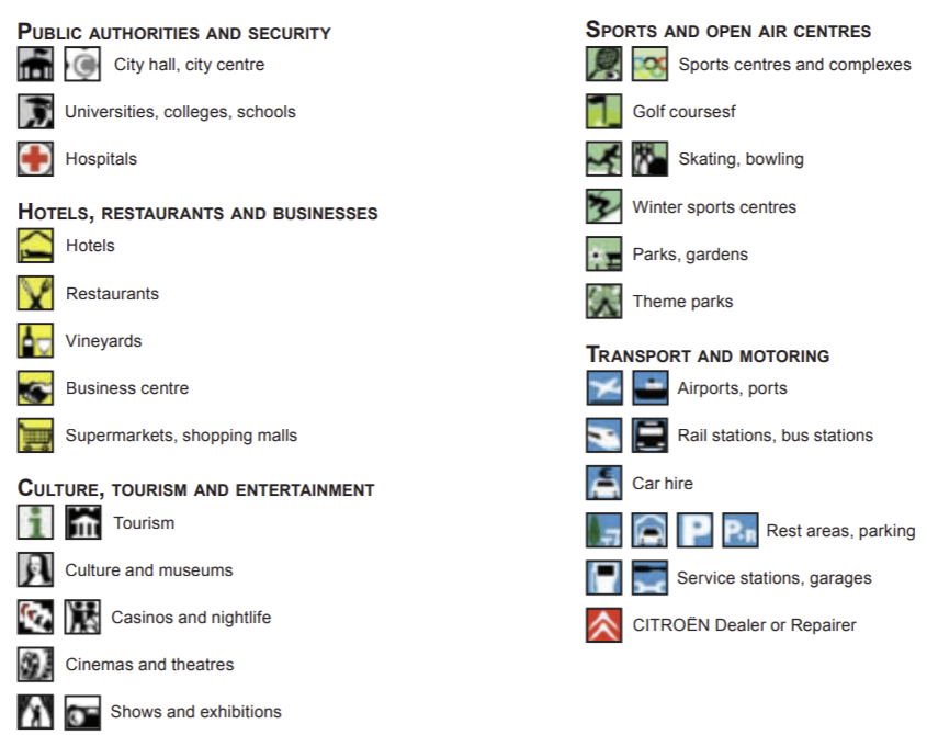

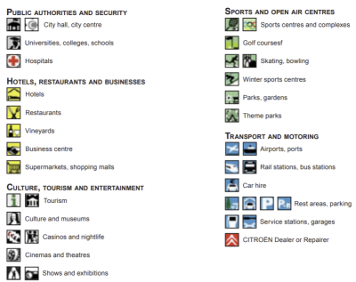

POIs or Places Of Interest are things like museums, parking places, garages, petrol stations, schools, civic buildings, shopping centres, police stations, schools etc etc. If you have enabled ALL these then of course ion a large town or city your map will be swamped with little icons and if you are zoomed right out, you won't see much of any map - it will be one huge mess.
These are the POI symbols / options:
If this is the case and you have too many of these displaying you need to go into your map settings:

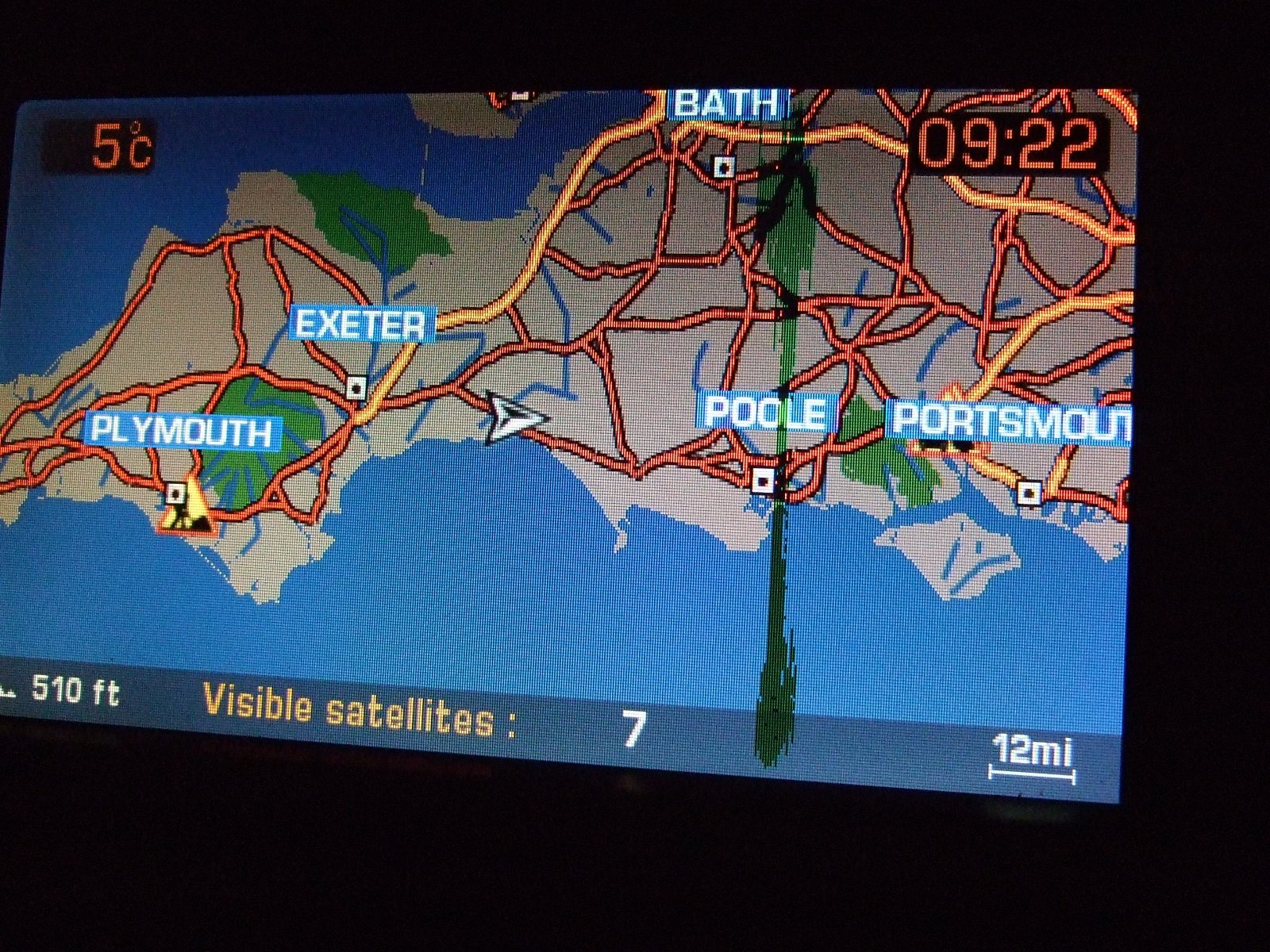

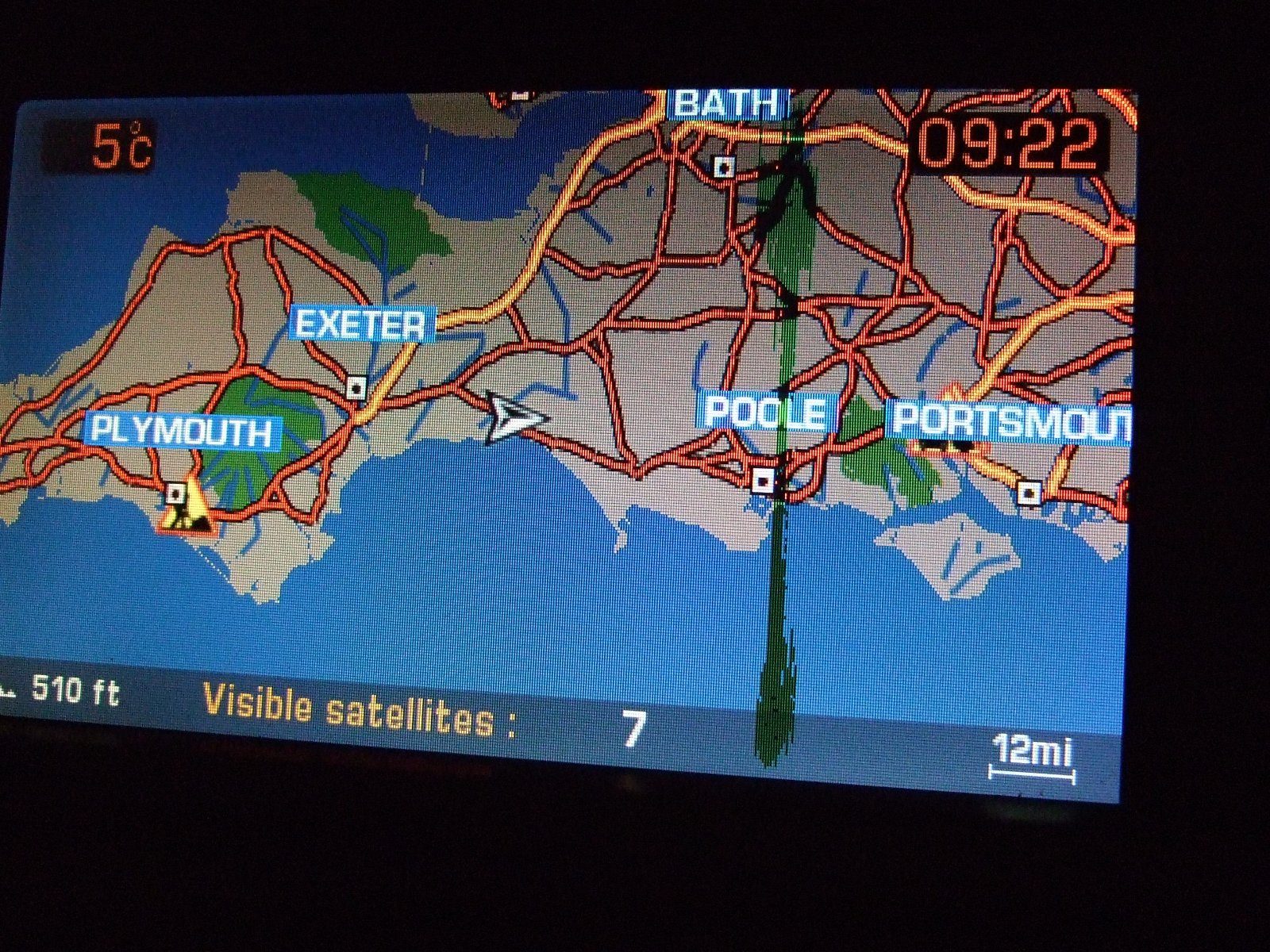

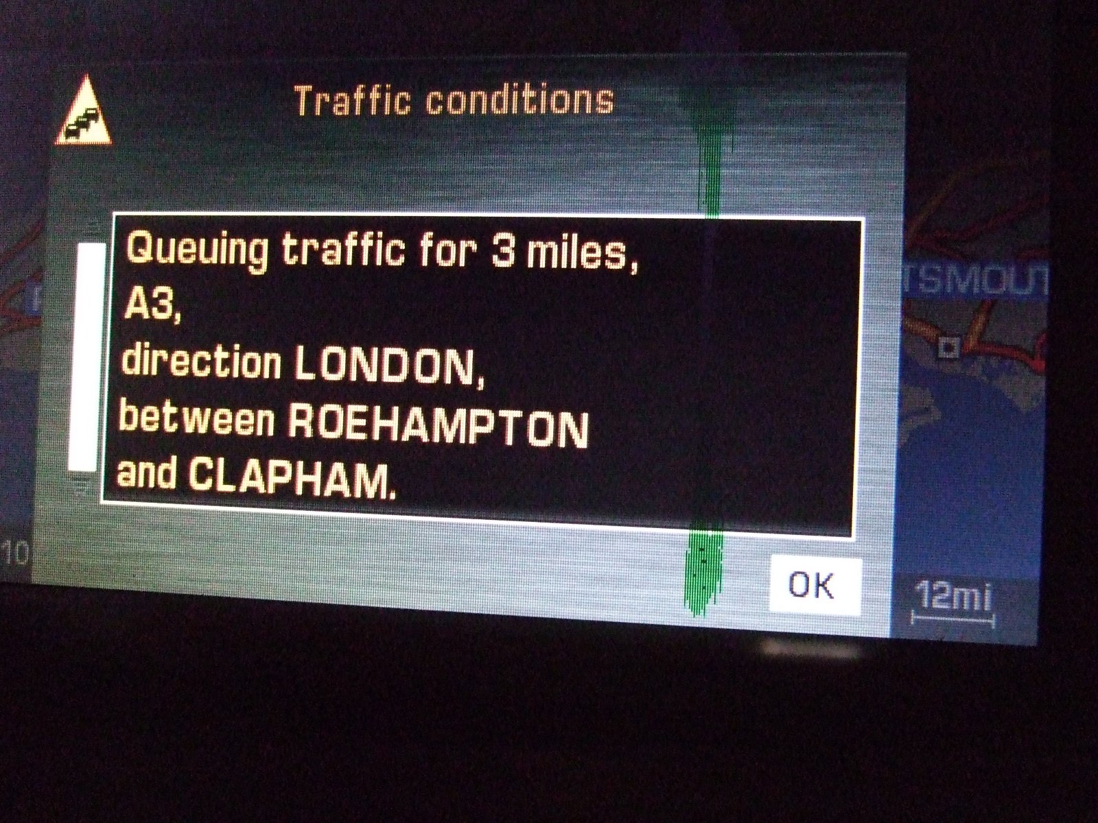

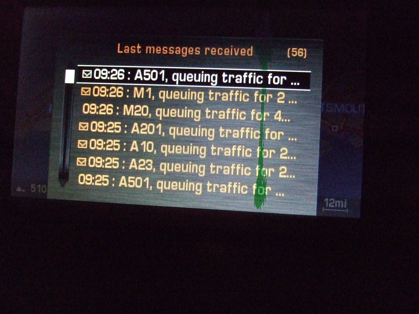

Hi Marc
Sorry about all the pictures, I had trouble uploading them and that was the best result I could get
Pic 1 as I turned the ignition on with it set to 'navigate'
Pic 2 appeared after a few seconds
Pic 3 appeared a little later
Whatever menu choice I set it to, 6 choices? after a few seconds it reverts to the traffic info.
