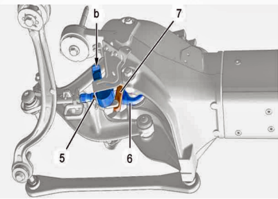

I wouldn't change anything with Diagbox - that is only for fine tuning the heights. I'd advise against changing anything there because the values entered are only after the height setting / calculations are done and the resulting values are entered in which are converted to other values internally by Digbox so the values are not physical measurement.
I don't have your VIN Stu, but regardless if you have a V6 engine the height correctors are completely different to the 4 cylinder engines.
On V6 models there is a Wheel height sensor on each wheel and not on the axles. So I suspect they may have disturbed it or worse if they didn't know what it was....
I'd check out the fronts and carefully compare position just to see if you can find anything obvious, then try some silicon oil (not WD40) on the linkages to see if that helps. Also check the electrical connectors - as these may be loose.
X7 V6 Front Wheel Sensor Location | X7 V6 Rear Wheel Sensor Locations |

Ok here you go:
Item (2) Front Body Height Sensors
Front Left (Red Identification) 5273J7 £73.34
Front Right (Yellow Identification) 5273J8 £73.34
Item (9) Rear Body Height Sensors
Rear Left (Blue Identification) 5273J5 £76.12
Rear Right (Green Identification) 5273J6 £76.12
The angular Pick up in case you need it (8) is the same for front and rear 527381 £6.65 each.
All prices direct from Citroen as of today and include UK VAT.
A word of caution Stu. If replacing these yourself, it goes without saying to support the car independently, as any change to a height sensor can cause the vehicle to drop hard and fast without warning and will crush you.
Also, the sensor support brackets shouldn't need top be moved, which is essential to maintain the correct position. If these are moved, be sure to mark the exact position / angle so they can be replaced in the exact position.
I'll put a guide together for replacing these and will update this post with the link for you.

Ok, as promised, here's the procedure for removing / refitting them:
C5 X7 V6 Engine Suspension Height Corrector Wheel Sensor Replacement
