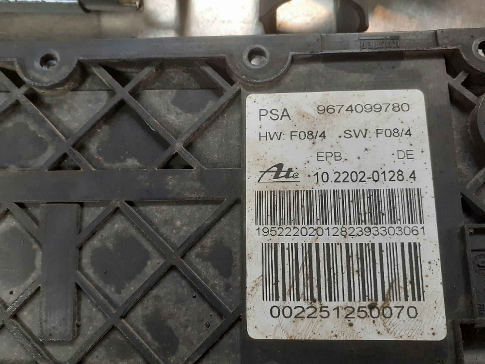

Hello does anyone know where I can buy the EPB module that the cables attach to please.
I don't need the cables as I have new ones but the plastic gears inside the module are stripped.
Part number PSA 9674099780
C5 2013 2.2 HDI Tourer
Many thanks
Mark
Many thanks
Mark

Citroen do not sell the components - only the entire module unfortunately.
The handbrake module is part 1612865480 and is £1133.45 UK inc. VAT.
Also, be aware that this replacement part deletes the unlocking tool.
So have a search on 1612865480. There is a Chinese version on Ali Express - no idea of its quality or anything but at £134 it might be worth a pop if you can't turn anything else up - especially if you just need parts. I think it comes complete with cables, but maybe worth a check!
