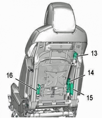

From another thread: viewtopic.php?p=599233
Part 14/16
Part 14/16
Motor part: 14 or 16. (Same part)

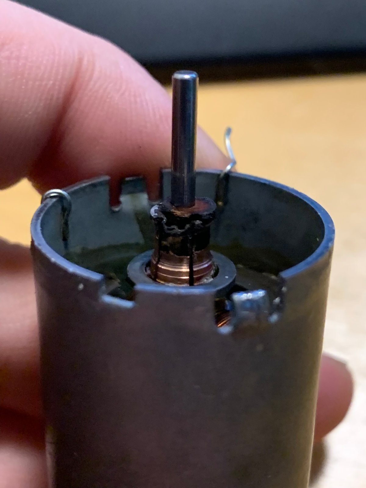

The Brushes or coal are in perfect shape.
It's the copper they are riding on, the "commutator" that is worm away completely.
and as far as i know, the old motor is not salvageable or repiarable.

The Commutator looks like this.
