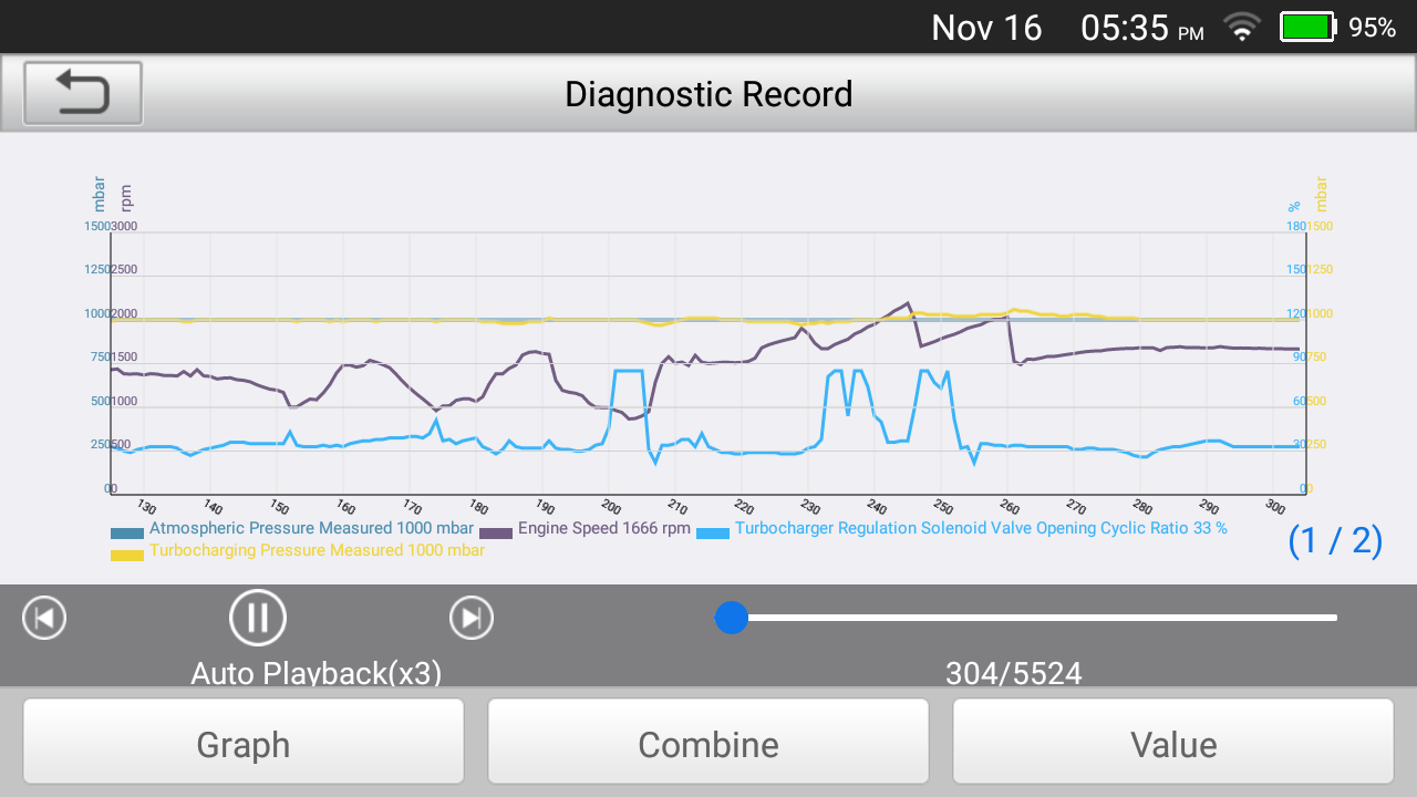

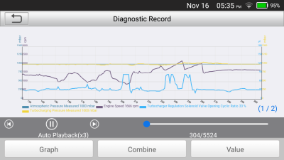

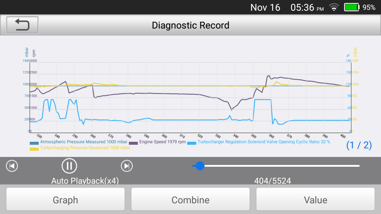

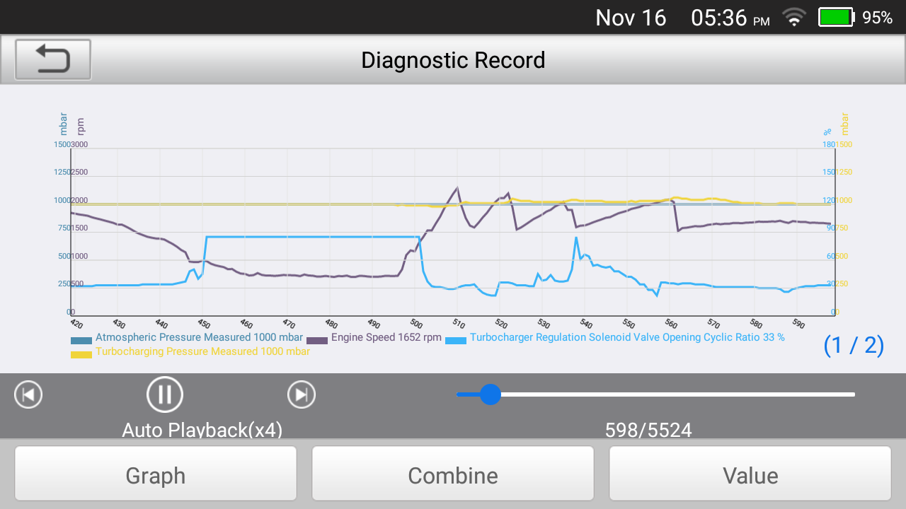

Peugeot 508, 1.6. THP 156Bhp
I suspect my turbo system might be "lagging" - attached are screenshots from a live data session i recorded today - can anyone make sense of it ? #-o

I can see the graphs.
It does not look like you have any significant boost, the yellow line is more or less flat. Can you see the wastegate actuator rod moving as the engine is revved? Maybe you should check the vacuum on the wastegate control pipe?

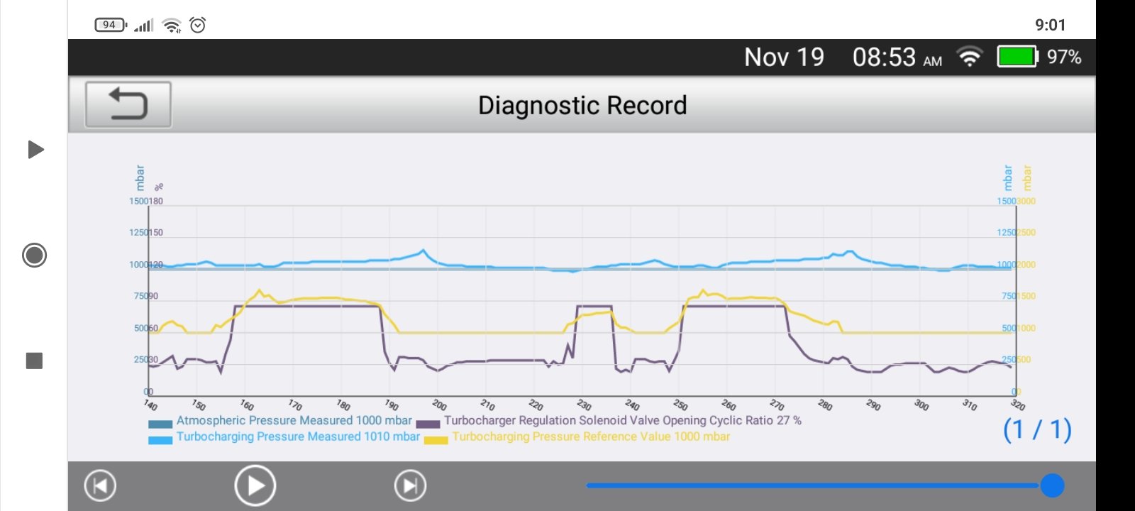

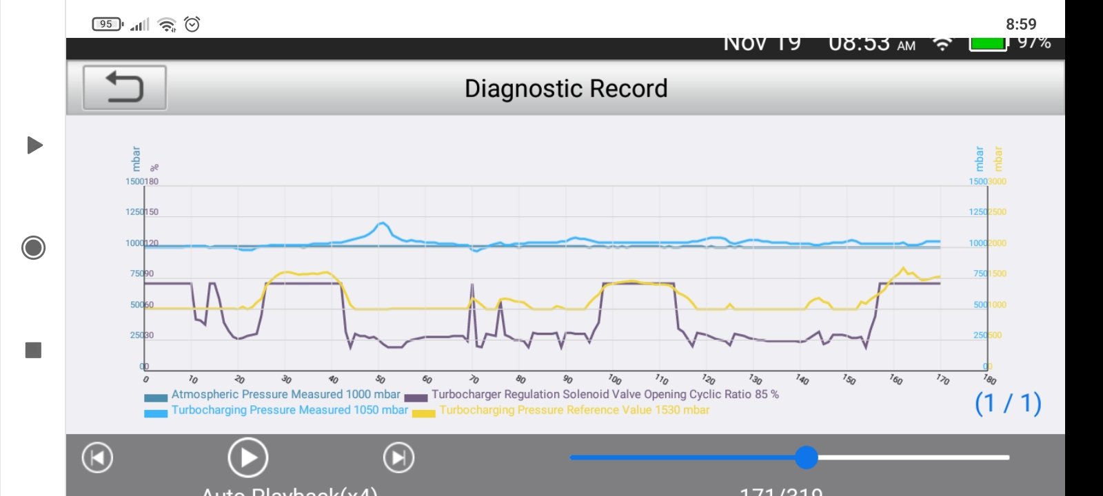

So.... I replaced the boost sensor and i guess the difference can be seen on the pics (and the ride also feels better).
However i am not sure if this is "it", Don't know the reference values

The new graphs still look wrong. The reference pressure (yellow line) is the pressure that the ECU wants to see out of the turbo, which is between 1000 and 1500 mBar (normal). The black line is the signal to the wategate control valve, which is topping out trying to give maximum boost. The blue line is the actual measured boost which is sitting around 1000 to 1200 mBar, and nothing like the shape of the yellow line. Where the blue line does peak a little is probably where the throttle is closed with the engine revving and the airflow to the manifold is shut off.

Looking at the graphs...it seems as if that the yellow/purple and the blak/blue combination have "switched" places after i replaced the sensor. Previously yellow/purple were fairly flat and black/blue were "all over the place" - can we deduce something from this..?

Nothing has changed, except the scan tool has chosen different colours for each measurement. Look at the labels.
