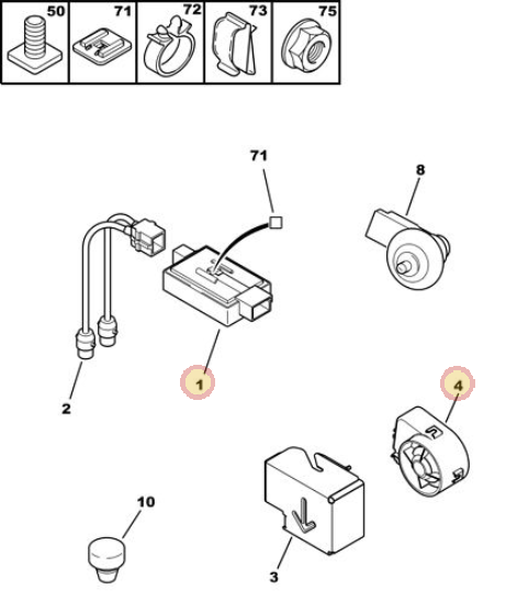

The control module seems to be located somewhere inside the front passenger glovebox and the siren is connected to this.
So not sure which part you are wanting to replace, (4) is the siren, (3) is the siren support bracket which is on the nearside wing at the front corner somewhere. All parts are showing as available except the internal volumetric sensors (2).
6680W7 is the Siren (4) £174.17
6680V1 is the Alarm control unit (1) £200.54
