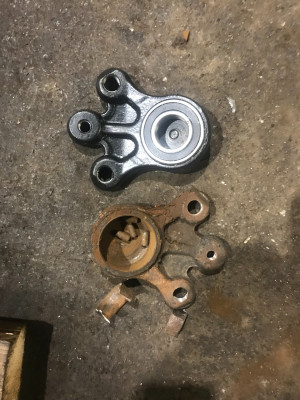

Replaced one last week on one of my C6's. It's a doddle with a long power bar and an angle grinder!
Give me a shout if you need someone to do it for you.
I also replaced bush arrowed by Marc as a preventative measure. Again easy done with the right bush removal tool.
I did 500 miles on that broken one when I collected the car
