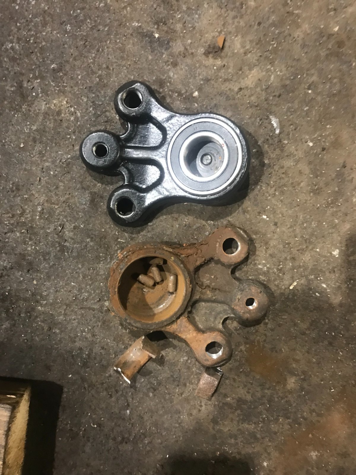

MGmike
Posts: 182
Joined: 29 Aug 2020, 18:29
x 63
Re: Play on front wheels
Unread post by MGmike »
Replaced one last week on one of my C6's. It's a doddle with a long power bar and an angle grinder!
Give me a shout if you need someone to do it for you.
I also replaced bush arrowed by Marc as a preventative measure. Again easy done with the right bush removal tool.
I did 500 miles on that broken one when I collected the car 8-[
