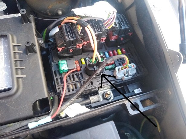

Hi,
I am working on the replacement of the BSM of my beautiful Citroen C5 from 2005 (type BSM 6500CK).
I have difficulties removing the central connector. Could someone help me please? How can I remove it?
Many thanks!

Theres a little plastic tab on the connector that you use a small screwdriver or similar to pull back in the opposite direction to your arrow whilst you pull the connector out. It very straightforward.

Well, this will do. Many many thanks wheeler!!
