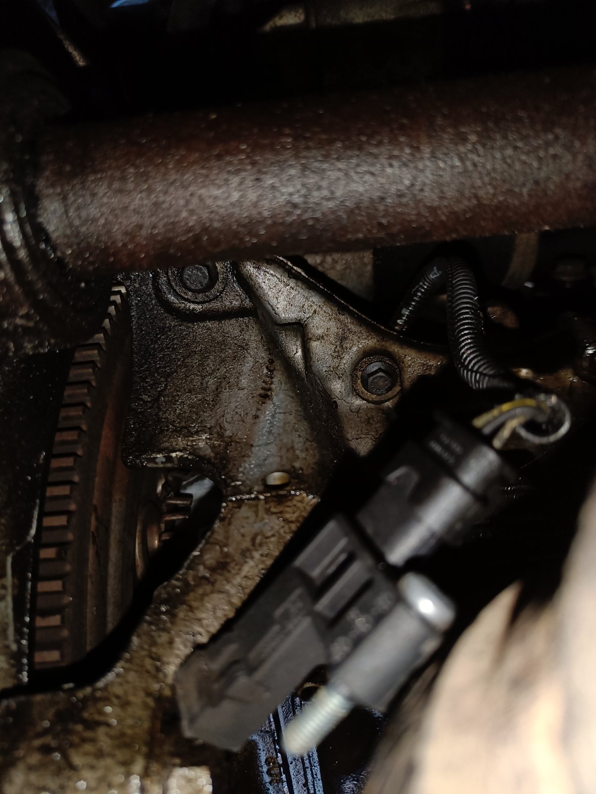

Funny enough was tempted to get a compression tester recently just in case. But I think I've found the problem.
Not the crankshaft sensor that was the problem but the teeth were bent with one slightly bent, one very bent +45° and maybe one missing.
Doubt it's something I can fix at home so will be taking into the garage. Anyone have any ideas of causes and would it also cock up the timing?
Cheers everyone will keep you updated with what the garage say!

Cheers Marc.GiveMeABreak wrote: 07 Nov 2021, 16:17 See my post here that shows this issue:
viewtopic.php?p=701603#p701603
Have you got any idea how to get to it / get it out, doesn't seem much access from under the car also slightly limited to what I can do since it's parked on the side of the road so might need to get it towed.
Also don't think there are any HPFP problems since I replaced that 4 months ago.
Also had the VVT and tensioner done a similar time so hoping it's not timing related.
Hopefully if I can get the teeth replaced / fixed and replace the sensor we should have a starter.
