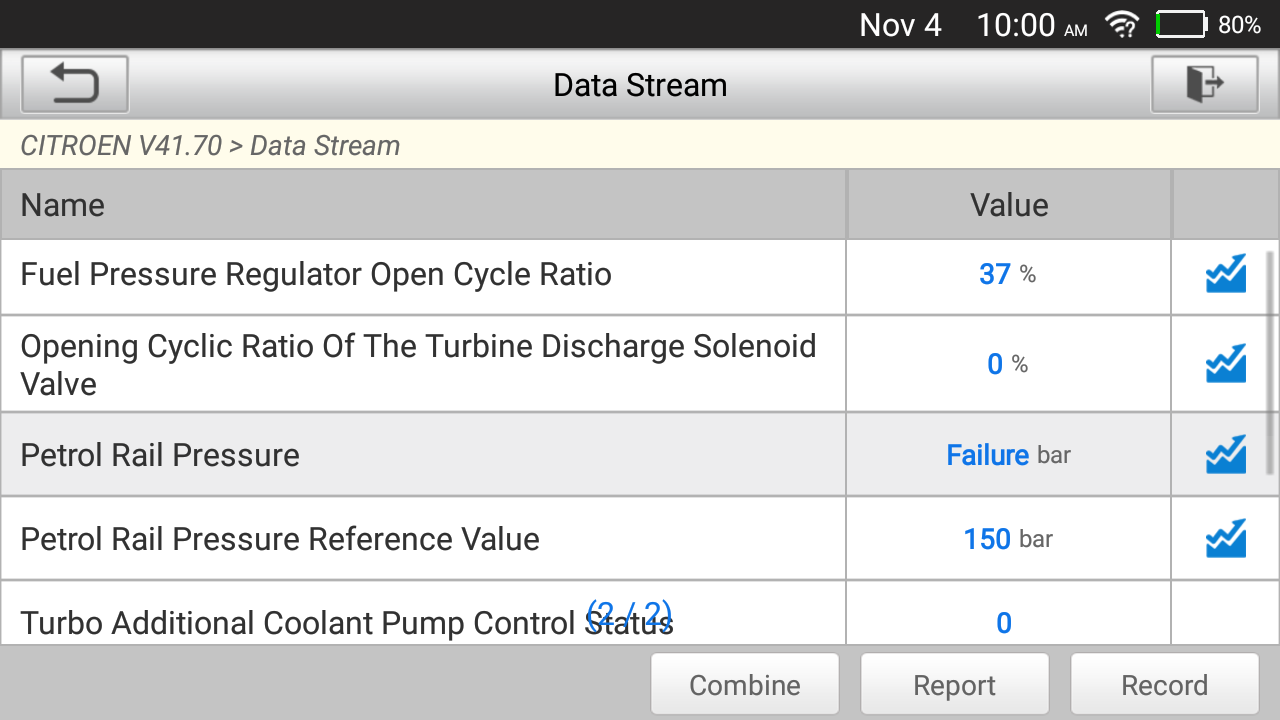

I was wondering ... would it be possible to have a faulty high pressure pump without it "shooting" a fault code (not shown on OBD, no "check engine" light/message" is on and basically no other fault is present as well) ?
The reading shows a "petrol rail pressure" "failure" (see the attachment) and car stutters a bit when REVS are in the lows (on cold start or at traffic light) - spark plugs/ignition coils are ok (and also, no misfires alarms are on) ; battery/alternator seem ok as well ; did a DIY "carbon clean" procedure using CFC's designated stuff so carbonization should be not at highest level (if you believe the stuff works, didn't check with camera, a nightmare on this engine :-D )

There should be fault codes logged, so maybe your diagnostic tool is unable to read them. Diagbox will be able to read any codes stored.
There are various technical bulletins concerning the THP engine on this vehicle, but most have an associated fault code.

thanks...maybe this "failure" read on the picture i attached suggests that the fuel pressure sensor is the faulty one ?
x 6957
Re: high pressure fuel pump - c5x7
It's a difficult one without more info - as the low rail pressure could be the pump or the sensor or something else related. If you can get it read with Diagbox it may provide more clues and then with one or more fault codes it may narrow the options a little.

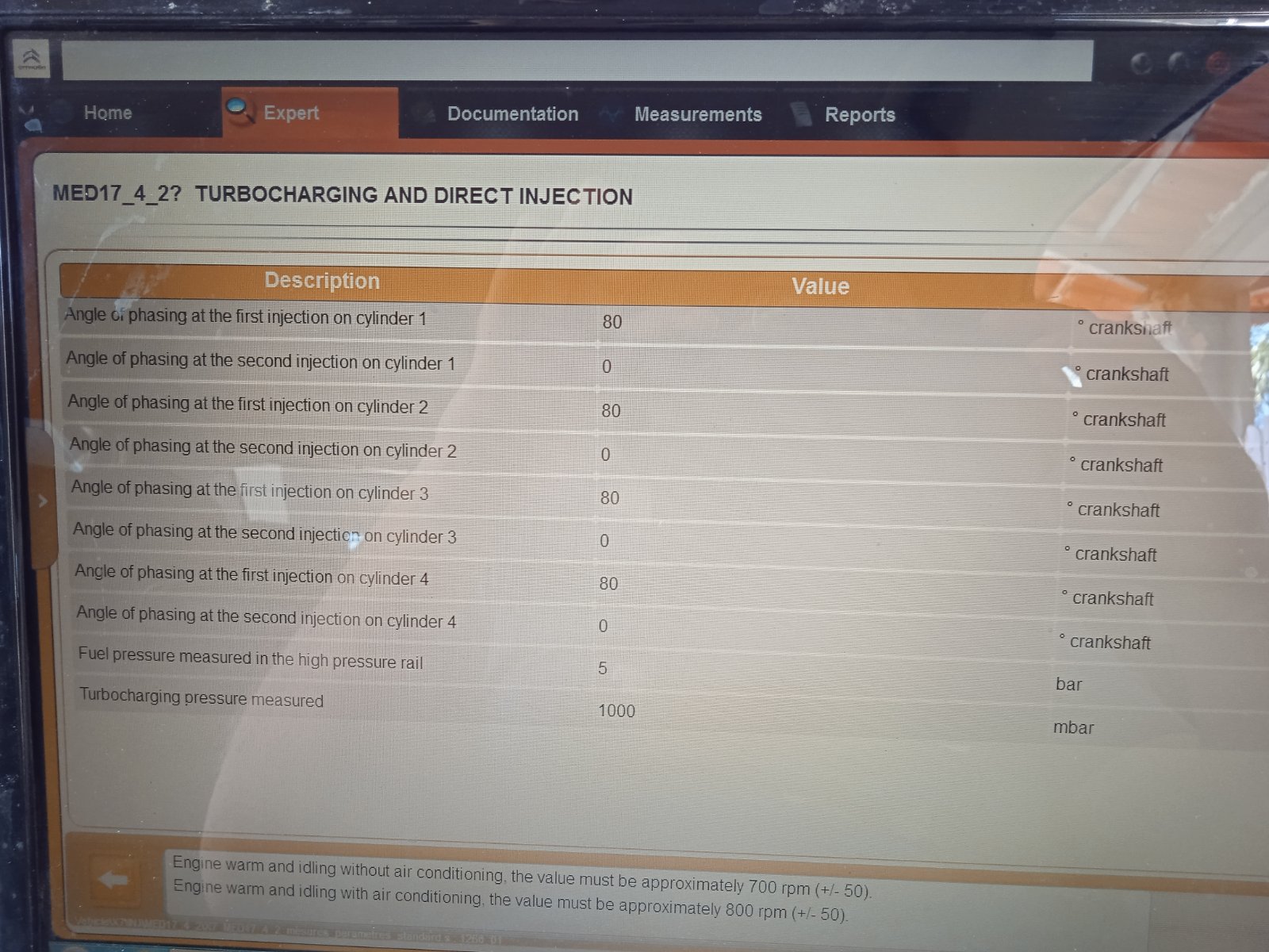

Hi
No record of any faults
Took some pics with engine on/off. Made a video but can't upload here
Don't know the correct values for reference
Thx

Back to the the high pressure fuel sensor. The voltage of the sensor output varies according to the pressure in the fuel rail. The voltage ranges from 0.25V to 5V on a scale according to the pressure which goes from 0 to 160 (bar). The fuel high pressure varies between 50 bars at idle and 120 bars under full load at high engine speed. So your value of 46 / 47 would be about right at idling. What pressure are you getting when you rev the engine?
There is also a fuel excess pressure valve that can limit the output pressure to 140 bar.
