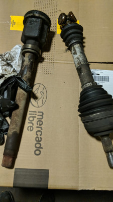

Another beginners question...
How hard is to remove the right side driveshaft? Will gearbox oil come out?
Thanks!
Thanks!

The drivers side has a centre bearing but if you are only changing the boot you don't need to remove it. Just slide the old boot back and while holding the shaft give the cv joint a good whack outwards with a lump hammer, I use a 4lb one, it should come straight off.

ekaftan wrote: ↑01 Nov 2021, 00:29
That will split the cv joint itself and leave part of it attached to the car? I assume I have to remove it from the wheel side first right?
(I have rebuilt engines and rebuilt transmissions and somehow never did suspension or CV joint work before this car... also, I had to google 'lump hammer'
Thanks!
Peter.N. wrote: ↑01 Nov 2021, 10:42 The joint is held to the shaft by a 'snap ring' if you hit the joint hard the ring will compress into the groove and release the CV joint from the shaft leaving the boot on the shaft. Slide the boot off and give the shaft and joint a good clean.
Squeeze the supplied sachet of grease into the joint and slide it back on the shaft, after fitting the new boot of course, the snap ring should open in the groove and lock the joint in position. Pull it to make sure it has locked on, if not a tap on the outer end of the joint should seat it.

Re: 2001 c5 driveshaft boot
ok... so, I leave the inner join attached to the car and split the outer one....
My torn boot is the inner one... I have read that joint can be split without hitting it... its just the boot that holds it.. right?
Thanks!!!
Thanks!!!

@ ekaftan: If it helps. I've just put up a guide for you in the member's Resources Section:
C5 MK II V6 ES9A Driveshaft Removal-Refitting Guide
Wrong, the joint is held in the pot by small lips on the inside of the pot. They will come out with a little force but they shouldn't be removed if it can be avoided. Split the joint at the outer end and slide the boot on from there.

Re: C5 MK II Drive Shaft
Inner ones are different and need the extra rubber to fit the "dimples" of the inner pot. Universal ones are only good for the outer joint, ask me how I know
I didnt realise it was an inner boot. I still use them on inner ones where possible but yes they dont fit every inner joint.
GiveMeABreak wrote: ↑01 Nov 2021, 15:35 @ ekaftan: If it helps. I've just put up a guide for you in the member's Resources Section:
I am happy to report that I just finished redoing the boots and your guide was spot on.
I am very very happy
