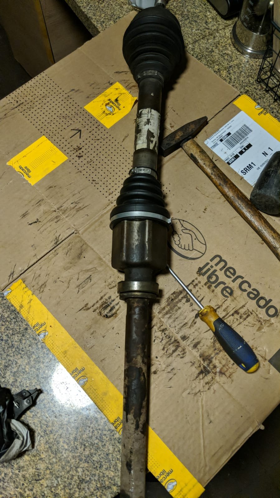

I am happy to report that I just finished redoing the boots and your guide was spot on.
I am very very happy :)
Before
Before
After
After
