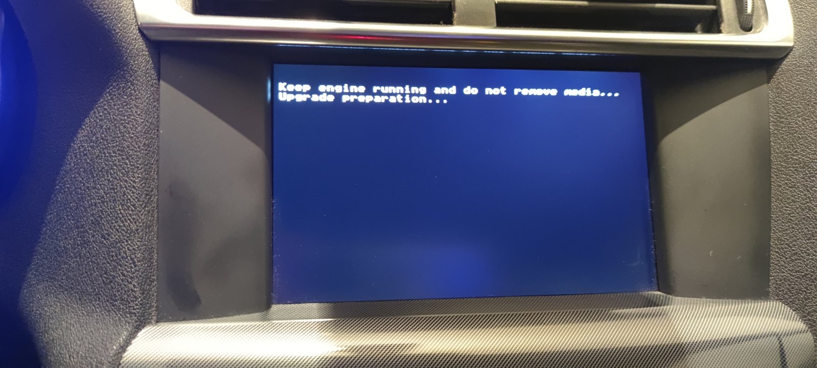

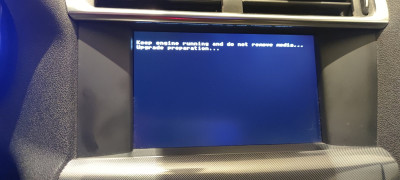

Re: How to Replace the Internal MicroSD Card - RT6
Citroen C4 Exclusive 2.0 2010
I tried to install the software via usb RT6 2.86 stuck "keep engine running and do not remove media....Upgrade preparation, I have tried several times always the same
- x 6945
How long have you waited?
Have you recently replaced the internal MicroSD card or are you trying to a firmware update?
If the above, was the system working correctly before you attempted the firmware update?
instruktor69
- Posts: 3
- Joined: 15 Nov 2021, 20:36
- x 1
I waited for about 45 minutes to an hour, I did not change the sd card, the system worked properly before the first attempt to update, I removed the cable from the car battery and it was the same again, I changed the usb but all the same, it always starts to update on the same place stuck.
- x 6945
Then I'd get another firmware file form another place - these can easily become corrupt due to the download process and fail the CRC check.
I'll send you a PM with a firmware link, but to guarantee a fault free version, the CD can be ordered for a few euros at the dealership.
instruktor69
- Posts: 3
- x 1
Thank you very much GiveMeABreak you helped me a lot, the installation with that file was successful, succeeded via usb, thanks for the great help!!!!!
