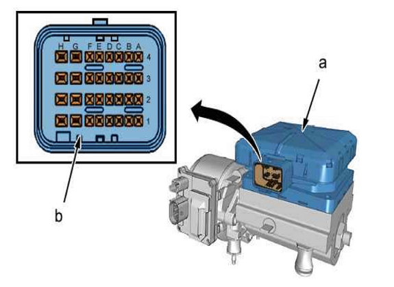

The integrated hydro-electronic block ECU controls the following components:
"b" 32-way black connector .
Allocation of the channels of the black 32 -way connector

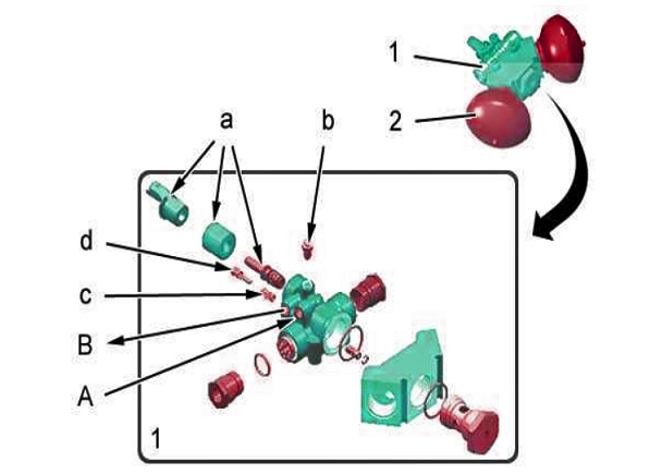

"A" : High pressure inlet (Integrated BHI ).
"B" : Return to the reservoir (Integrated BHI ).
(1) Rear firmness regulator.
(2) Rear stiffener regulator accumulator.
"a" Variable firmness electrovalve.
"b" Bleed screw(s) .
"c" Return spring.
"d" Hydraulic isolation slide valve.
Role
The rear firmness regulator permits modification and regulation of the firmness of the suspension on the rear axle.
Channel No. | Designation |
"c" Return spring.
Role

Have you screwed out the solenoid itself?
A common fault is that the plunger-thingy gets sticky from rust buildup inside.
Taking it apart and poloshing it with fine grit sandpaper seems to fix it
