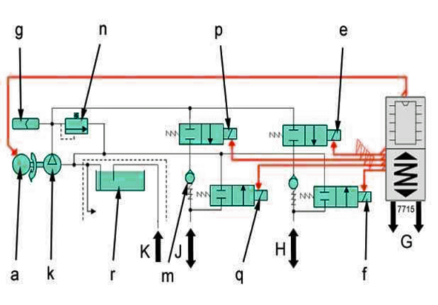

I did put a load of stuff up years ago, but here's the BHI hydraulic diagram for reference: Please note this is for the 4 Cylinder Engines of the Citroen C5 X7 (MK III) - not for 6 Cylinder Engined X7s:
BHI Role

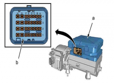

The integrated hydro-electronic block ECU controls the following components:
"b" 32-way black connector .
Allocation of the channels of the black 32 -way connector
Key
"G" To the front and rear stiffness corrector solenoid valves.
"H" To the stiffness corrector (Rear ) (Input /Output ).
"J" To the stiffness corrector (Before ) (Input /Output ).
"K" LDS fluid return from the stiffness solenoid valves.
"a" Hydraulic pump motor.
"b" Suspension ECU.
"e" The suspension inlet electrovalve (Rear ).
"f" The suspension exhaust electrovalve (Rear ).
"g" Pressure accumulator.
"j" LDS fluid reservoir.
"k" Rotating plate.
"m" Delivery valve.
"n" Overpressure valve (180 bars).
"p" Inlet electrovalve (Before ).
"q" Exhaust electrovalve (Before ).
"r" Reservoir.

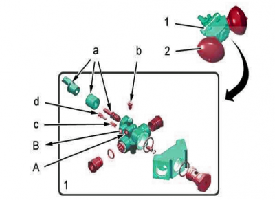

As far as the rear Firmness Regulator is concerned (as I think this is what you are interested in):
Modification of the stiffness
The suspension adapts its "firm" or "soft" statuses in relation to the following parameters:
N.B.: The "sport" mode can be "forced" by pressing the "sport" mode button, or can be determined by the system in relation to the style of driving.
"A" : High pressure inlet (Integrated BHI ).
"B" : Return to the reservoir (Integrated BHI ).
(1) Rear firmness regulator.
(2) Rear stiffener regulator accumulator.
"a" Variable firmness electrovalve.
"b" Bleed screw(s) .
"c" Return spring.
"d" Hydraulic isolation slide valve.
Role
The rear firmness regulator permits modification and regulation of the firmness of the suspension on the rear axle.

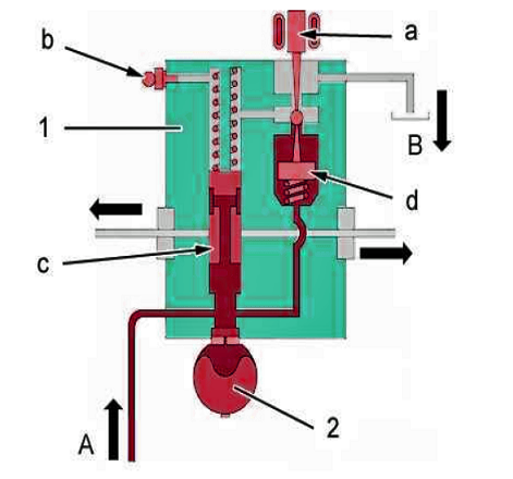

Function
Operating statuses of the rear firmness regulator:
"b" bleed screw(s) .
"c" Hydraulic isolation slide valve.
"d" Electrovalve slide valve.
Soft status:
N.B.: The body height can be regulated in "soft status" operation.

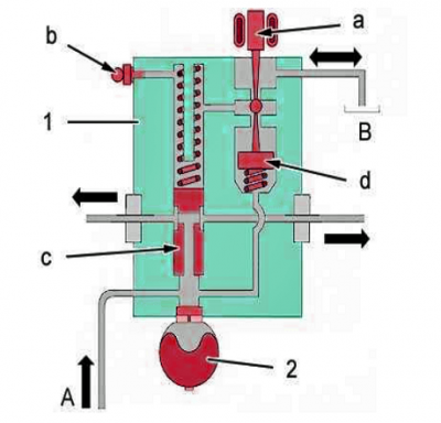

Firm Status
Firm status:
Allocation of the channels of the 2-way connector
BHI Role
- The electropump unit and its electrovalves
- The stiffness regulator electrovalves
- The vehicle ride height
- The stiffness

Role
Function
- Soft status: All of the suspension accumulators are in communication; the overall volume of nitrogen used is the maximum
- Firm status: The firmness regulator accumulators are isolated from the suspension; the suspension accumulators work autonomously with the suspension cylinders; the firmness is maximum and reduces body movement, roll and pitch
Soft status:
- The electrovalve is not supplied
- The electrovalve slide valve "d" moves under the effect of the integrated hydroelectronic block supply pressure
- The return to the hydraulic fluid reservoir is blocked : The pressure under the lower part of the hydraulic isolation slide valve is identical to that of the BHI
- The upper part of the hydraulic isolation slide valve is identical to that of the BHI : The slide ("c") moves under the action of the integral spring
- Flow of hydraulic fluid between the right hand and left hand suspension is possible : The hydractive 3+ sphere communicates with the suspension circuit
Firm Status
Firm status:
- The electrovalve is supplied
- The electrovalve slide valve "d" moves and frees up the return to the reservoir and blocks the hydraulic supply from the integrated hydroelectronic block
- The bottom part of the slide ("c") is at the pressure of the hydraulic fluid reservoir
- The upper part of the slide valve is under pressure from the hydractive sphere 3+
- The difference in the pressure at each end of the slide ("c") causes its movement
- In its new position the slide ("c") blocks the passage of hydraulic fluid between the RH suspension and the LH suspension
- The hydractive 3+ sphere is isolated from the suspension circuit

But when the centre spheres switch out EVs go ON not off. When EVs go ON or the piston sticks to rust and stays ON , it will not be possible to lift and lower the car, because the LDS cannot flow through solenoid. When the piston sticks to rust and stays permanent off, the car will tilt too much in corners. Is this correct or I don't understand it correctly? Thanks for answerwhite exec wrote: 24 Oct 2021, 08:22 Glad to hear you've got a comfortable ride back again.

The centre spheres are isolated from the hydraulic system when there is no supply to the EVs (and monitoring LEDs will be off). When the EVs are powered up, the system goes to Soft (centre spheres now in hydraulic circuit) and the LEDs will illuminate.

This is how it works on hydractiv H2 (XM). The center spheres (soft ride) are connected via voltage on the solenoid. It is exactly the opposite with hydractiv H3+. The car is soft all the time and when the conditions are met, the tension disconnects the center spheres to harden the car. When the solenoid goes bad (nothing happens under voltage) the car will still be soft. When the solenoid is stuck in hard mode (the solenoid does not return to normal position when the voltage is turned off), the car will not lift up and down.white exec wrote: 31 Oct 2021, 20:52 The centre spheres are isolated from the hydraulic system when there is no supply to the EVs (and monitoring LEDs will be off). When the EVs are powered up, the system goes to Soft (centre spheres now in hydraulic circuit) and the LEDs will illuminate.
