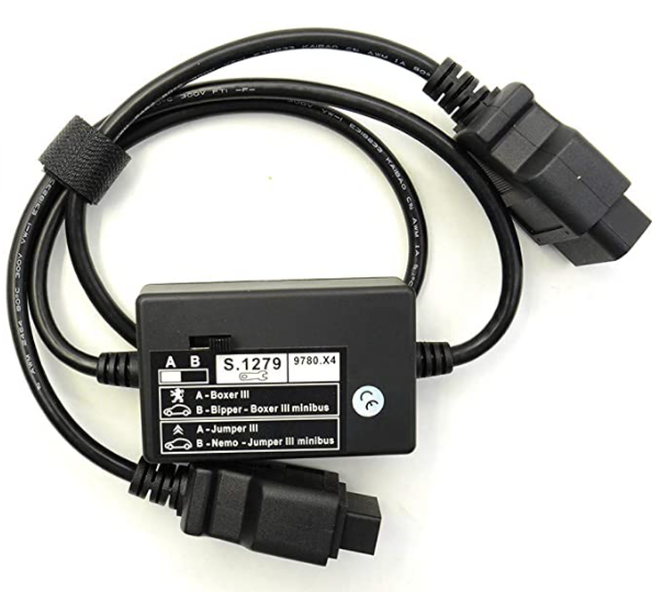

I have a campervan based on a 2015 Boxer 3 and after experiencing an ECU issue compounded with current unavailability of micro chips/processors in the motor industry, thought that I needed to perform my own diagnostics on the vehicle. I bought a lexia 3 interface VCI from a very reputable supplier who I have complete confidence in together with his products.
My big problem came when I found that I had to obtain a S1279 module to connect between the VCI and vehicle in order to provide handshake connection. Unfortunately my VCI supplier no longer sells them due to inconsistent quality issues so ebay was an alternative.
There are loads sellers of S1279 module and I took pot luck and bought one. After connecting VCI to S1279 to vehicle and performed a global scan only 3 ECUs on the K Line could be read (but did display incorrect faults) and no communication with any ECUs on the CAN network.
It appears that this is not an uncommon result and highlights a very weak link in the ability to use Lexia 3 VCIs to scan Boxer3 and it's Citroen Relay stable mate.
If any readers have any solutions (excluding purchase of dealer S1279) or can recommend a reputable S1279 supplier, I will be very grateful of your advice.

Does anyone know exactly what is inside an S1279 module? Is it a simple mapping of one pin in the plug end to a different one in the socket end or is there a circuit board with active electronics inside?

It obviously does some switching for the FIAT based vehicles - but I doubt very much it is just a matter of switching pins only, because the Chinese clones of these units notoriously fail more often than work. I think an original Actia version is a tad under £200.

Anyone with an S1279 module care to open it up and take a few photos for the benefit of us all?
