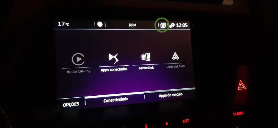

Seen this guy on Peugeot forum talking about receiving notifications for incoming SMS and e-mails on his NAC Wave2 in P308.
At an incoming message this circuled "page" flashes green (like when you have a major engine fault). You can't answer the mail/SMS from there, as it serves as notification only.
Tried to set the same in my DS5 with retrofitted NAC Wave2 (upgrade from SMEG+IV2), but sadly to no avail!

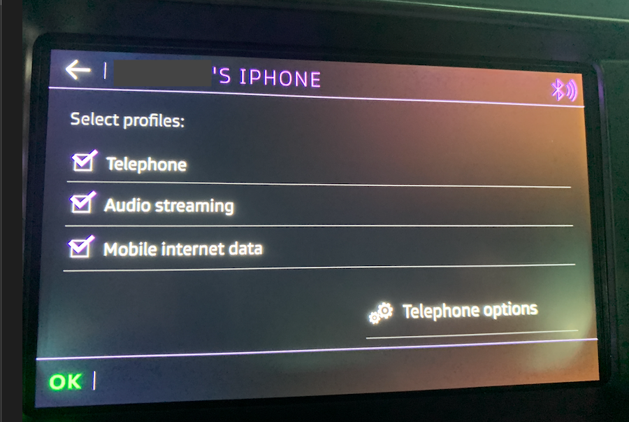

In fact; I don't even have that option to set in Telephone menu on NAC. The guy in Peugeot forum mentioned he has a tab with e-mail to set on his Wave2, but that's a P3008. It seems I don't even have that option on my DS5. Thought someone on any Citroen / DS car might have it though?

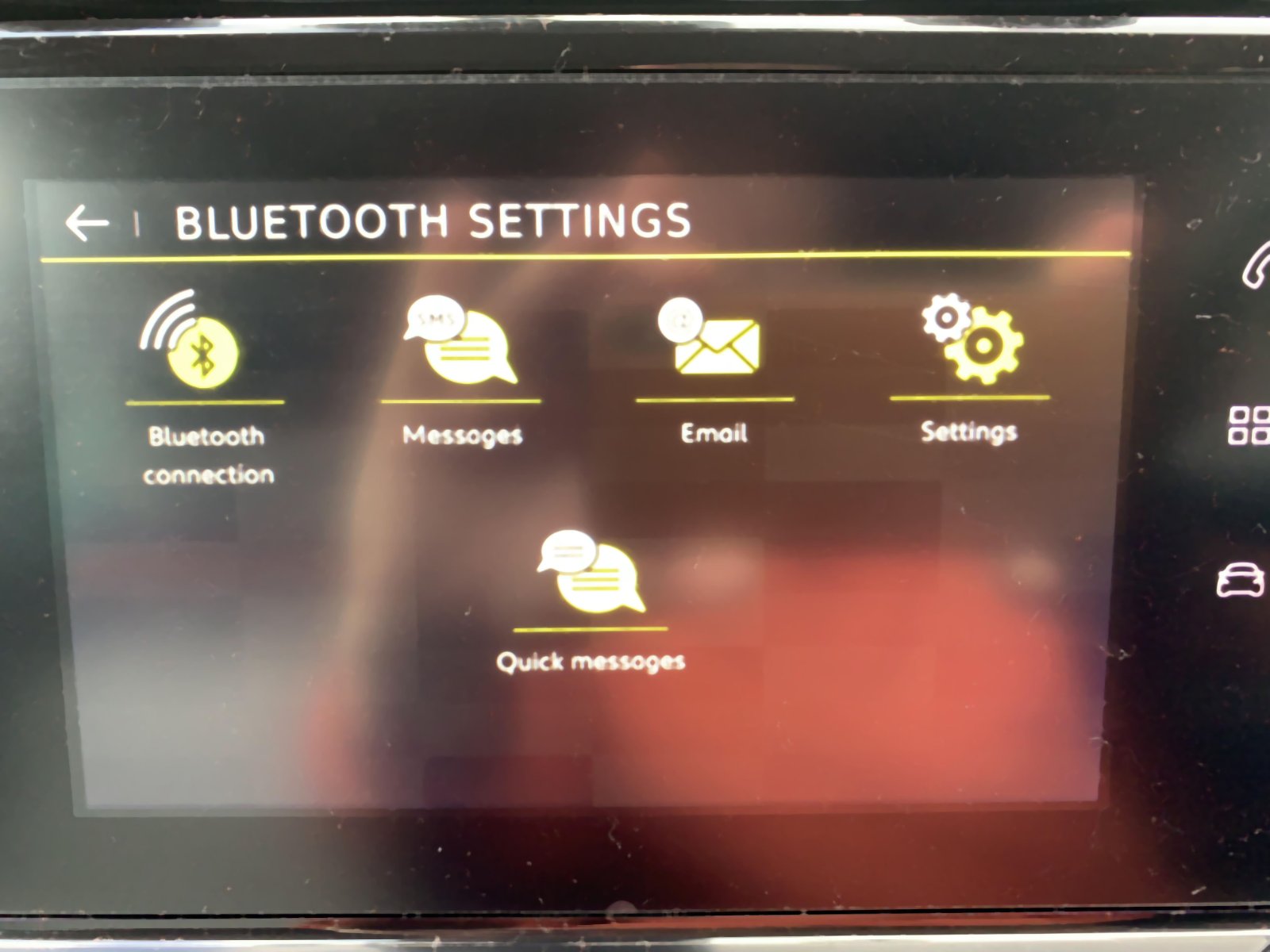

So I have SMS messages coming through as you can see and an email setting showing up - but I don't get any emails showing - so it may be to do with data settings and whether you allow mobile data for certain apps and whether Low Data mode is on or not, or even if you have a WiFi hot spot setup via your mobile or not.
However it doesn't bother me, as I get hundreds a day, so would prefer them not to come through!

Re: Notifications on NAC Wave2?
Thanks a lot for your input!
Now, the e-Mail and Messages part in Telephone settings is absent in my DS5! Wonder if it could be configured with Diagbox?
From which car you’ve taken these photos?
I assume it was a Wave2 as well? Also paired with an iPhone or Android phone?
Hi
It's from my 2020 C3 Aircross with NAC Wave 2 Digital Connected Nav running latest system software with onboard WiFi and also separate independent telematic unit for Assistance and SOS calling.
I paired it with Bluetooth only (as I've only just got a new iPhone XS Max yesterday) and had not connected it via Bluetooth until I went out today to do this for you. So iPhone connected.
There won't be anything in Diagbox you can do as these are secured and protected units as far as I can see and there are no settings like this that can be configured anyway from what I've seen - functionality is pre-built into the units (probably the reason why there are so many versions )
Thank you Marc for this valuable information!
Now, the iPhone thing is excluded, since it works for you, but not for me. Something else must be the reason for the absence of Messages and e-Mail settings on my NAC...
The only difference that comes to my mind are Connected Services (not available in my country), but I don't see what should personal SMS and e-Mails got anything to do with TomTom Servioces?
They certainly don't go through TomTom servers but are directly transferred from a connected moblie phone (I suppose).
Nor should they have anything to do with somewhat older BSI (my DS5 is mid 2105 and retrofitted NAC is 06/2018).
Also the source of Internet connection shouldn't make any difference (my NAC is connected through iPhone) as long as Internet connections is active and stable.
