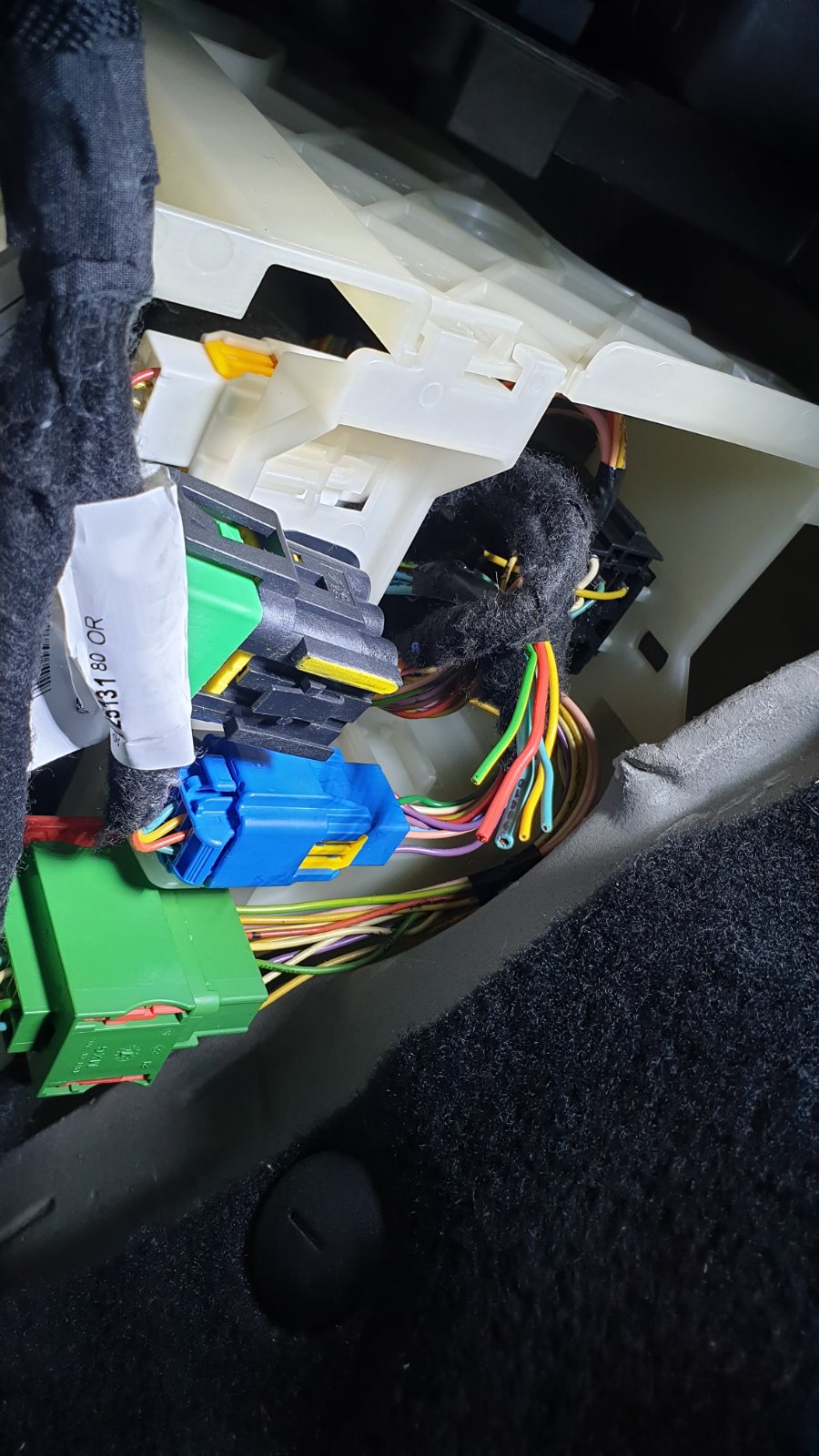

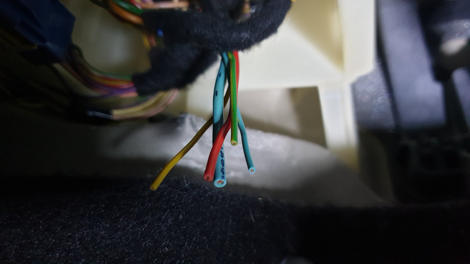

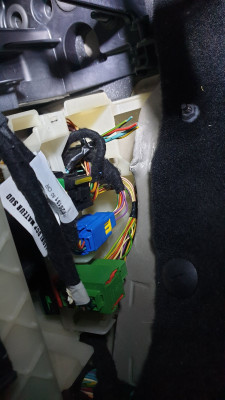

2nd thing is, that during the fuse check I found cuted cables near the fuses box (you can see it when upper feet cover is off) - does somebody know were they should be connected to? Might it be the reason for communiation problems?

The 4 thinner wires are spare repair wires found on many Citroen models, totally normal & the other ends of them can be found underneath the under bonnet fusebox.
Not sure about the thicker Blue one though.

I tried my friend's interface and everything worked well, so it seems that my cable is broken.. Thank you for help!
Nice to hear that cut wires are factory made:P
