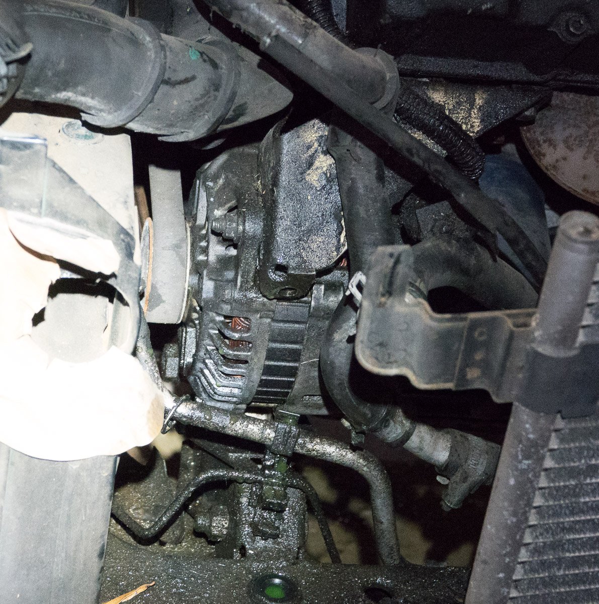

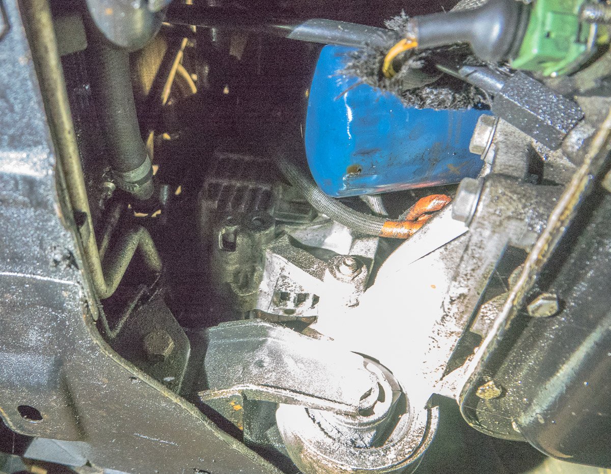

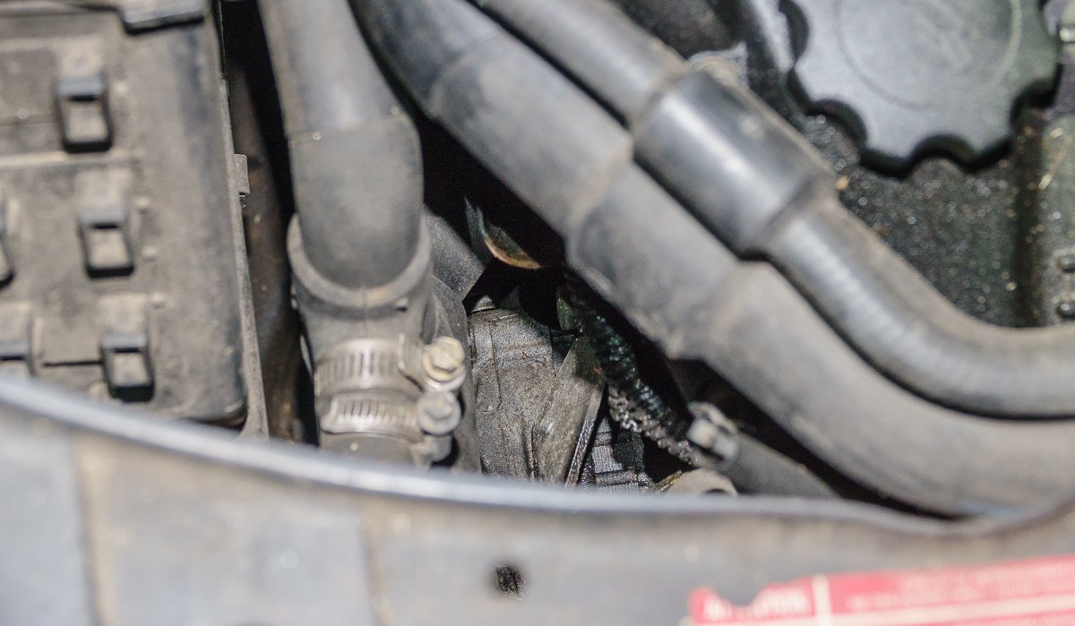

Ah yes - "if you can get at them"! Following are a couple of photos of a 605 alternator in situ - no doubt an XM is worse!moizeau wrote: 17 Oct 2021, 16:30 I'd still suggest to try a brush pack. Changed mine at 140000 miles, in situ, 5 mins. It lasted until the car got scrapped, did the same with my 1st BX at 200000 miles and it again outlasted the car that got scrapped at 450000. For 20 squid and 15 mins tops (if you can get at them) it's got to be worth a go.
Firstly - from above. Yes that is a little bit of alternator visible (more or less in focus, but partly hidden by a bracket) between the hoses.
Secondly from below - access is a bit better.
I think removal will be my best policy - but that looks like a nose cone off and radiator out job. And before anyone explains that my alternator has obviously failed due to getting oil dripped on it - the photos are of a spare car. I did initially consider just using it, but it probably wouldn't last long, as it is oily...

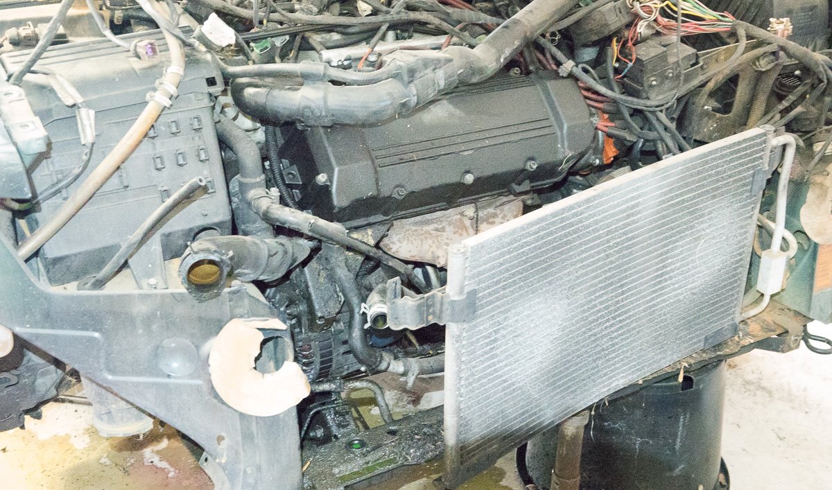

OK, some progress (on the spare parts car). "Nose cone" off, and radiator out.
Now I can see and touch!

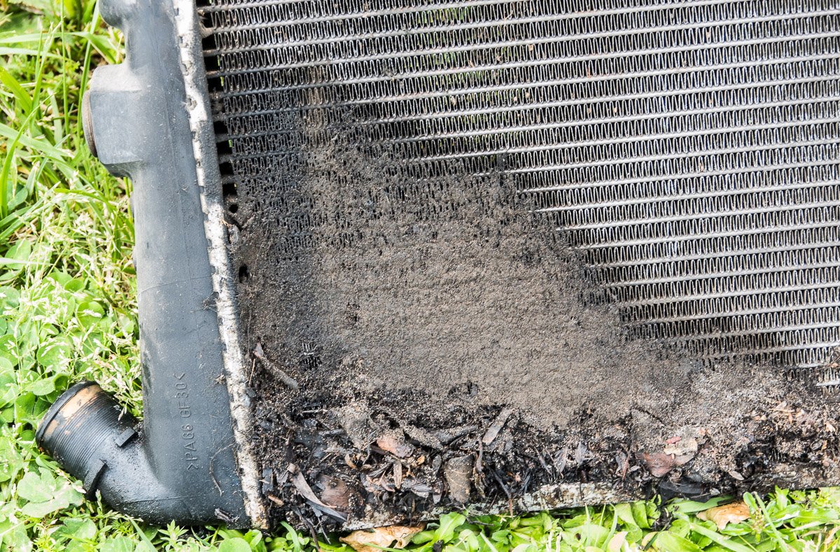

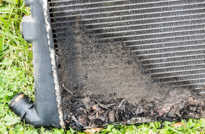

No-one's been in here for while - there were handfuls of oily leaves jammed under the radiator and between the condenser and radiator. One the plus side - there's no rust!

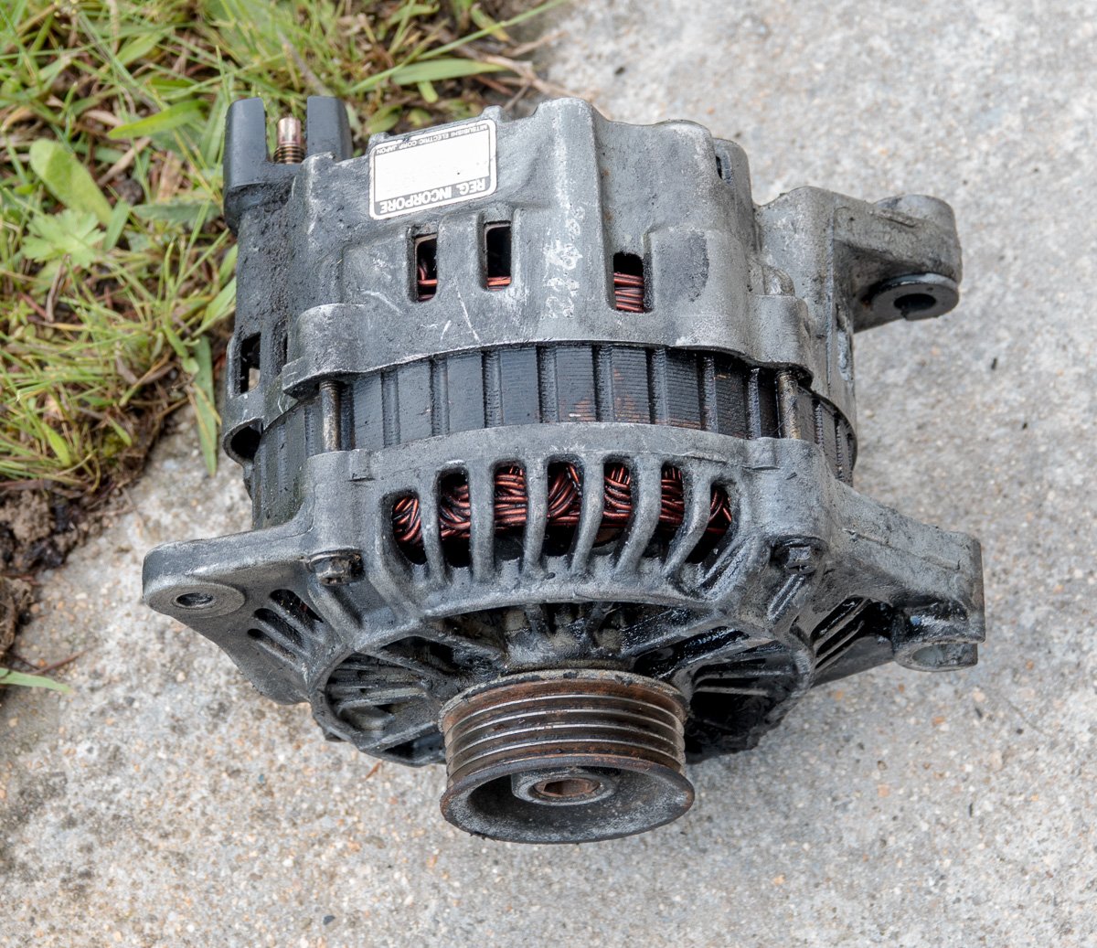

Alternator out

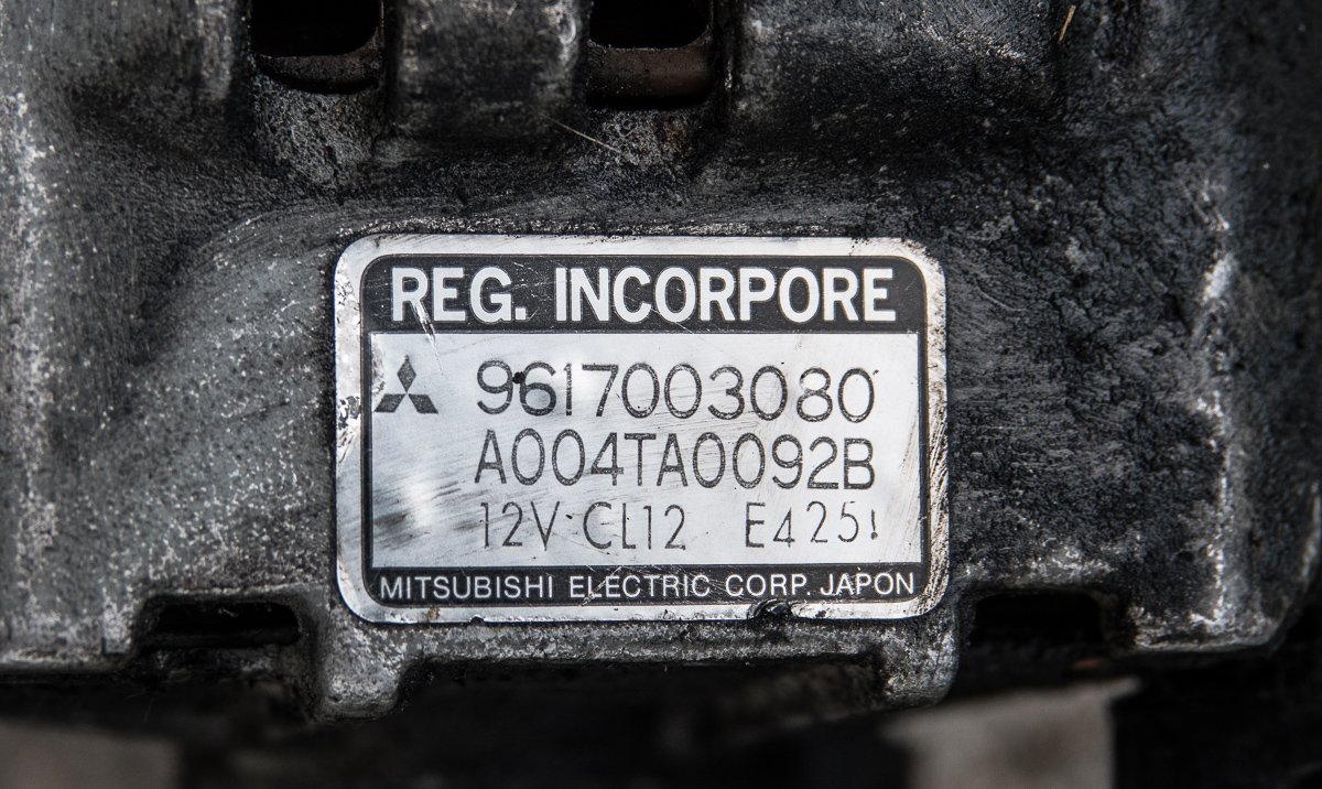

It's a Mitsubishi, and has a similar number to one that appears on the catcar.info page - A004TA0092. However mine has a 'B' on the end - presumably not significant. Anyway, main thing is it appears to be a 120 amp model (not just a wussy 90 or amp model).
Well it's not the original alternator!

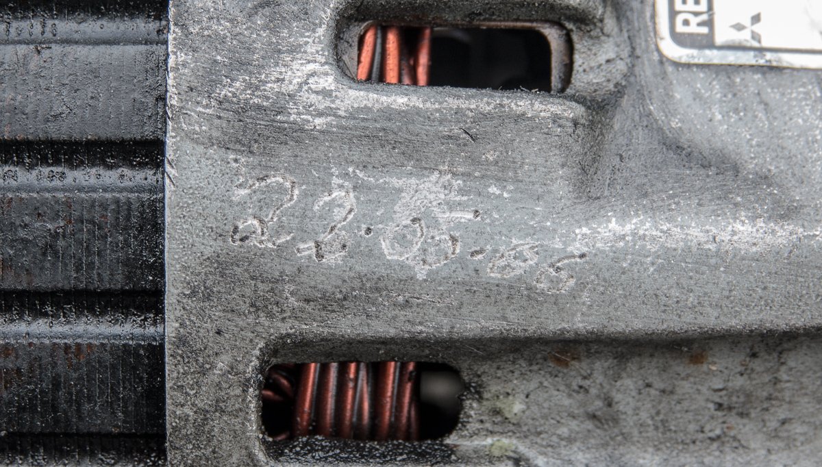

Probably 2nd hand when fitted (22-05-06), but might be less than 26 years old! The date scratched into the casing falls in between the last couple of stamps in the service record, indicating that it was fitted when the car had traveled about 165,000 km (speedo now shows 224,000km).
So will definitely take it to local auto sparky, in the hope that it might be significantly less than 26 years old. Bearings feel fine BTW.

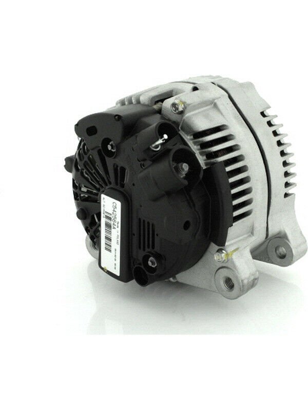

Embarrassed that I didn't take any photos of the rear of the thing, and it's remarkably difficult to find a clear photo of the connectors for an equivalent alternator. This is the best I could do:
I can just distinguish the 'B' label on the larger post. Can't see it on this one, but on mine the small one is apparently labelled 'A'. It really couldn't be simpler could it - it seems over-engineered when other alternators use spade connectors, but the 'A' post can only be for the exciter wire.
