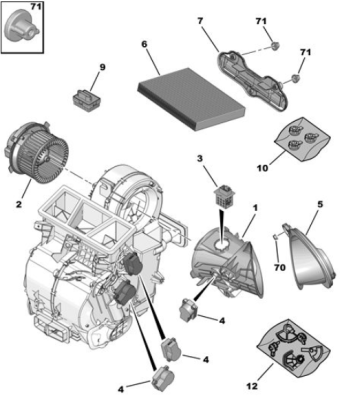

Also, don't forget the blower motor resistor can fail on these. Some have the resistor built onto the blower moto itself - they look like a half horseshoe. When these go they work at either full blast or not at all.
And here a video on replacing them:
