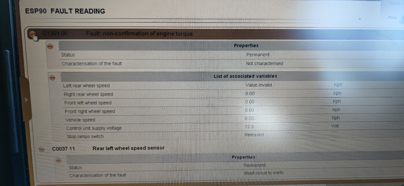

Im getting the Abs/ESR fault along with hill start, parking brake etc
Lexia scan gives me these fault codes C1391 00 & C0037 11.
My vin is VF7**************[VIN obfuscated, can be read by forum staff] Its a 2014 C4 Grand picasso (B78)

Ok, so C003711 refers to the rear left wheel speed sensor. There's a short circuit to earth.
When this fault is active, then it will deactivate a lot of ESP functionality, such as the ABS, ESP (including all traction control functions), Tyre pressure monitoring, Hill Start, Emergency Braking Assistance, Stop & Start system, and Semi-Automatic Parking if fitted). So that is why you will have all these errors.
Your suspect is the rear left wheel speed sensor of course, or the connections to and from it or the actual ESP ECU.
The other fault C139100 is a generic fault of the ESP ECU and that can be caused by the same speed sensor fault above. So I would focus on the rear left speed sensor first of all and once you've sorted that out, the other fault should also disappear. So just be aware of the deactivation of the said safety systems - as you'll have no ABS and no ESP.

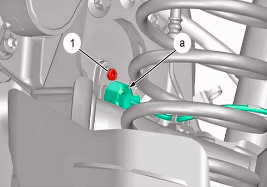

Ok, so here's how to replace the rear wheel speed sensor:
Lift and support the vehicle.
When refitting, avoid impacts to the head of the rear wheel sensor.
Tightening Torque of the Rear Speed sensor bolt is 1 daNm
Then run another Global Test and clear the fault codes.
| Disconnect the connector (at "a"). Remove the bolt (1) of the rear wheel speed sensor. | Remove the rear wheel speed sensor (2). |
