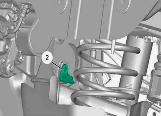

Ok, so here's how to replace the rear wheel speed sensor:
Lift and support the vehicle.
Disconnect the connector (at "a").
Remove the bolt (1) of the rear wheel speed sensor.
Remove the rear wheel speed sensor (2).
When refitting, avoid impacts to the head of the rear wheel sensor.
Tightening Torque of the Rear Speed sensor bolt is 1 daNm
Then run another Global Test and clear the fault codes.
