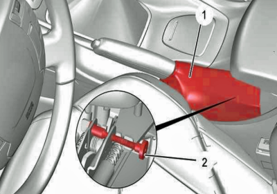

Re: 2008 c5 handbrake adjustment
Ok, a manual handbrake on a system without hydraulic suspension.
Check
Raise and support the vehicle, with the rear wheels hanging free.
Check that pad friction begins to occur from the first notch.
Check that the normal travel of use does not exceed 4 notches.
If the checks are not correct:
CAUTION: The main brake circuit must be bled.
Unclip the handbrake lever gaiter (1).
Position the handbrake lever at rest.
Action the integrated automatic adjustment unlocking button (2).
Depress the brake pedal several times.
Pull the parking brake lever on normally about ten times.
Check the effectiveness of the handbrake.
Check that the handbrake warning light comes on from the 1st notch of the total travel of the lever.
With the handbrake released, check that the wheels can be turned freely by hand.
Refit the handbrake lever gaiter (1).
Check
- Check that all the cables are routed correctly (Parking brake)
- Check that the cables are not constrained (incorrect hooking of inner or outer cables, incorrect adjustment)
- Check that all the parking brake control components slide or move freely
- Adjust the parking brake
