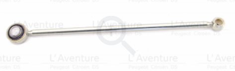

Is it the gear shift rod you need?
If so, these are available from Citroen Classic Parts for around 32 Euros.

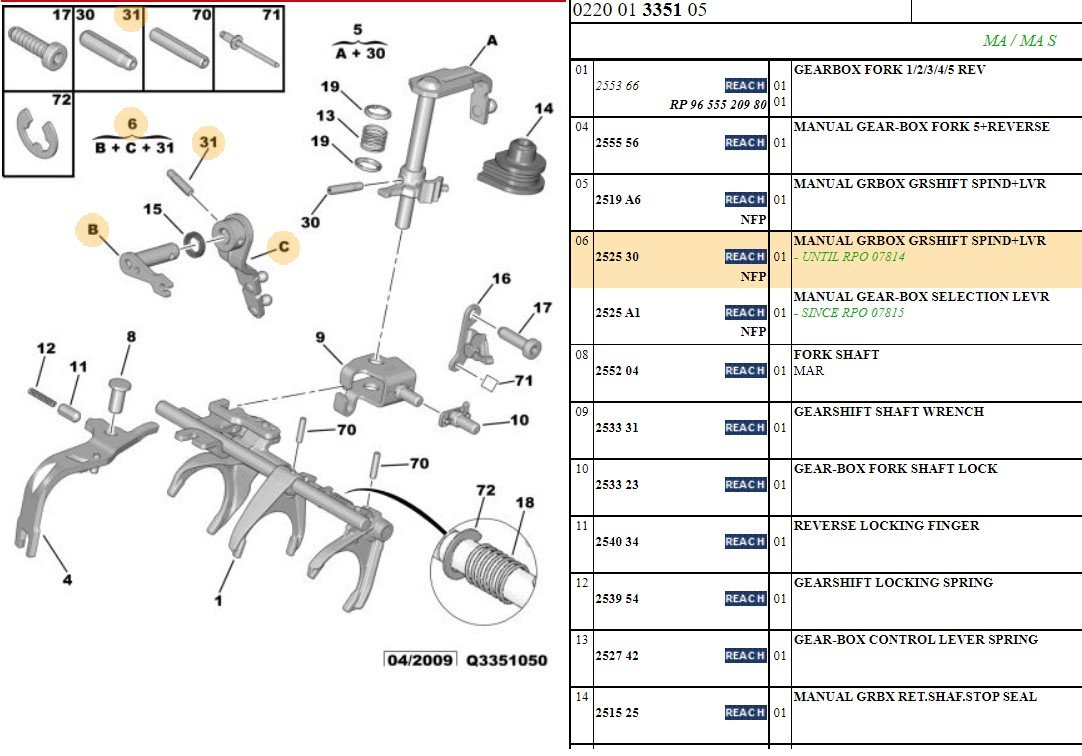

Im guessing its part C? The pin (31) works loose over time & if you ignore the sloppy gear change it can cause the pin hole to go oval.

wheeler wrote: 09 Oct 2021, 10:16 Im guessing its part C? The pin (31) works loose over time & if you ignore the sloppy gear change it can cause the pin hole to go oval.
Yeah thats the one i need but mine only has 1 ball on it not two. Cant find any new ones mine has become oval and new pin will not solve the problem
