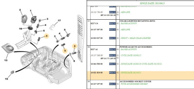

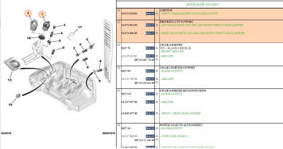

Re: New Citroen Relay missing bits
The front & rear are the same but there are a few choices depending on build date.
Here you goLittleOldSuzi wrote: 07 Oct 2021, 05:58 Thanks for that, perfect. The van is brand new, 4 months delivery time and it has less kit on it than the 7 year old one LOL.
1 & 2 could be really useful if they are not silly money. Can you post a pic with their part numbers showing? Thanks again.

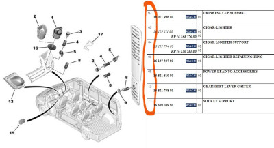

A "Mid-life drinking cup support" . . .
Well, that everything catered for!

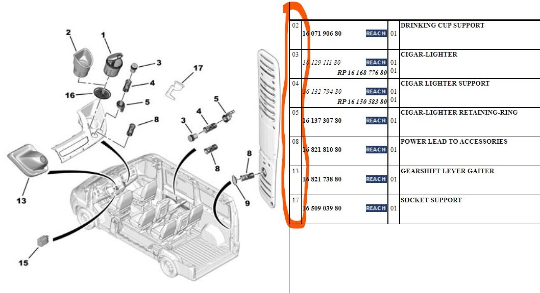

Well, that is unhelpful from Citroen. That part (16 821 810 80) is not yet commercialised and it could be months so I can't buy it. Let's hope the only 12v socket they did fit to the van doesn't break.
Out of interest the lad that checked insists the build data for my van says it has a socket by the back door but it is missing on my van. Are they so short of parts they are missing bits off to get the vans out the door? Can someone double check if I PM them my VIN?

- x 1746
16 827...... may not be available, but 8227.A1 is.
It is the same part, and the original/main pt.no.
The cigar lighters (power sockets) are likely to be pretty generic items, so you'd be able to find plenty on the web.

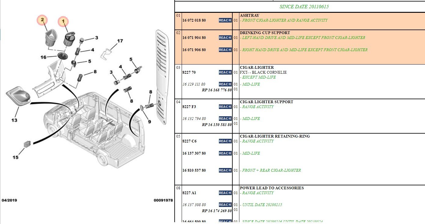

In theory if it's listed in the highlighted column then it should be fitted to the vehicle. Its not always 100% gospel though & there can be mistakes in it.
This is based on your VIN.
Thanks Wheeler, I am going to try Fiat tomorrow and see if they can supply the 12v outlet of the Ducato which will be the same part. As well as the 12v outlet (8) by the back door being missing the cigar lighter (3, 4 & 5) is also missing. I am pretty sure they are desperately short of parts and missing none essential bits off. Ah well, I will source them somehow...
