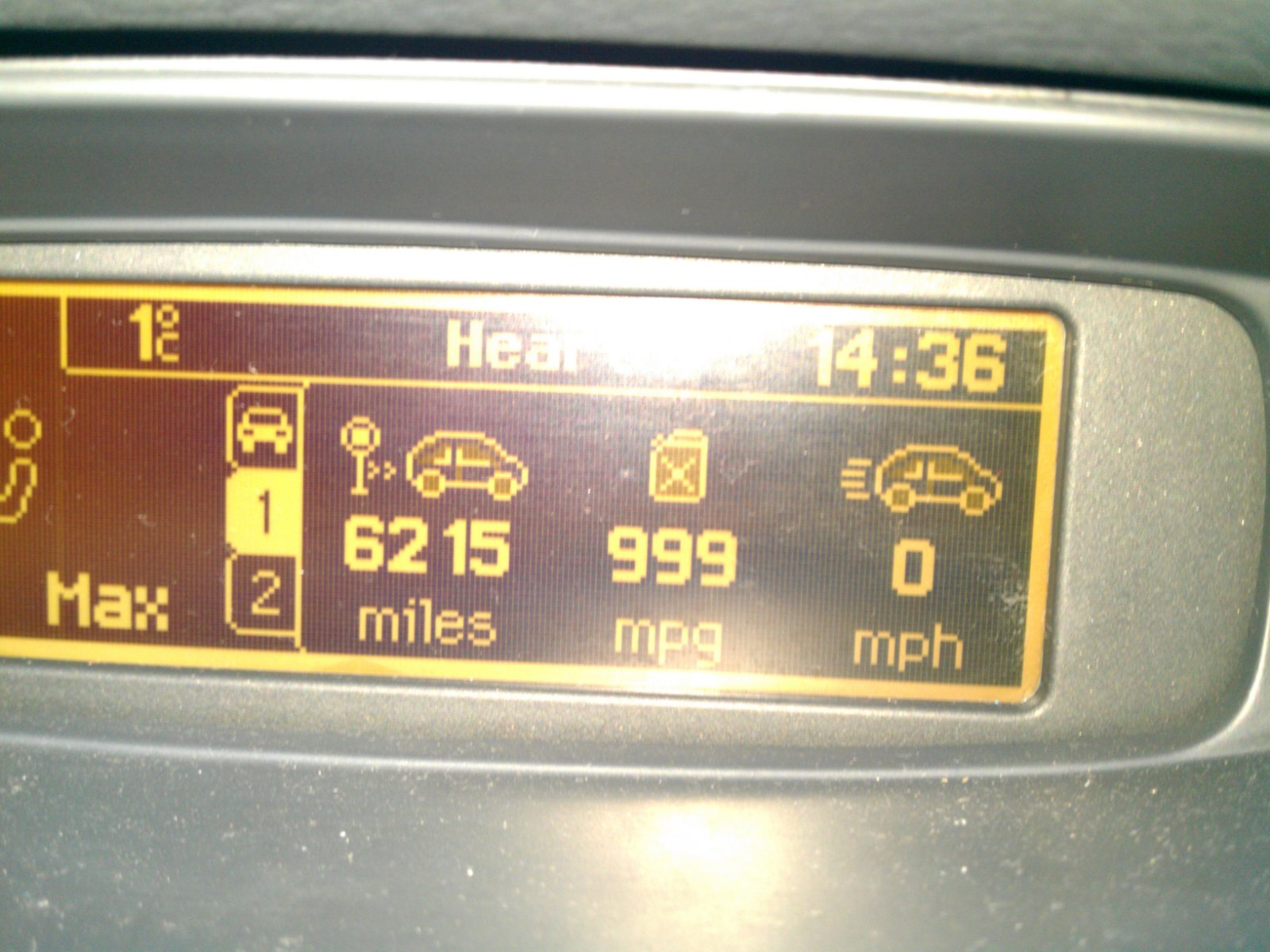

I have noticed the fuelling estimates vary accordingly. ie, at overnight-cold start-up the range may be optimistic due to the overall average MPG counter, but as it's initially running rich both MPG and ranges do get quickly downgraded and once the engine's warmed up and some miles into the journey it will begin increasing the figures again.
I do think it's therefore more accurate than you're giving it credit for but of course, it's not infallable and if you don't follow the instructions, may lead to malfunctions. I've caused the display to glitch or even stall after using Diagbox for instance. But a counter reset will clear it.

right guys,
I have done only 66 miles,Guess what the fuel gauge has jumped up to FULL.Yahooo...
Was thinking it would have to do about 200 miles before it got it into its head to change to the proper reading.. top up up Very Pleased it is reading correctly now,BUT Will take onboard thet small amount of fuel BELOW £25:00 Will throw it a WOBBLY.

Out of curiosity was the very detailed explanation by GiveMeABreak right.
Asking for a friend who just topped up 9 litres because of a very long road trip tomorrow and people panic buying scaring him in case he gets stranded. His gauge never registered the fill but neither did his range reading.

I had the same issue a while ago on a DS3.
I was returning the car at the end of a contract so didn’t want to leave too much fuel in the car. However I either underestimated, or drove too fast ! and got worried I might not get to my destination. So I stopped and put in about £20 of fuel.
Estimated range and fuel gauge remained the same and I thought fuel station’s pumps were faulty so, a few miles later stopped and put another £20 in. Suddenly had a half full tank and a couple of hundred miles of range !

If you're referring to my technical post on the previous page - yes that is correct - but was specifically for the original poster's Xsara Picasso on how the system reads the fuel. It may not be the same for your mate's vehicle.RichieW wrote: 04 Oct 2021, 21:12 Out of curiosity was the very detailed explanation by GiveMeABreak right.
I just asked him and he brimmed it too.
Let's call him Frank.
The gauge can get stuck for several reasons - the sender needle can stick or break, so this can be the cause if the gauge stays more or less at the same position regardless of the fuel level in the tank.
On other occasions it can just throw a glitch and will sort itself out after a few journeys / fill ups/.

Hello all. Topped up with £50 today. Happy days the gauge is back to all lit up and the range reset to 870.
So yes, after letting it go down to below half, the problem rectified itself.

No problems, mine is exhibiting the same behaviour since last week - and I haven't allowed it to get under half a tank because of the current forecourt delivery issues. So now things are getting back to normal here, at least, I'll be running mine down to about a quarter of a tank and then filling her back up again to the third click. That should sort it.
