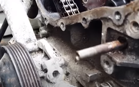

This afternoon has been frustrating.
On the plus side, Motorserv reckon I should have a head gasket and inlet manifold gasket ready to collect tomorrow. Hopefully they'll have more luck than Mercedes themselves or the specialist I was trying to order from before.
Fat lot of good it will do me though as the head is still attached to the car.
I've just wasted the best part of two hours trying to get the pin that holds the timing chain guide out.
This pin, which is helpfully drilled and tapped with an M6 thread.
Should in theory just pull out, using a nut and bolt as an improvised puller seems to be a popular method.
Yeah...even using the best quality M6 nut and bolt I could find (the ones in the photo were purely to show how things fit together) just ended up mangling the threads on the bolt in one case and shearing off in another.
Basically I need to resort to a slide hammer. Unsurprisingly given this engine's history it's well glued in place. Unfortunately there's not enough space to get in with one.
So to get in there I'll need to pull out the radiator. Which means I need to disconnect the very crusty looking transmission fluid lines (the oil cooler is integrated into the bottom radiator tank). Oh, and I need to buy a slide hammer as I don't own one.
...Or just buy a new timing chain which comes with a split link...oh...but then I'd need to get the whole timing cover off. To get that off you need to remove the sump...which we've already found is a non trivial process. So I guess we keep messing around with this.
Oh, in case there was any question over whether the head needs to come off... here's a random selection of the journals the camshaft sits in...
Yep...that's had it! Has been for a long time too given the scored out areas have had time to get varnished deposits on them.

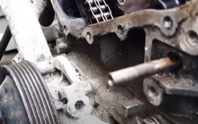

I am not sure that a slide hammer is the best tool for that job. They are best for breaking away a taper joint, but not ideal for a tight friction fit. It is not clear what you were pressing against with the nut, a spacer or socket?
- x 1751
Re: Zel's Fleet Blog - BX, Jag XJ-S, Sinclair C5, Mercedes 208D & 230TE, AC Model 70.
Could you try a length of steel, with a hole for your bolt, and lever (knock) outwards, pivoting on the metal bits below?
Get some PlusGas in there, too?

There was a spacer in there (10mm socket) when I was actually trying to remove it to ensure I was actually pushing against the head rather than the surface of the pin.

Having left the timing chain guide pins stewing in Plusgas for a few days I went back for another shot today. Armed with a few high tensile bolts and an assortment of spacers I figured this was the last chance saloon before I get more tools involved and strip things down further.
After far more torque than I would have liked was applied, the pin started to move with a terrifyingly loud crack.
It was tight all the way out (as expected given it's purely a friction fit), but didn't require stupid amounts of force once it was moving. One removed pin.
At this point I figured I would be able to withdraw the chain tensioner. Err... apparently not.
A quick consultation with the spare head showed there were actually TWO of these pins. I'd missed this one entirely.
Partly because I'd just unbolted the thermostat housing from the head and left it otherwise in situ, partly because...well...would you have spotted it under all that slime?
About 3/4 of a can of carb cleaner and some scrubbing later...hey look, there it is!
Same process as before...another pin out.
Which *finally* allowed me to get the chain guide out.

Think it's fair to say the new one is a bit healthier. Rear coolant line elbow is rather crusty on the old head too.
New one is in "considerably" better shape thankfully.
After a bit of deliberation I decided to leave the inlet manifold gasket alone and just swap the fuel distributor over. Not a big job really, only took about an hour to transfer everything over from one head to the other.
Not forgetting one of the most ridiculously overcomplicated throttle linkages I've seen in a long while.
Next steps:
[] Remove and reset timing chain tensioner.
[] Remove the remaining studs which are trapped in the exhaust manifold so they match what's present/missing on the new head.
[] Rotate engine to cyl 1 TDC so I can set the timing properly, reset distributor as necessary.
[] Clean up block and head surfaces.
[] Reassemble.
[] Flush sump out with copious amounts of diesel to get as much gunk out from there as possible.
[] Pray I've made things better than worse!
Feels like we're making progress at least...
I do at least have a head gasket in my hand now.
In other news...well there isn't any really! Just business as usual.
Hopefully we'll manage to keep up a bit of momentum on getting the Merc back together.
From the front...
Ignore any blocked looking oilways, it's just grease from when I had things in and out a bunch.
1.
2.
3.
4.
5.
Next steps:
[] Reassemble.
