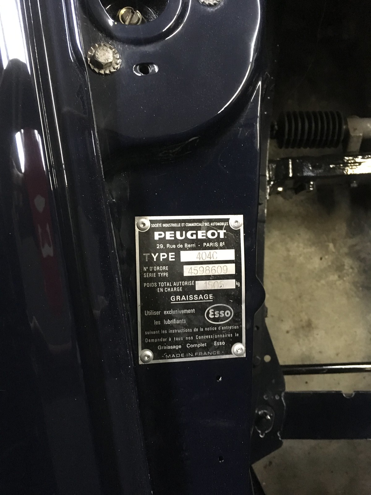

Restoring ID:
A few other items the shop painted: bumper filler panel, Carrosserie Peugeot tag (mine was the 10758th 404C ever made, of 17,223), under bumper steel spoiler, interior air intake grille.

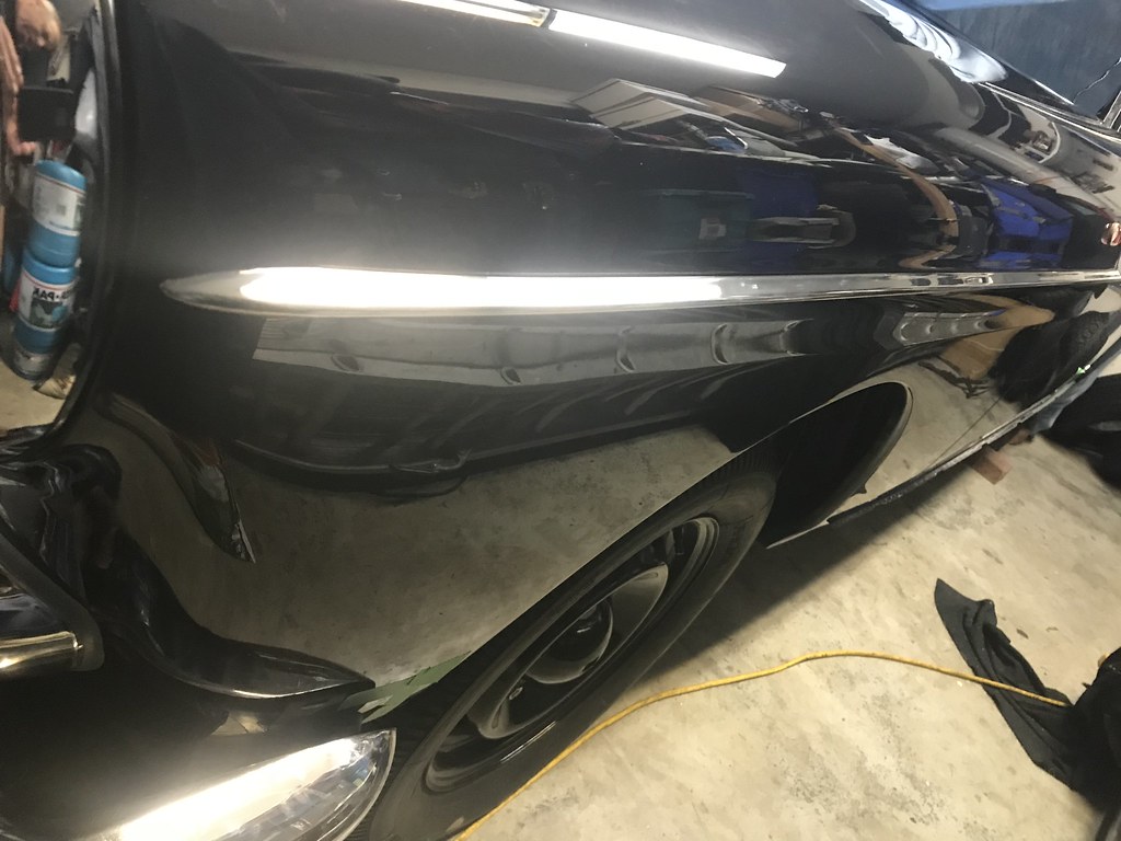

Stainless steel side trims mounted
Carrosserie Peugeot tag mounted
