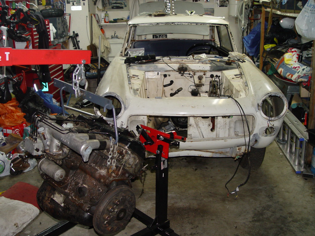

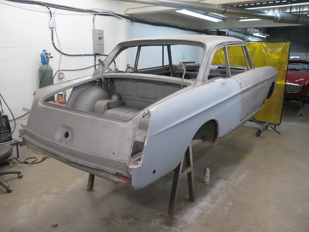

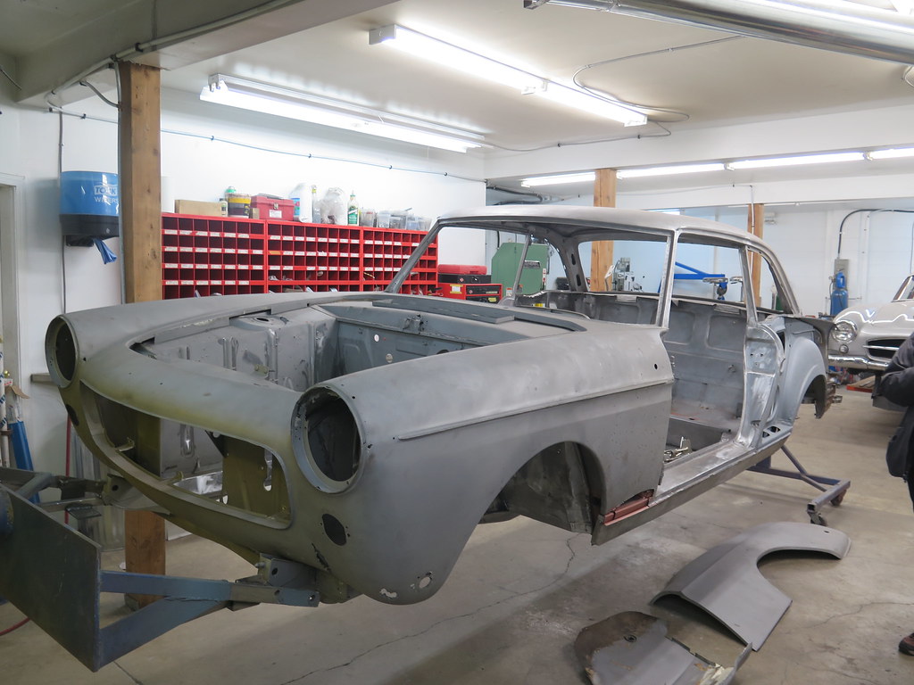

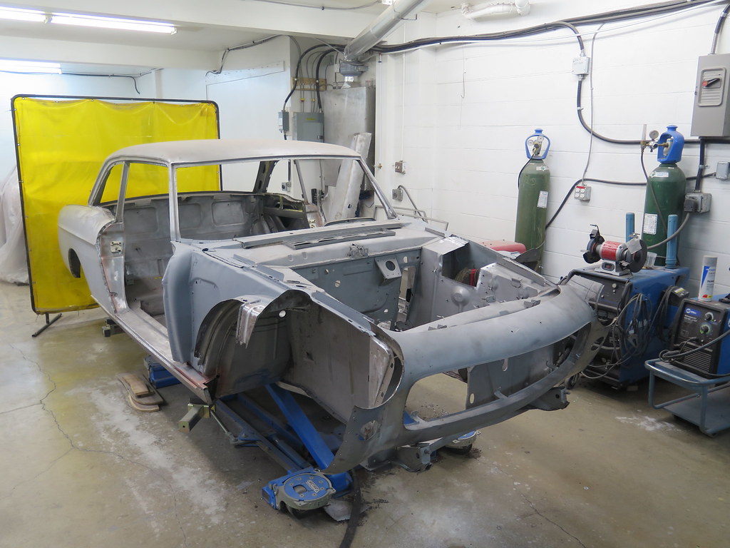

Coachwerks in Victoria BC restored the bodyshell of my 1966 Peugeot 404C Injection, number 4598609.
Note the KF2 Injection engine, now on the stand in the photo
The new old stock body panels (floors, front and rear wings, other panels, all in NOS) were dropped off at the blasting shop in November 2016.
I'll update this from time to time and eventually get it up to date.

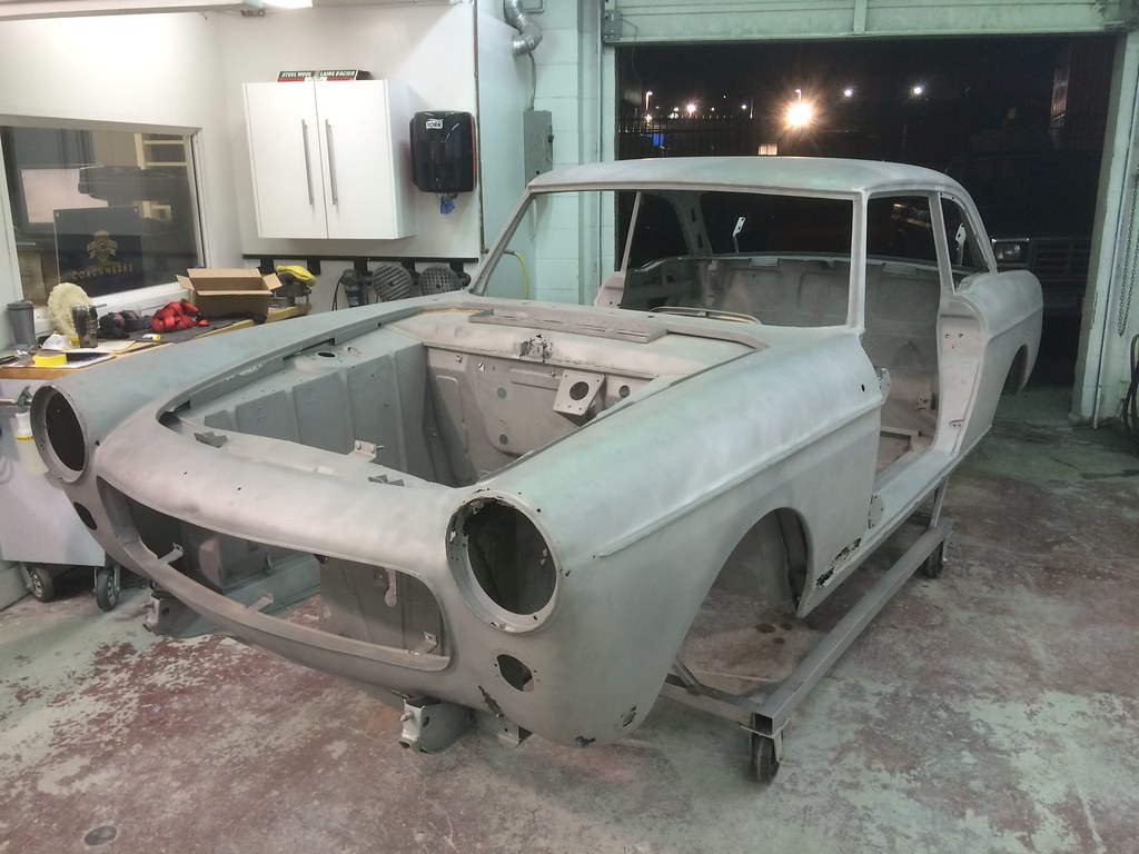

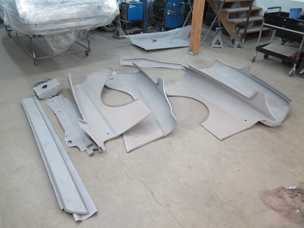

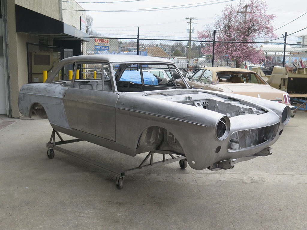

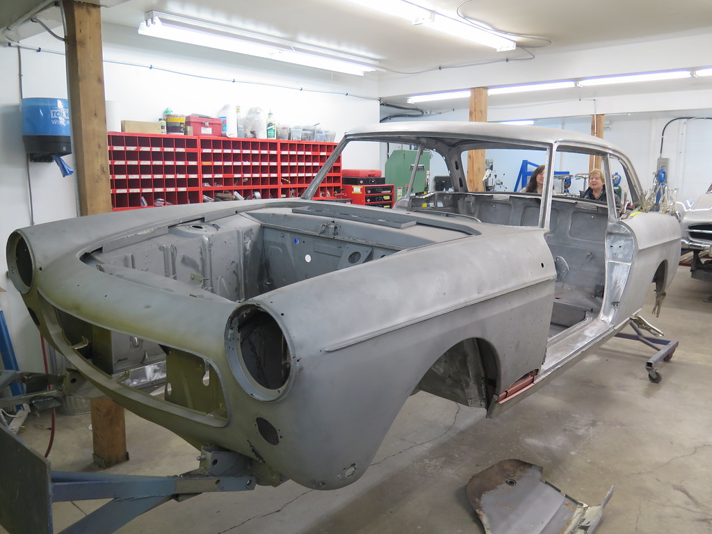

After blasting....
The NOS body panels that I had were blasted too and returned to the shop in Victoria. Two floor halves, all 4 wings, one sill, McPherson strut reinforcements, headlight rings the bucket is bolted to, among others.

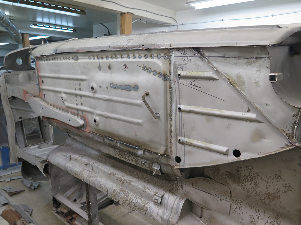

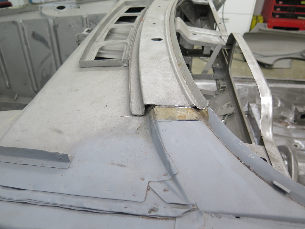

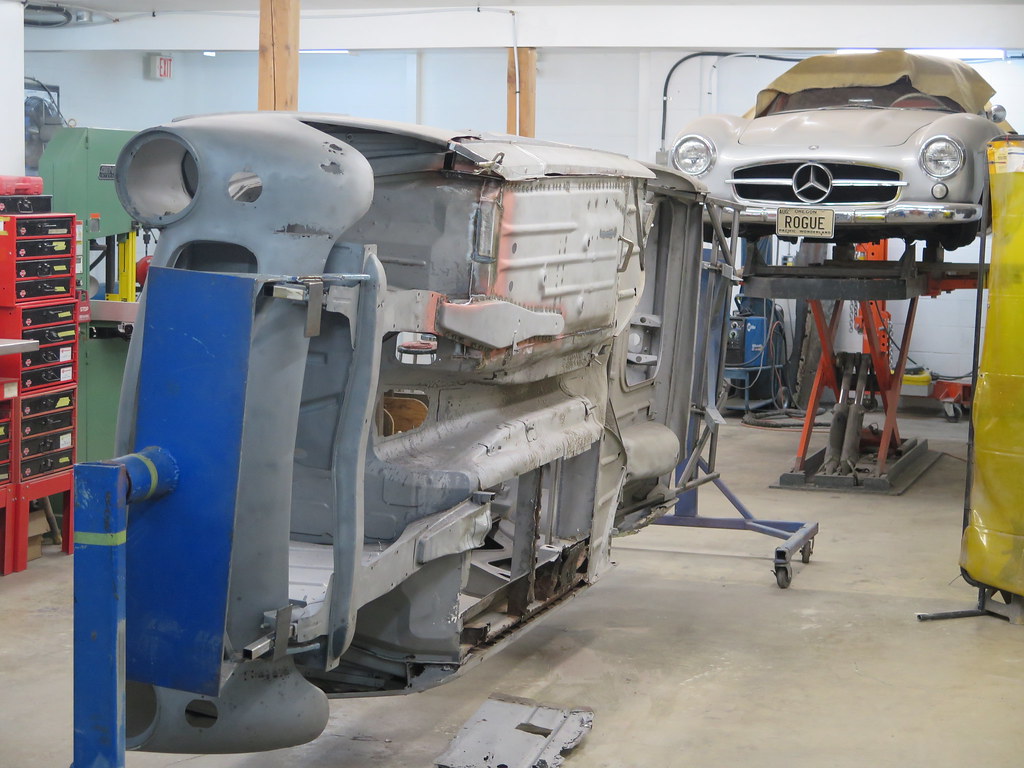

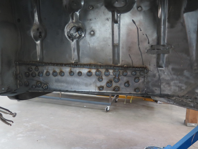

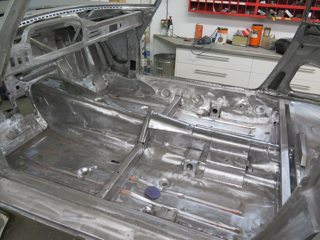

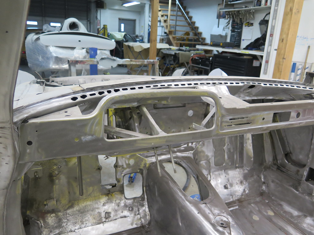

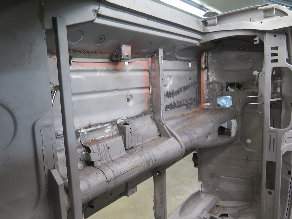

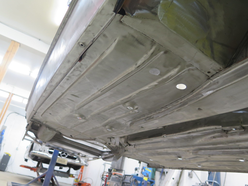

floor work commences on the rotisserie
Left front floor detail
Seen from front
Work in progress seen from inside the car.

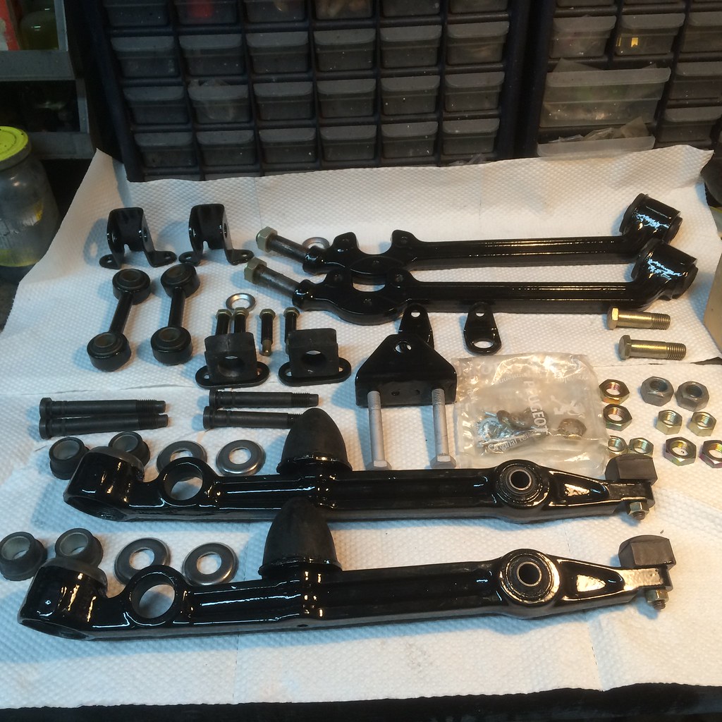

Meanwhile in early 2017 I began work on the mechanical components, with everything being replaced with Peugeot new old stock parts.

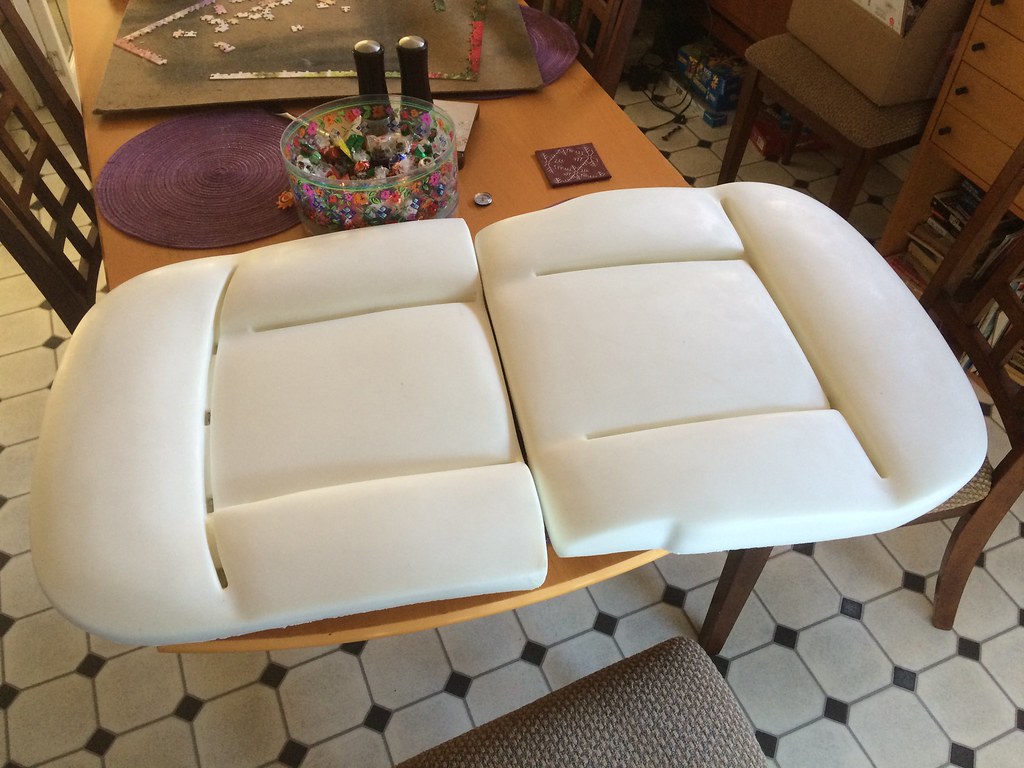

New foam for the seats. We hd heater elements installed under the leather, to be shown later....

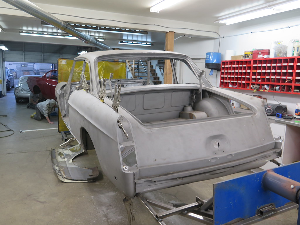

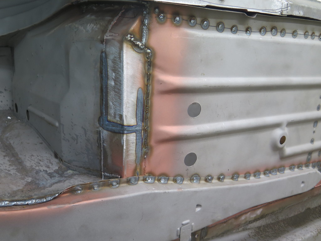

Floors were completed by the end of January 2017 and work began on the rear end.Image

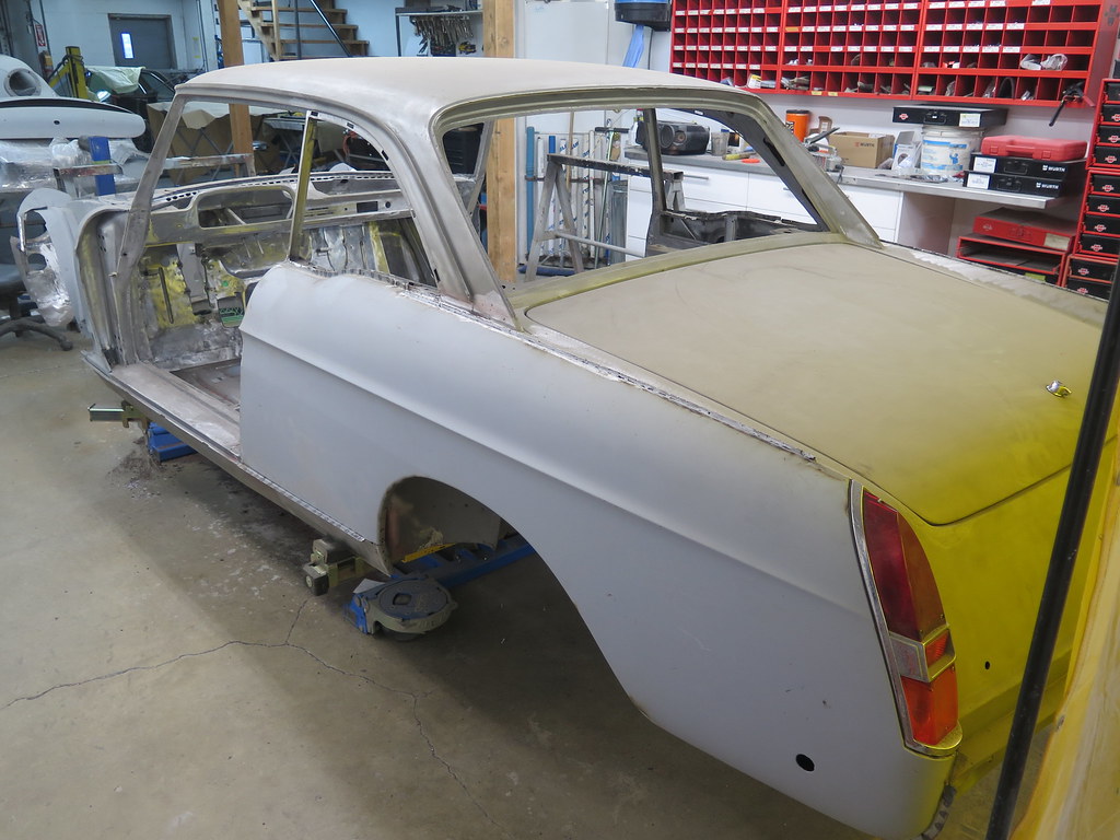

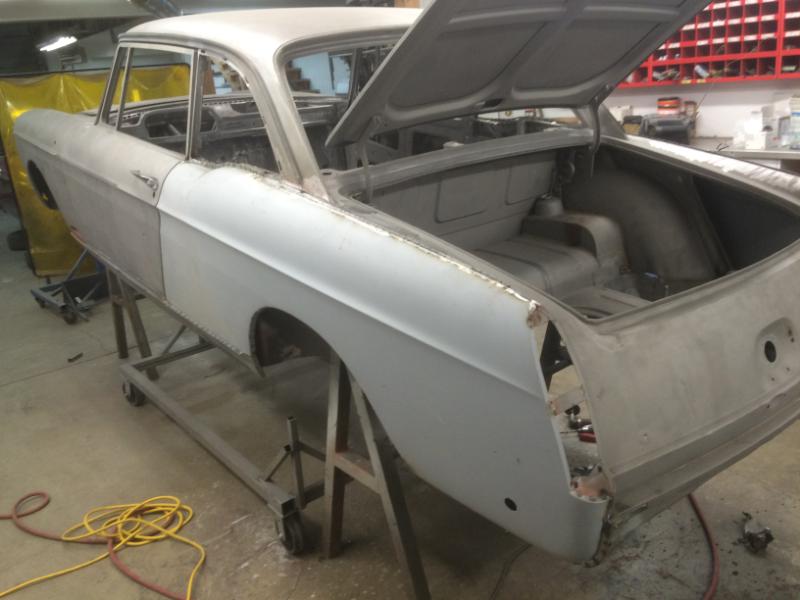

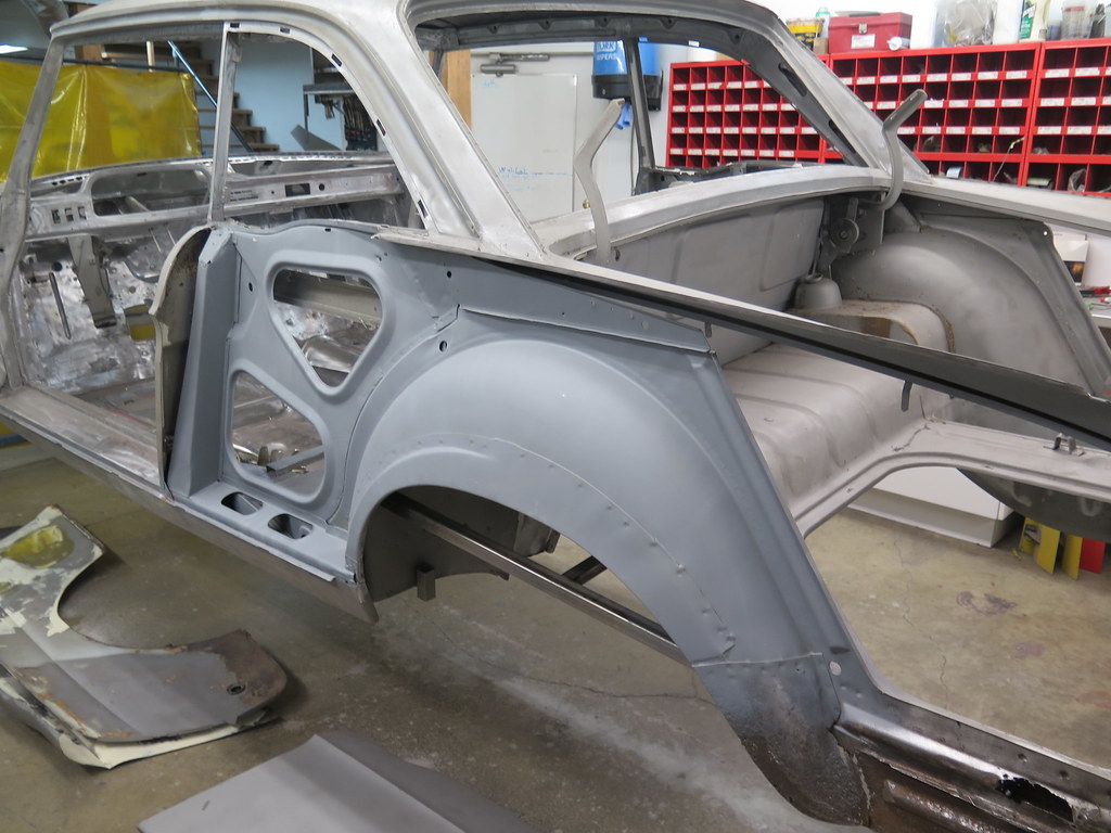

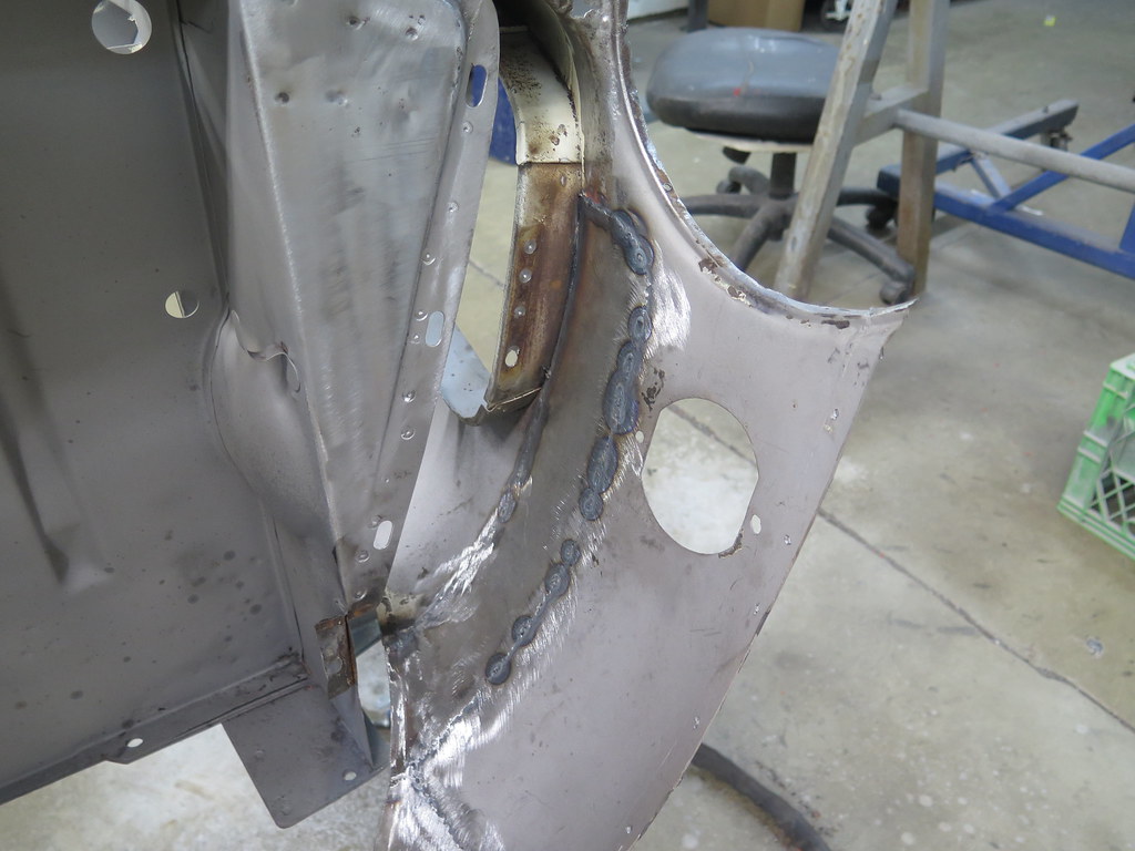

After the rear jack mounts and inner wing areas had been tidied up, the right rear NOS wing was welded on. Left rear still to be done. February 2017.Image
A week later the other was done, again after all the innner metalwork had been redone, including the installation of two new jack mounts.Image

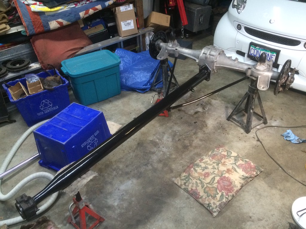

Repainting and replacing seals and vegetable oil on the worm driven torque tube rear axle....Image

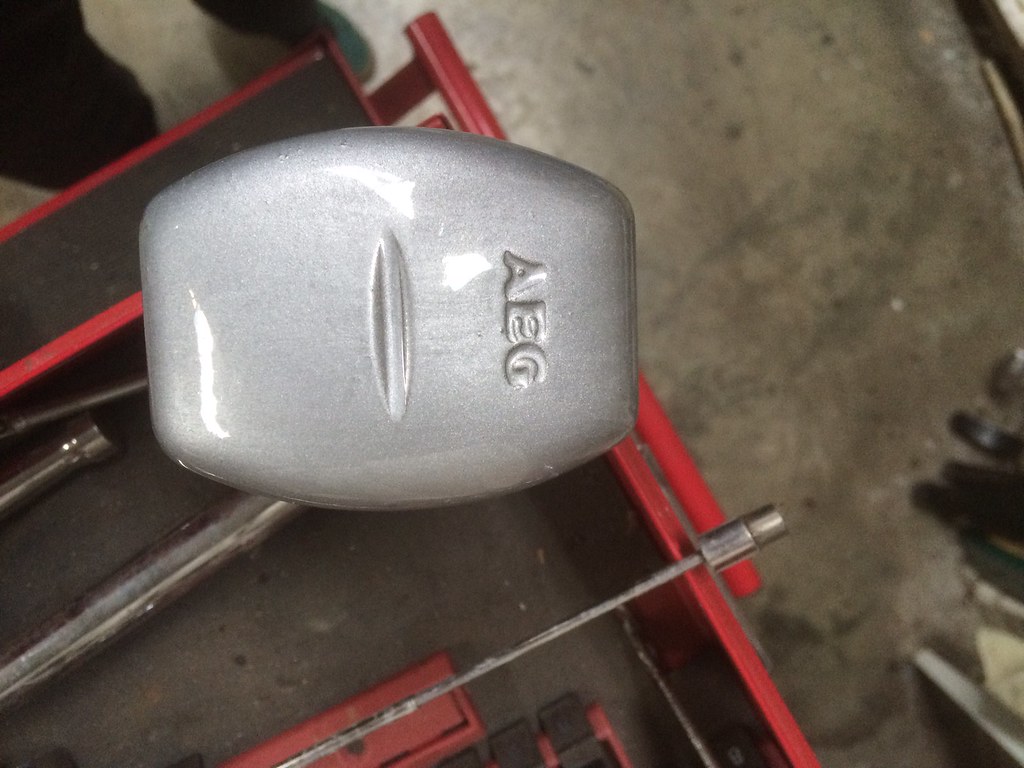

AEG electric fuel lift pump cover painted in POR-15

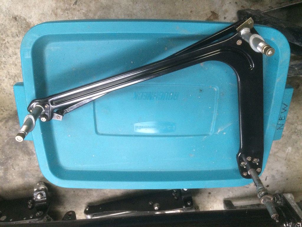

Rebuilt wiper mechanism with new spindles (different part from the ubiquitous saloon!)

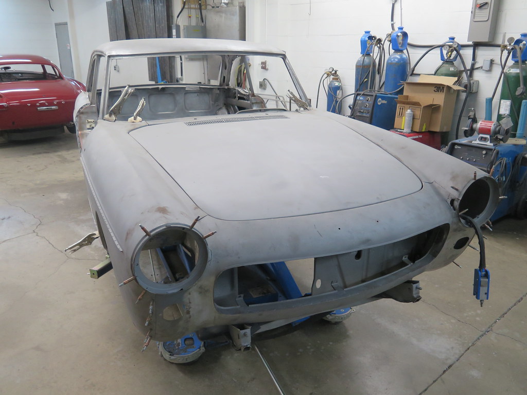

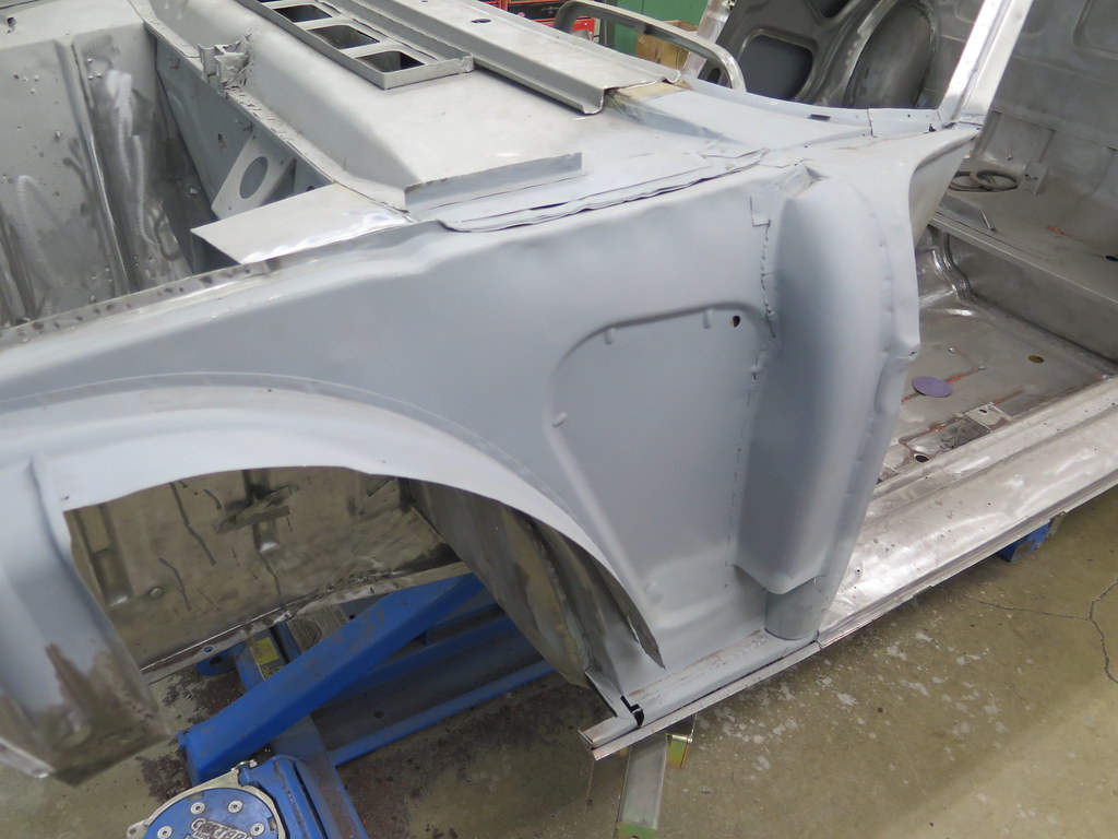

With the rear of the car and the floors and sills done, the serious work on the front end began:Image

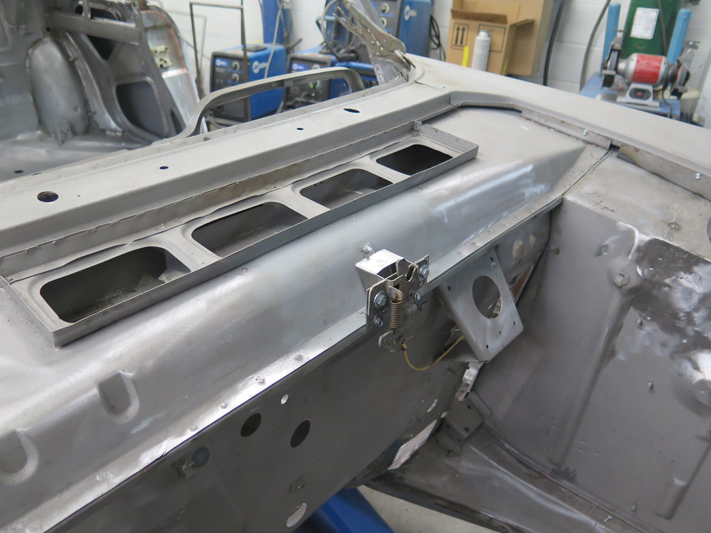

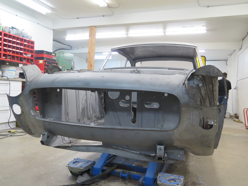

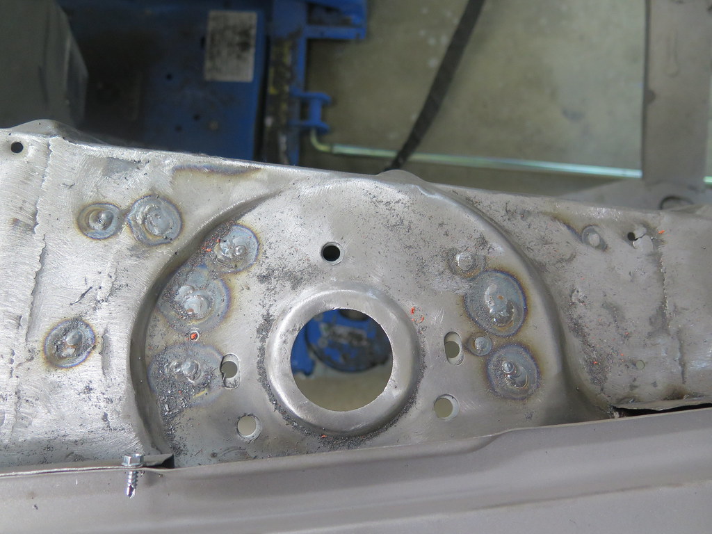

More metalwork underway:

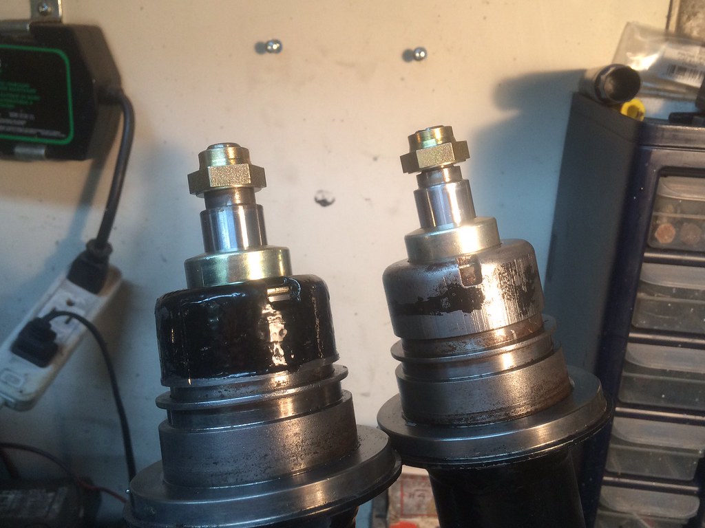

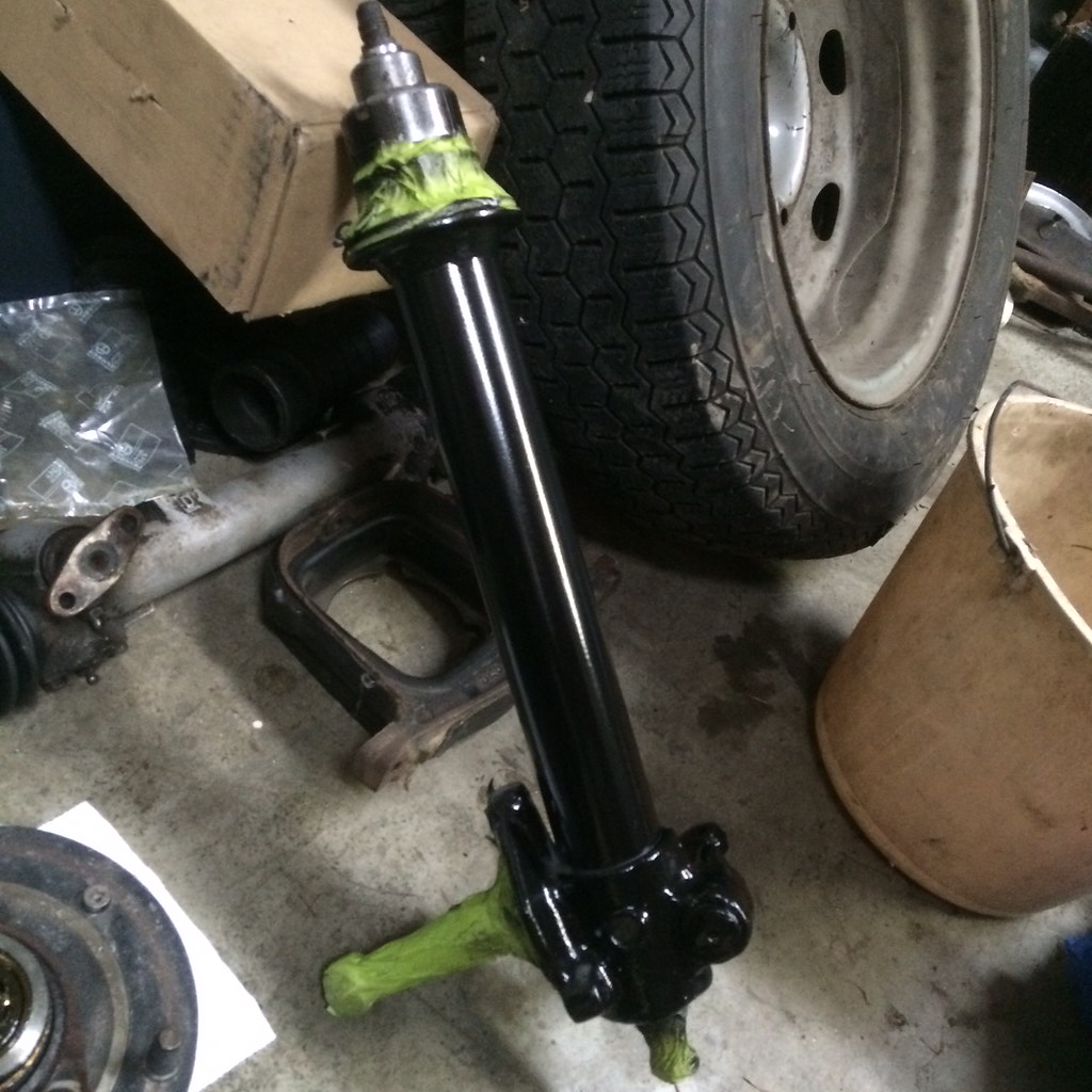

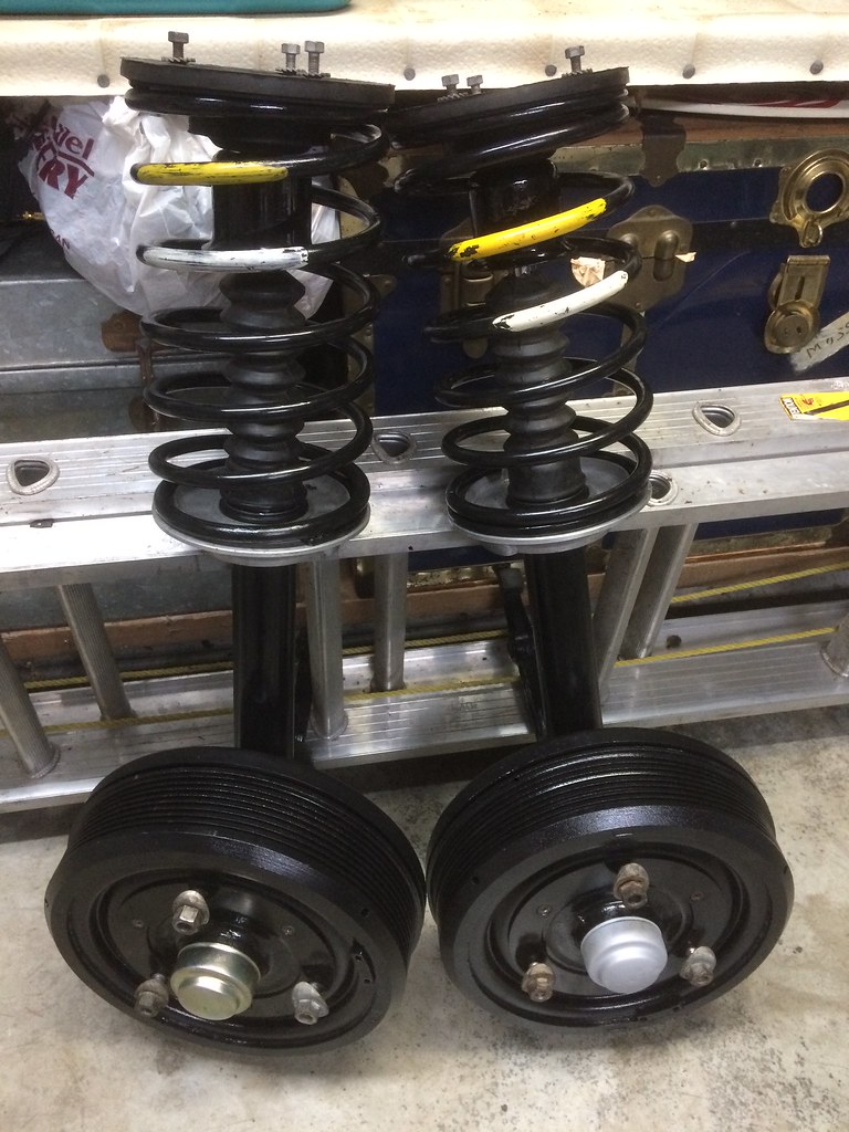

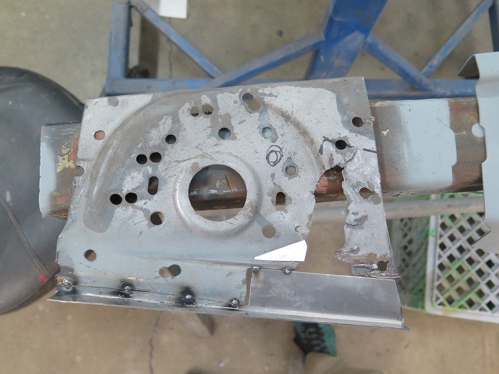

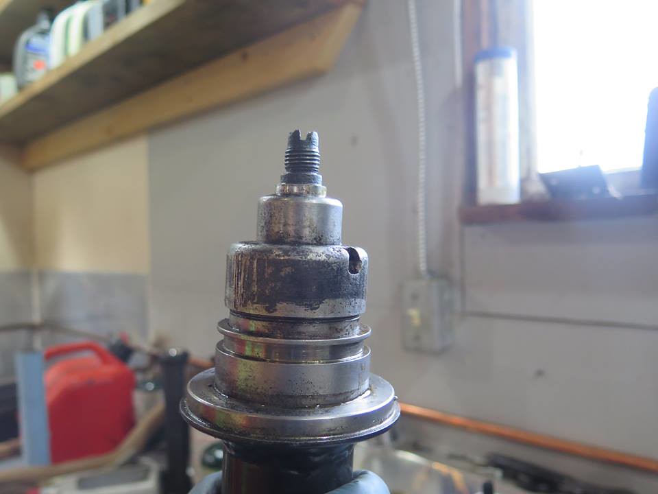

Cut off one of the McPherson strut damper nuts as it was seized:

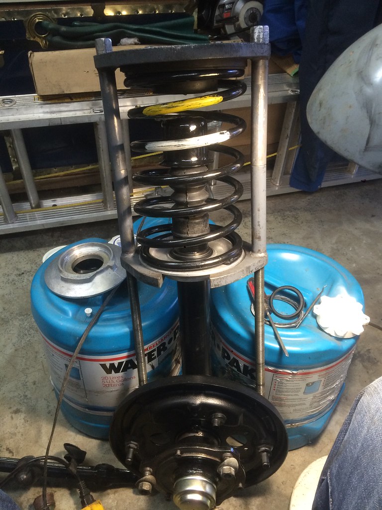

Rebuilt the dampers with NOS units by Peugeot (the aftermarket cartridges are all rubbish: Koni and Boge at least, both of which I tried in other 404s)

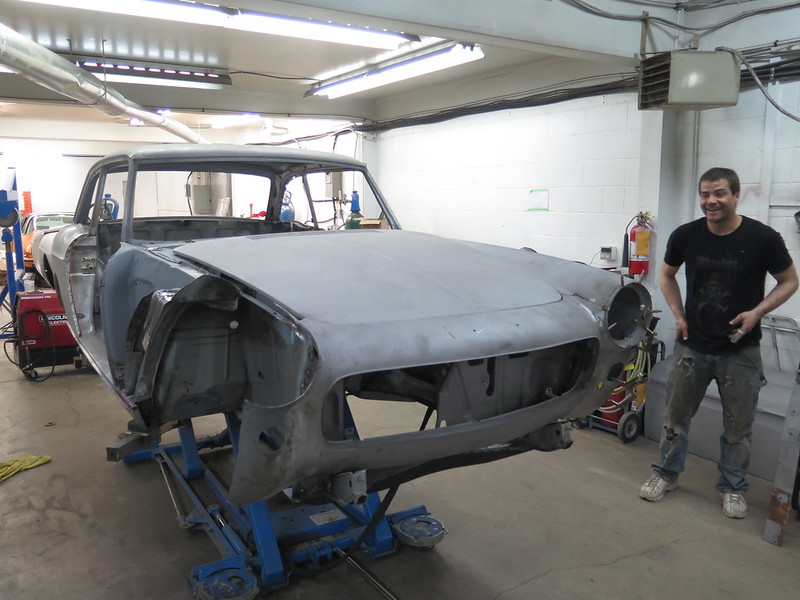

That's Mike grams, the owner of Coachwerks, waling on the left of the car.
This fellow, Patrick Higgins, did the metalwork on the car. Here is is describing taking the front crossmember off and shaking it like a Maraca, so much crusty rust was inside. A new one replaced it, of course.

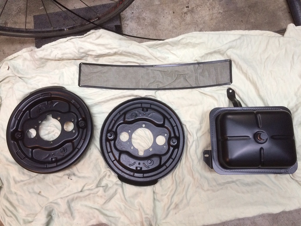

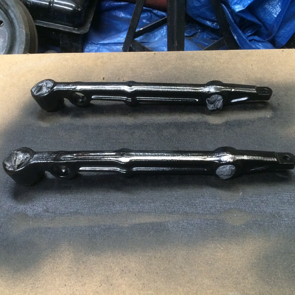

Coachwerks also painted a few mechanical parts for me. Front brake backing plates, vacuum tank, fresh air intake grille.

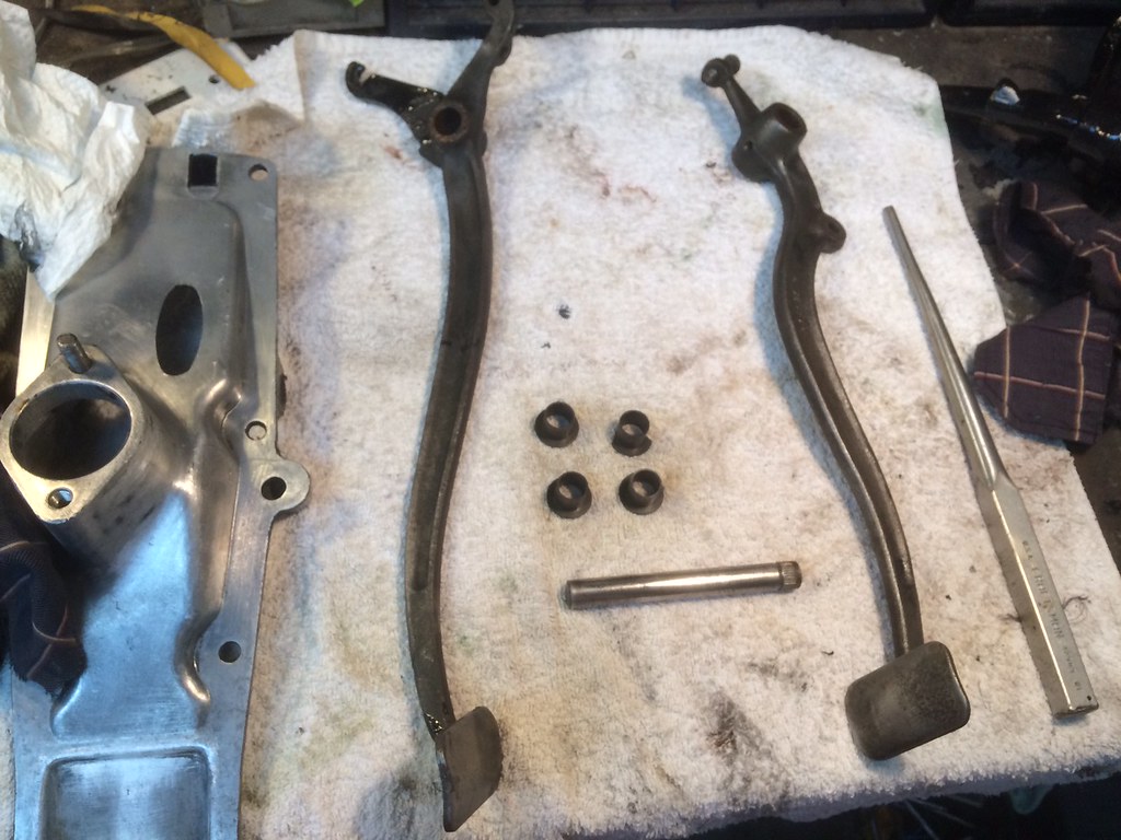

Rebuilt pedals and cleaned rust off pivot shaft

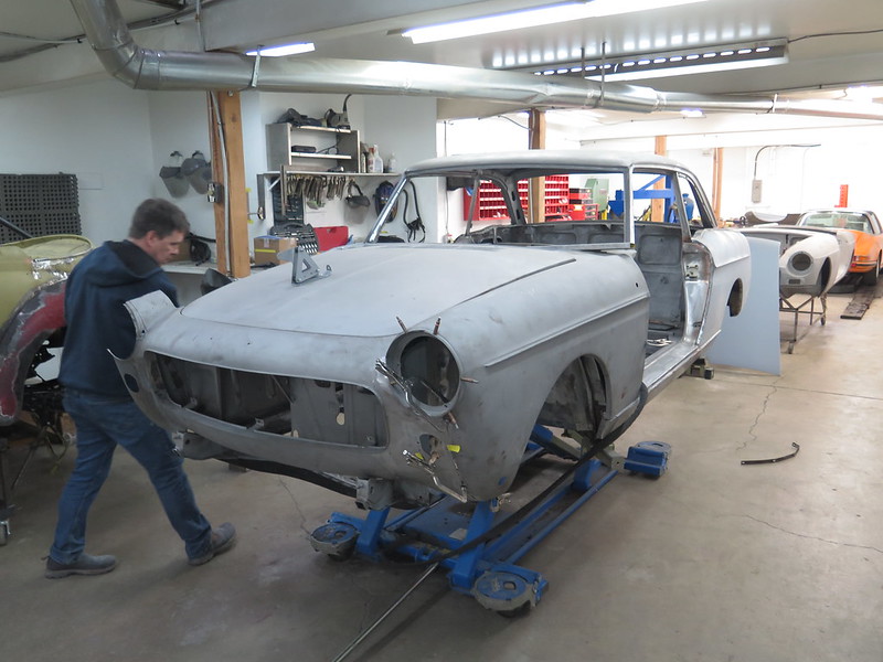

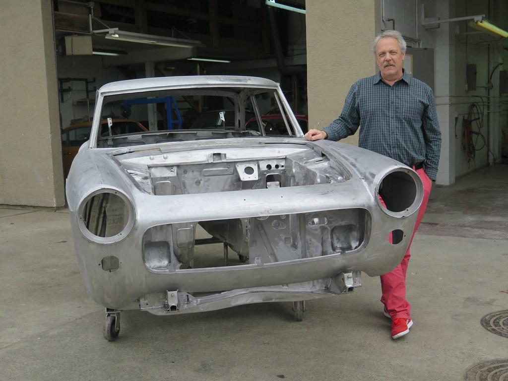

Body in white, so to speak, with me next to it.

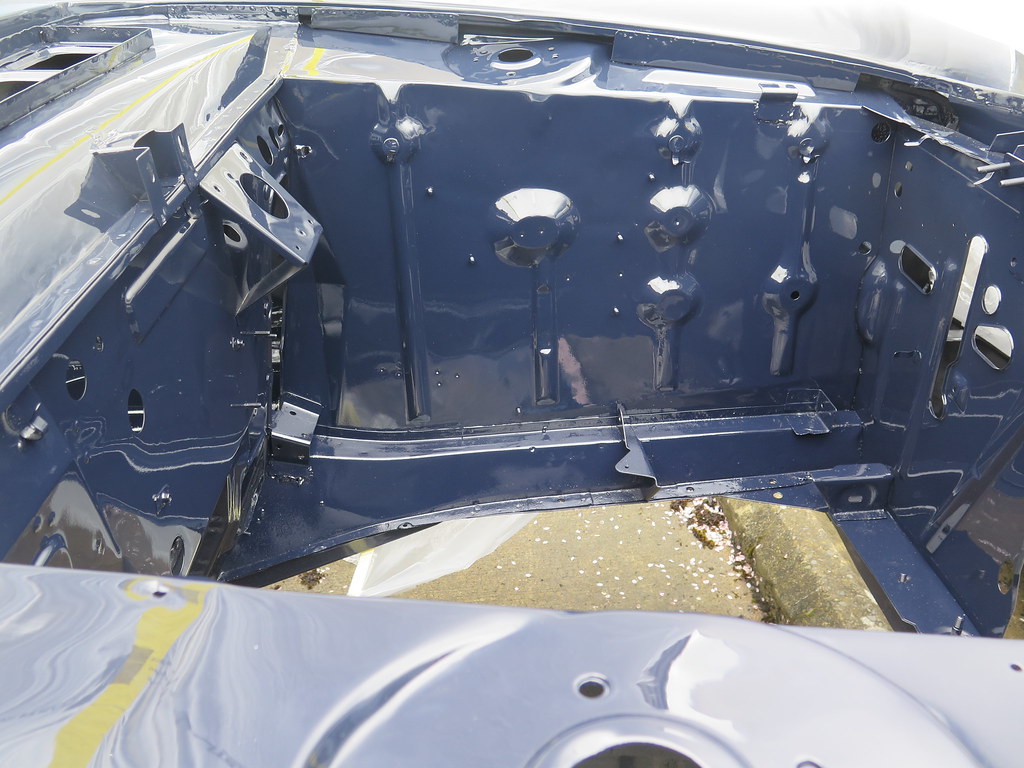

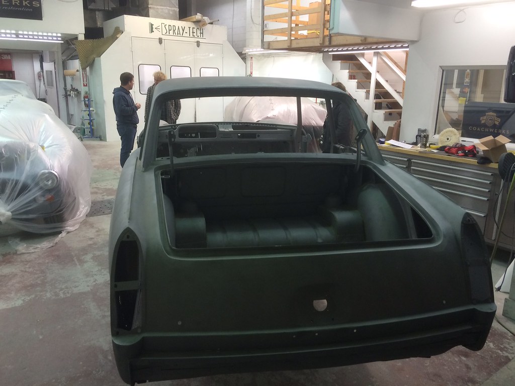

First colour coat: engine compartment

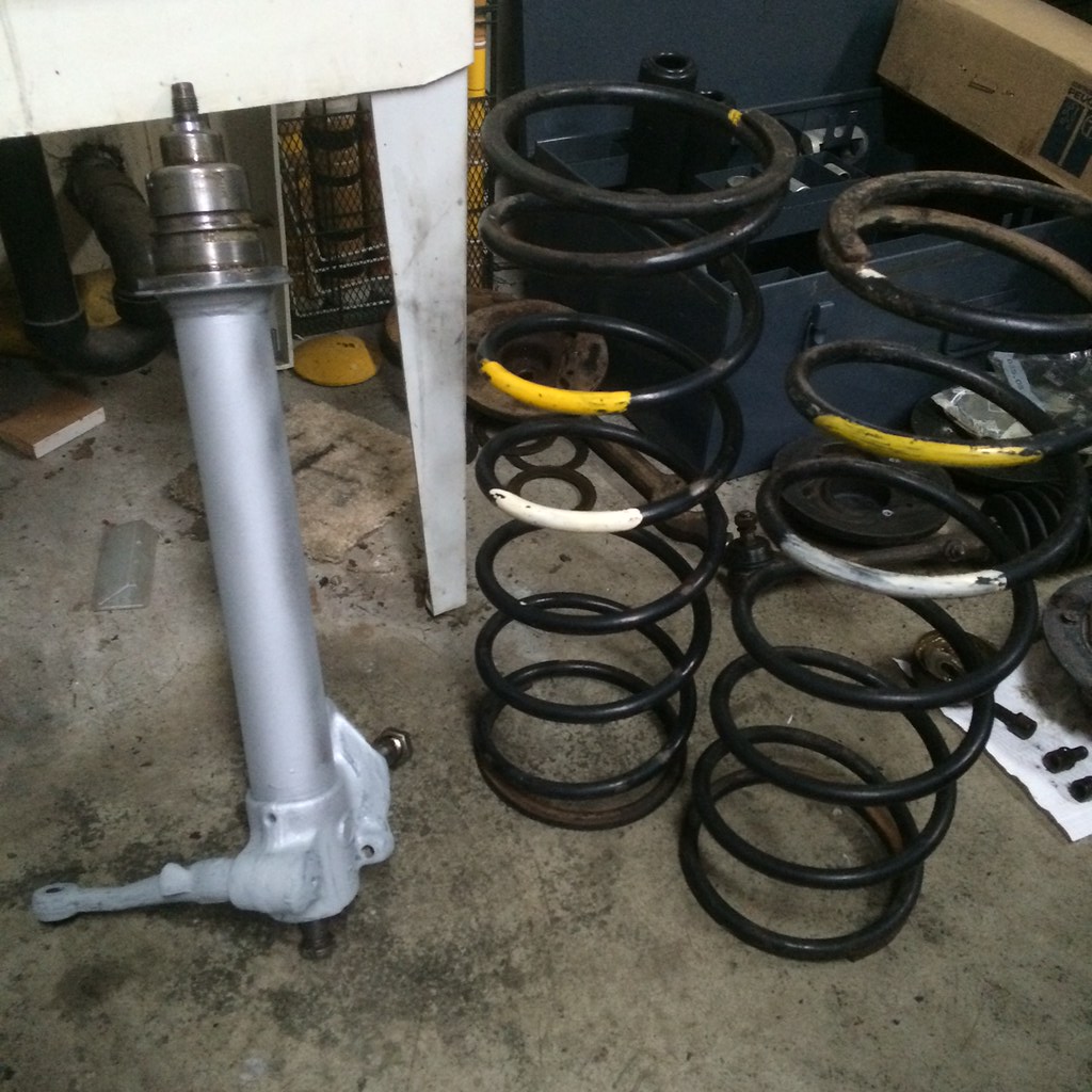

Strut reassembly:

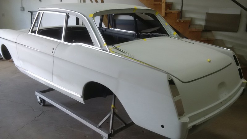

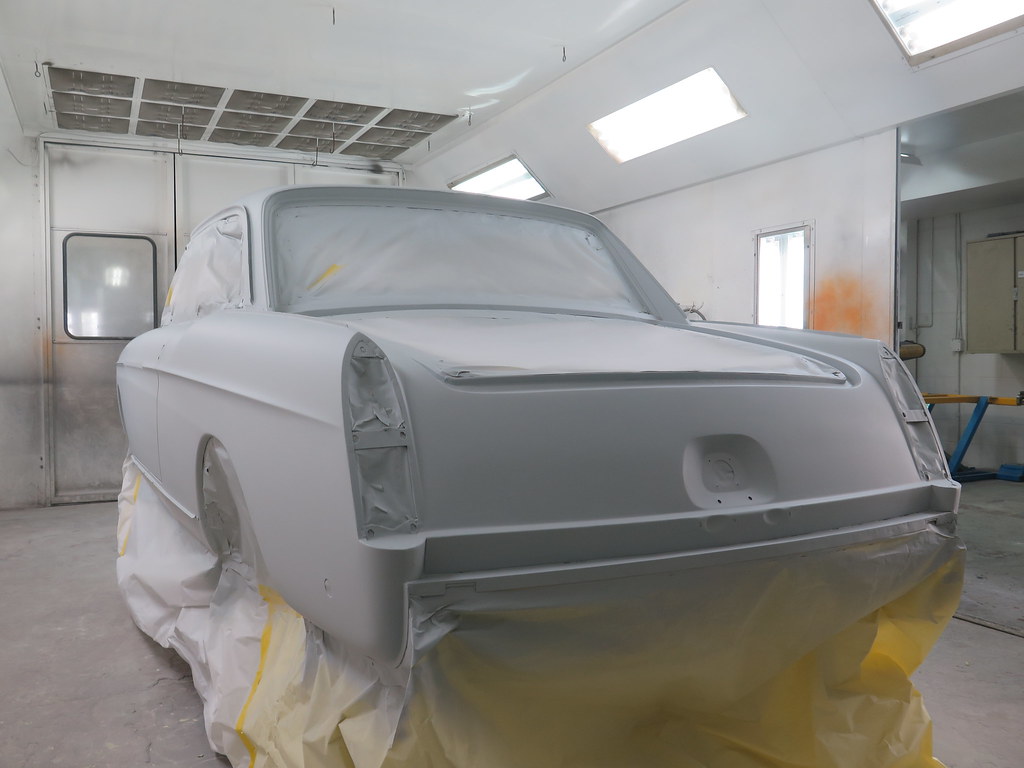

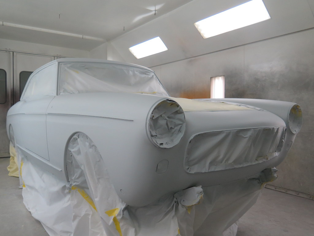

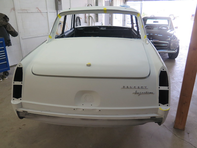

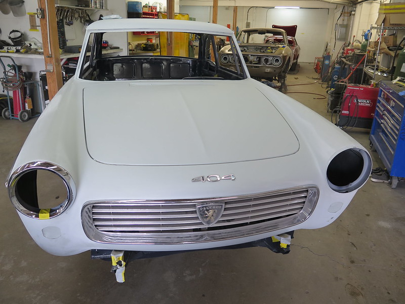

Primed and final blocking underway, May 2017:
Checking trim fits:

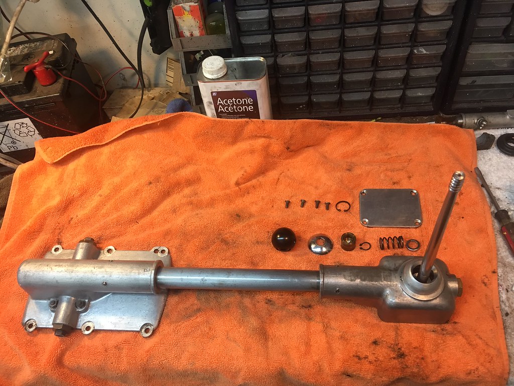

In the second post in this thread I mentioned that the car was from Kalsbeek Motors in Bramalea. Well, one of the Kalsbeek family members, Harry, had a set of exact replica dealer stickers made up and gave several to me! He also had some door jamb stickers made up too. Very lovely gift.

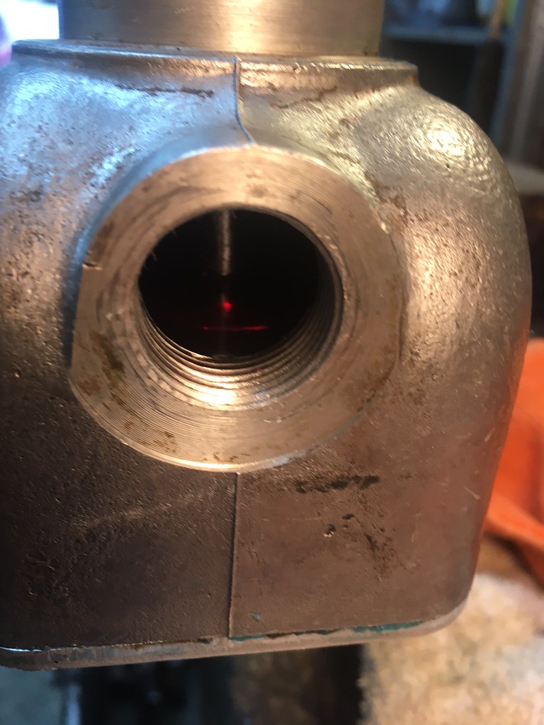

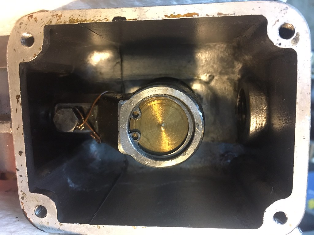

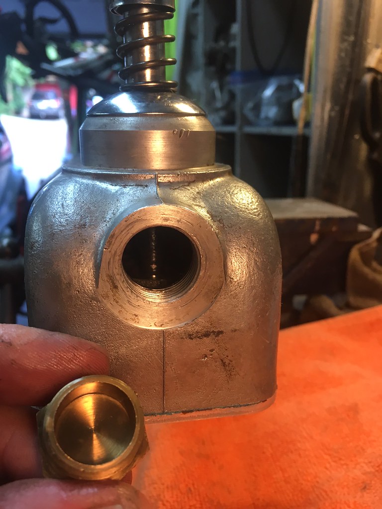

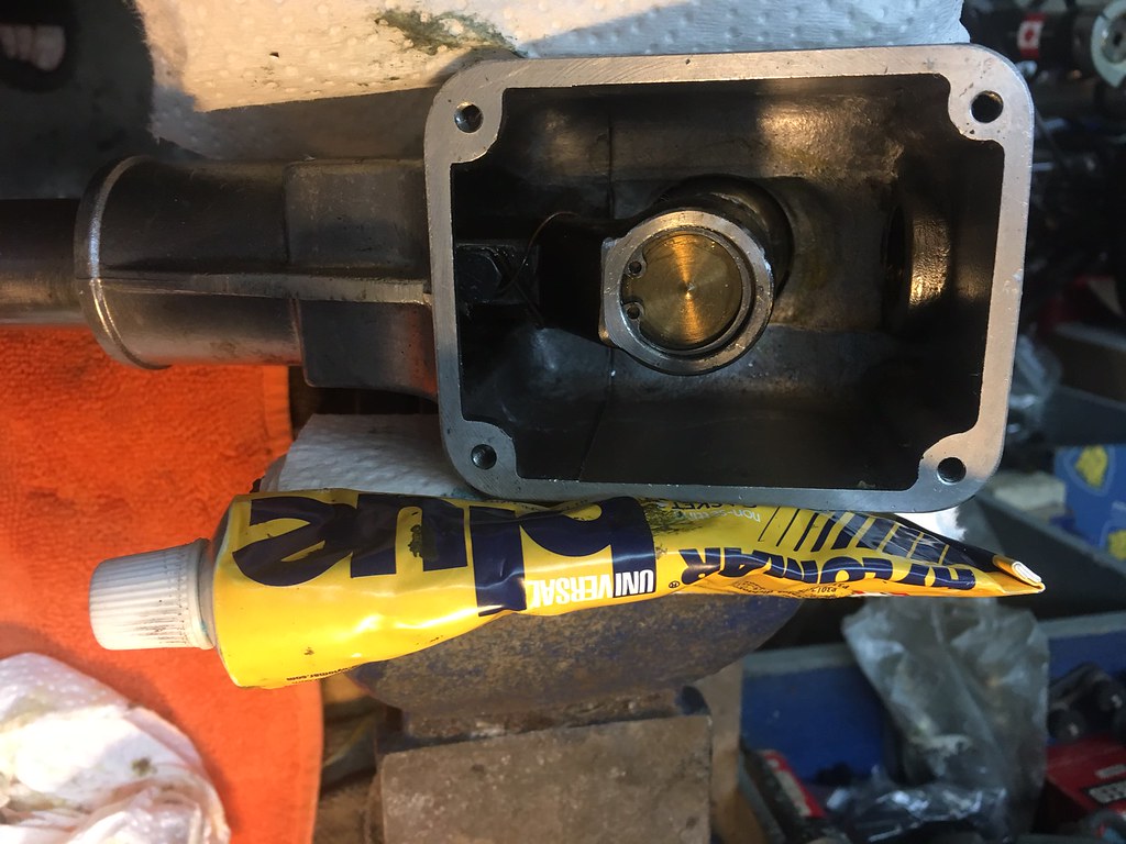

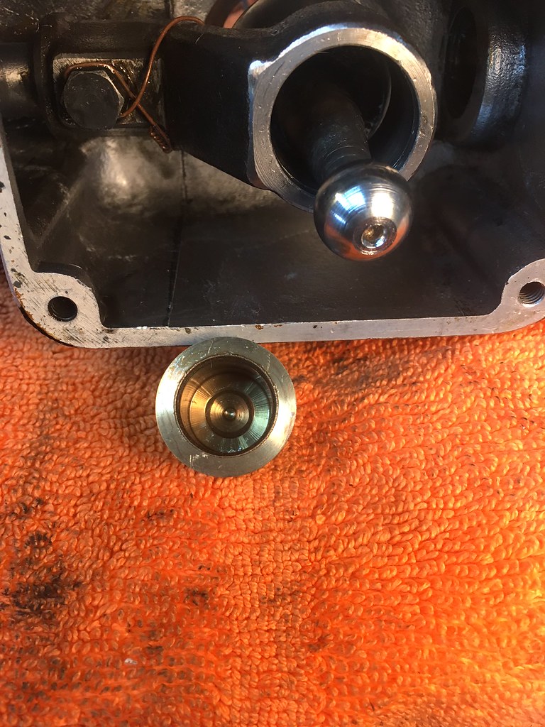

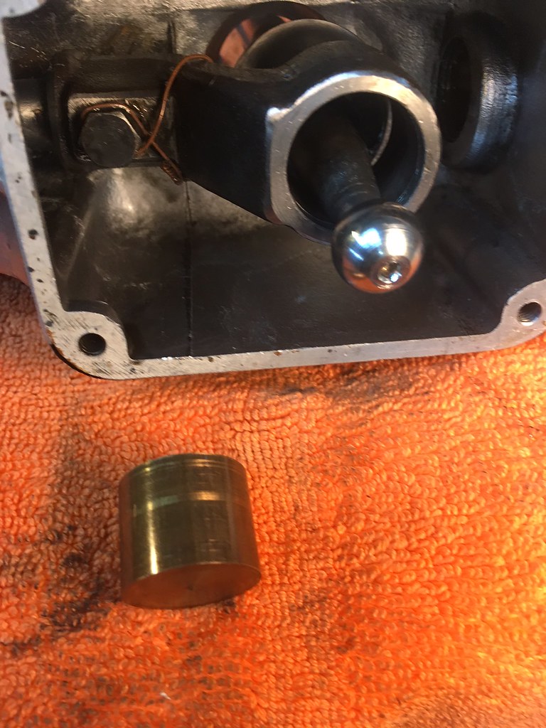

Cleaning and checking the Nardi shifter. Notably, it has a tiny sump under the shift lever, to lubricate the mechanism.
Removing 2 Circlips and you can see more....
Bronze shifter bushing....
Closeup of the bushing:

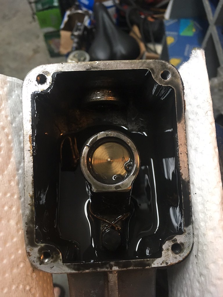

Reassembly begins.
Closed up with Hylomar Blue.
Mini-sump plug (for refills).
...et le plein avec Yacco huile de ricin ( pourquoi pas ? ). Fini !
