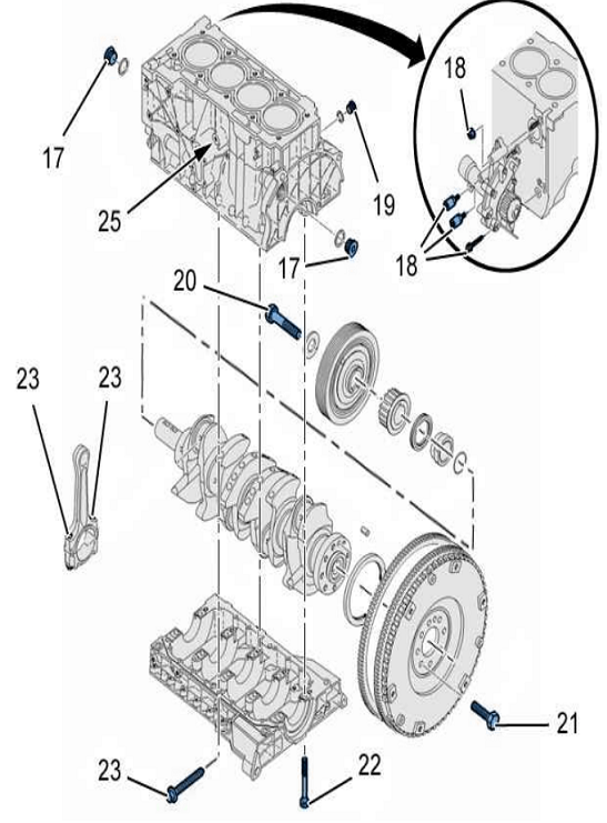

I had the same info as your original post Marc, 21 is not a crank bearing cap bolt....

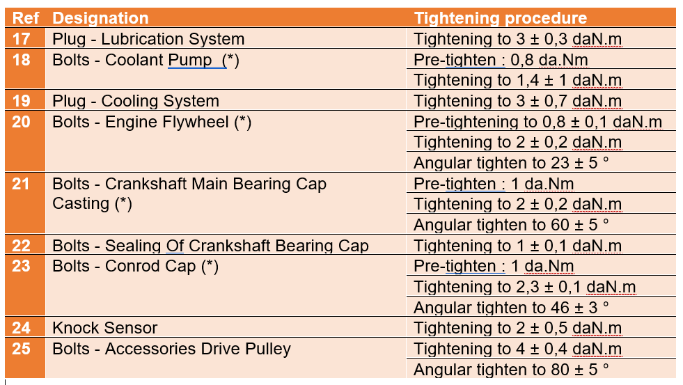

Here's the data for the diagram:
Click Diagram to Zoom
- Posts: 12575
- x 1485
Re: ew10j4s torque settings
Think they must have numbered the drawing on Friday afternoon after a good long lunch! There are 2 item 23s for instance, and 25 is pointing at the block! From the table you have posted, 20 would appear to be the spec for the flywheel bolts. But that is still different to the original info you found, and which was the same as I found in my off line version of service.citroen!
Yes, looks a bit of a dog's breakfast, and of course we have to make sure the 'tracer' lines are followed where they have exploded the parts for the purposes of seeing everything - as it looks back to front if not!
