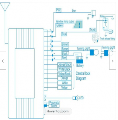

A quick search for winch remote on ebay UK found this as the cheapest.
https://www.ebay.co.uk/itm/124887050137 ... Sw8YZhNbi3
Something like this would take away the need for direct wiring. It might need a relay to match the current draw but a search might throw up a suitable relay package for say remote door locks which would have a higher current handling capacity on it's own. I saw a remote car locking set for about £14 - substitute fan for door lock solenoids, hey presto, high current remote relay.
Amazing what goes through your mind in the middle of the night.

https://www.ebay.co.uk/itm/264162671267 ... SwkXBd6MtG
Because these things have multi functions you would be able to control more than one circuit.

Dormouse an excellent idea indeed but i can find no such thing in my country SA and if there is such a thing it would be very expensive.
Ordering things from overseas is a hit or miss with our postal system
