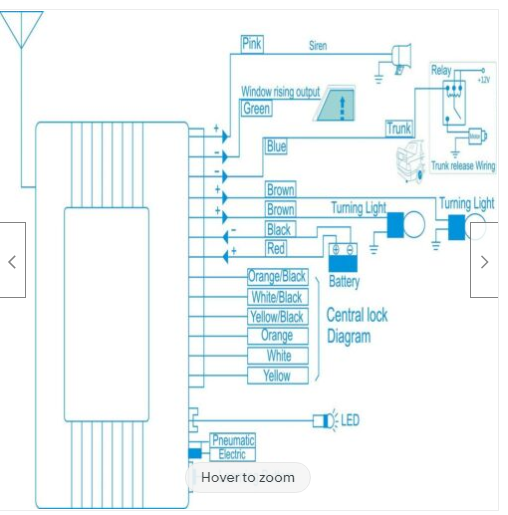

Re: How can i get wire from engine to inside car ?
https://www.ebay.co.uk/itm/264162671267 ... SwkXBd6MtG
Because these things have multi functions you would be able to control more than one circuit.
