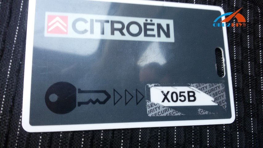

You also need your 4 digit security code found on this card.
If you dont have it you can buy it from the dealer with proof of ownership etc.
