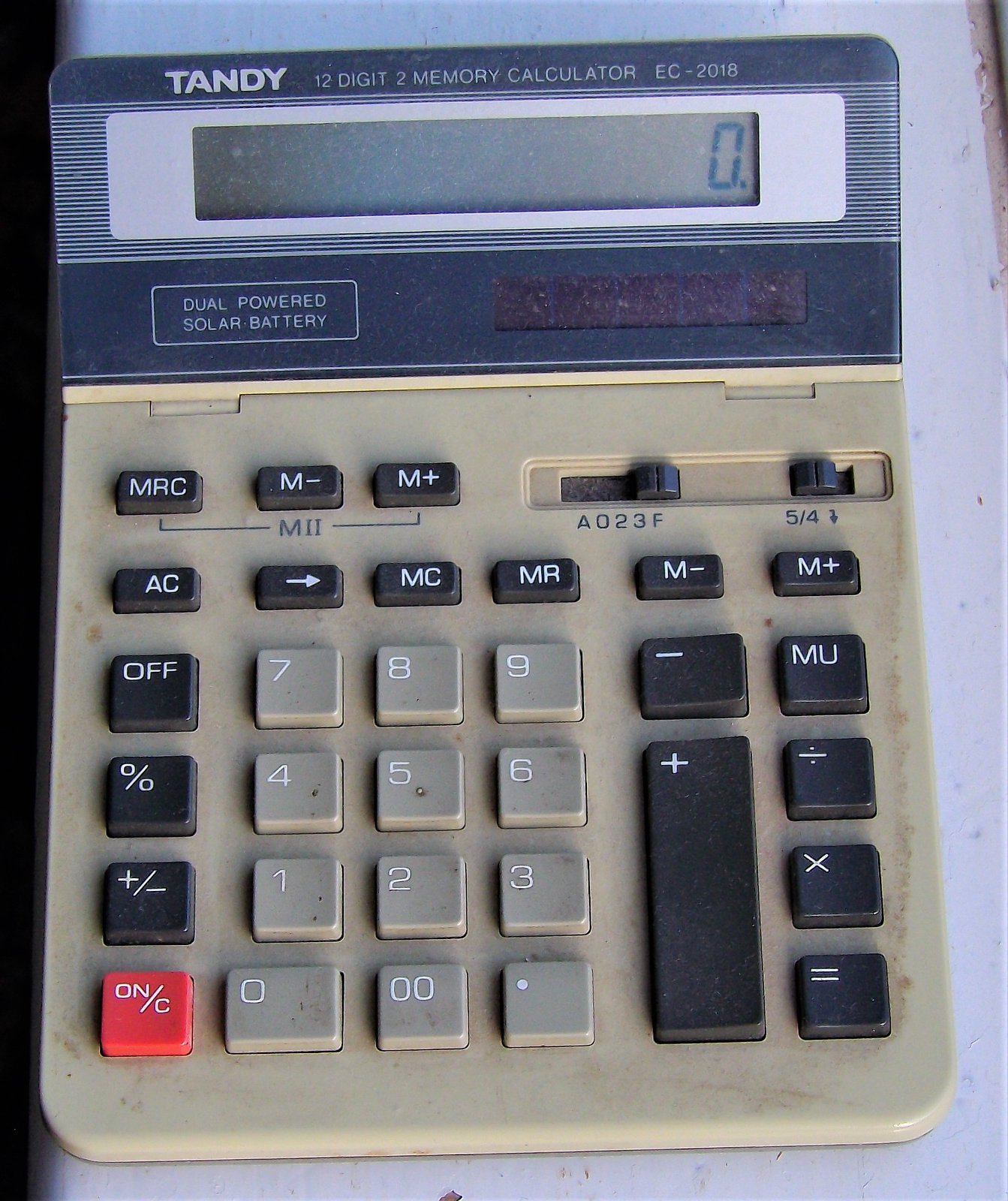

All too fancy for me.
I've got this which I must have had on the shelf above my desk for over thirty years, still works.

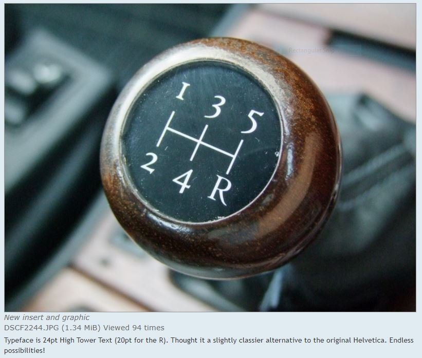

Zel,
Are you still stuck for the typeface for the speedo' drum on the BX ?
I have tried Identifont etc, but difficult to ID characters from just a very few numerals visible, so no real joy there.
FontViewer on a PC allows any text to be sampled across all the fonts on the device.
Typed in 10 20 30 ....80 into Word, and flicked through the hundreds I have here. You need a very Condensed font; ones that caught my eye were:
Asimov

My guess is that the typeface for the drum was purpose-designed, and not a stock font. May be wrong.
Could you lift off the film, scan it, and just tidy those numerals up? The other things on the drum look pretty standard faces.
Bet you've sorted this by now...!
Sometimes, a 'facelift' scores over originality. This something I did for our XM a long time ago...

Cheers Chris, I'll have a look at those. As you say though I guess it may well be custom designed.
