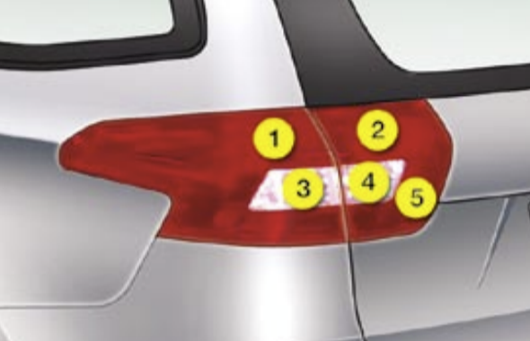

Sorry but I'm totally confused now - you seemed to indicate it wasn't the top brake light before and that it was the fog lights - so I mentioned about the fog lights not being powered unless the headlamps are on (probably need the engine running too). But now you're saying the middle stop light isn't working again.
1. Stop-lamps and sidelamps: P21 W/5 W (Vehicle Wing)
2. Sidelamps: R 5 W (Tailgate)
3. Reversing lamp: H21 W (Vehicle Wing)
4. Foglamps: H21 W (Tailgate)
5. Direction indicators: P21 W (Tailgate)
