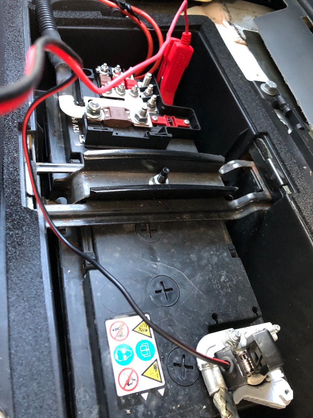

Hi all -
I have a 2017 relay I've just purchased, but didn't drive for 3 and a half weeks due to insurance being sorted and going away on holiday. When I returned the battery was dead. I can open the drivers door only as it seems (and I've confirmed from reading online) that even the mechanical locks for passenger and rear doors require central locking to be working. I can't open the bonnet as the pull is on in the inside of the passenger dash, and blocked by the passenger door, which is a design flaw from reversing the left hand drive models and failing to relocate the bonnet pull. So from what I've read the tactic is to attach a trickle charger to the battery under cab floor (jumpers can damage electronics) and then once central locking works, open the bonnet pull and then charge normally via charging points under bonnet. However my trickle charger is showing an error and was hoping someone could help point out why. I could disconnect battery but I'm concerned about screwing up some electrics, and I'm still waiting for my codes from Citroen. Thanks

Possible that your (presumably intelligent) charger doesn't like looking at a flat battery, and is diagnosing it as defective, which is a nuisance. Is it possible that you could hook up an un-intelligent (old school) one, to the same accessible charging point?
Another possibility might be using a cigar-lighter socket as a feed-in, but only if the socket was one of the "always live" variety, and not via IGN sw. Maybe switching on the IGN would allow it to be used as a charge point, notwithstanding?

Absolutely nothing.Gibbo2286 wrote: 19 Sep 2021, 17:29 Excuse me being out of date/touch but what's to stop a simple jump start?
Sometimes you have to jump it straight from the battery as you dont get a good enough connection on the under bonnet jump points.

Cheers - I've just read cautions on doing this as it can screw up other electrical components, and that a trickle charge is always recommended instead, with a jump being a last resort. However I'm not entirely sure what constitutes a jump start; I always assumes it was the rolling push start, but others seem to think it's jump cables from another vehicle. I'm going to rule out the rolling start if I can as my street (busy road) and the size of my van might make that a little dicey. I can jump it from my main vehicle as a last resort; does anyone know if it'd be safer to take the connectors off the existing van and connect to van battery and charge for a bit or is it better to leave them on and just charge enough to get van running? Thanks

It doesn't have to be from another vehicle. If you have a fully charged spare battery that could be used. Also some of the higher spec mains supplied battery chargers have a "Fast charge and Start" option. There are also dedicated battery start boxes which contain a small battery and some clever electronics which can supply a starting boost.

Simply connecting a booster battery on the van should energise the central locking enough to open. It might not actually start the van but at least you could reach the bonnet catch handle. Charge the battery, then we can sort you from there.

ps. With a 12v battery attached to your van battery a charger that won't kick in for the main battery alone will kick in when it sees the raised voltage with two connected. After about 15 mins you should be able to just charge the main battery as it's voltage should have risen with the piggy back charging.
